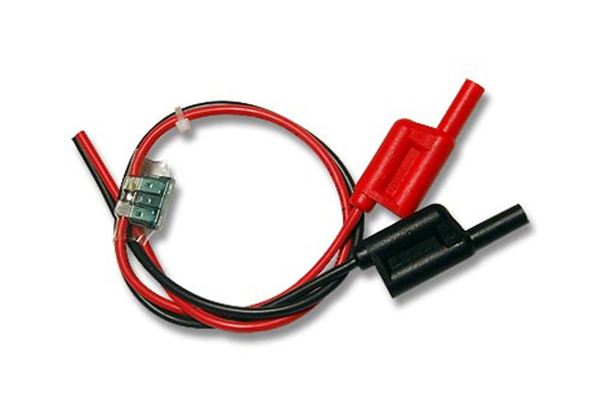

What will I need to make the ends on this cable charge a single LifePo4 when they finally arrive.

you can use alligator clips if you want to just clip it on and charge or even the same 1/4 inch connectors you use on the wires and then screw them down on each cell - takes longer to unscrew etc, but its more secure at least wont move or disconnect
i have used alligator clips just to make it faster to change cells - but if using just 8 Cells - to screw them down isnt too bad and they may charge for longer times so its a good idea to be secure
i had alot of 15ah cells to charge so i used the clips to make it easier and faster -
Re: PINNED - ADD ON PACK Step By Step 30ah Pack build / pict
Postby Burgerman » 02 May 2018, 21:06
Or ring terminals.
