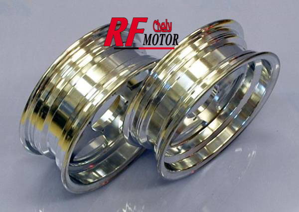

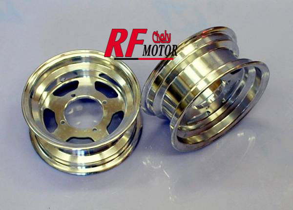

Postby shirley_hkg » 25 Mar 2018, 05:55
ILLUSION 3, 3.50-8 tyre on Shirley's 2.75'' tubeless rim .
Postby Burgerman » 25 Mar 2018, 08:43
3.50 TYRE ON 2.75 Rim is ok. 3.00 inch tyre not really OK on a 2.75 rim. So 2.50 better.
But neither will fit a 3.5 rim properly. It tries to stretch the tyre. It wont look as bad as those pictures but that was to illustrate the extremes. If you are going to use 3.5 rims you may as well fit the 120 tyre as its a little smaller diameter and the correct size for the rim.

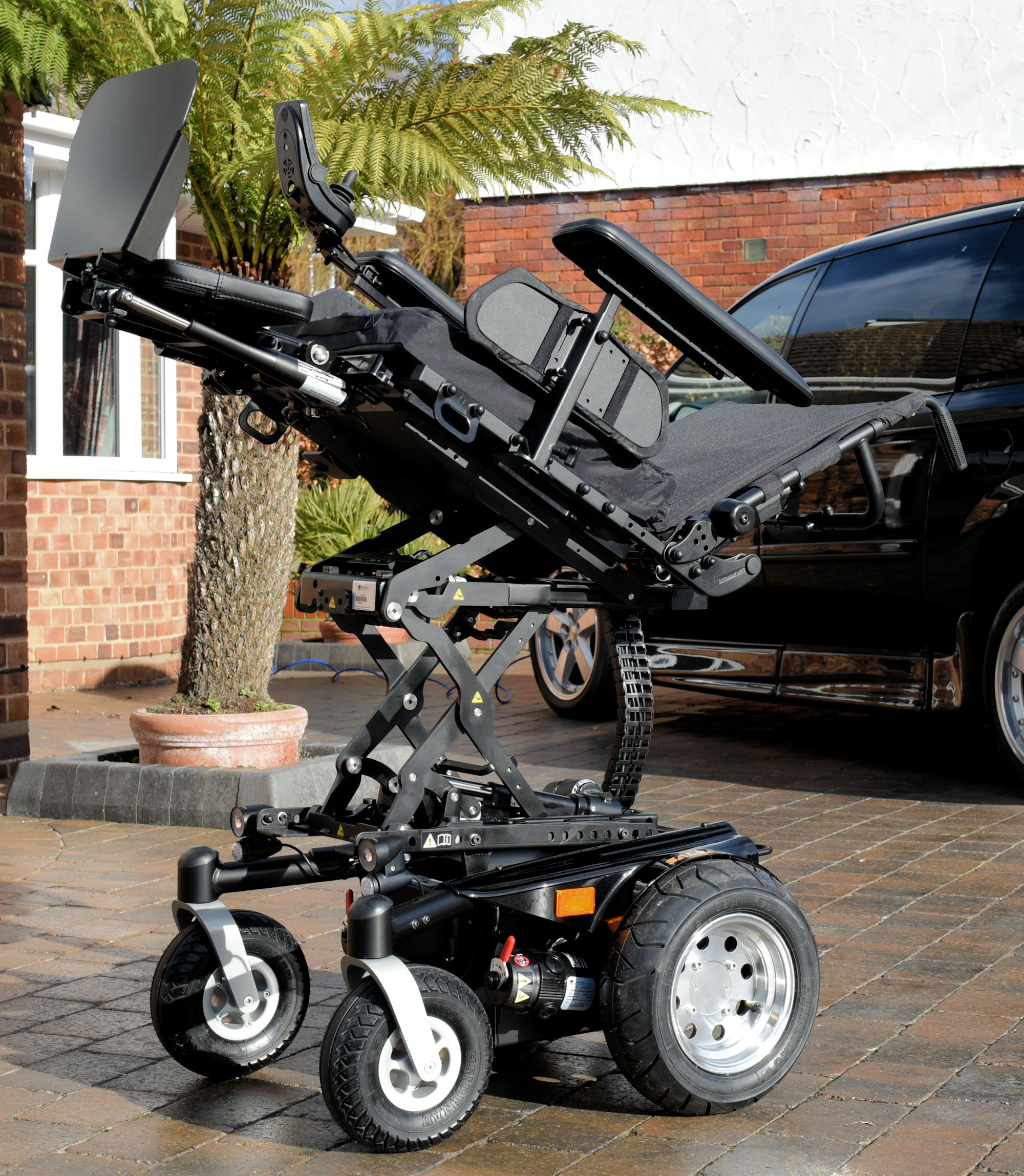

Burgerman wrote:The reson its there is because if you tilt, esp when high up, or on anything but level ground the chair may tip over backwards as you move forwards. Made worse by moving the seat back. So recline, and tilt can be dangerous! Especially if seat is raised. But its common sense to me so I use my brain.
I had a brainwave. To get the optimum seat position for myself (lightweight) in the chair. I going to clamp it progressively further back until I find the maximum rearward positing that avoid both footplate and castors clashing, and chair tipping backwards at max elevate/tilt on level ground. Then re-drill and fix.
goodpost
Postby Burgerman » 25 Mar 2018, 10:02
Yes, thats what I did, over a bed since it feels high and may tip. With recline as well as tilt its a close thing. Esp if high... So I dont recline if high. And until you get a headrest fitted you cant really!
300mm or 12 inch lift doesent sound much. But it certainly feels like about 3x this! Its not something I use much though. Its too slow to rise/fall, lifes too short. But can be useful at times to reach stuff.

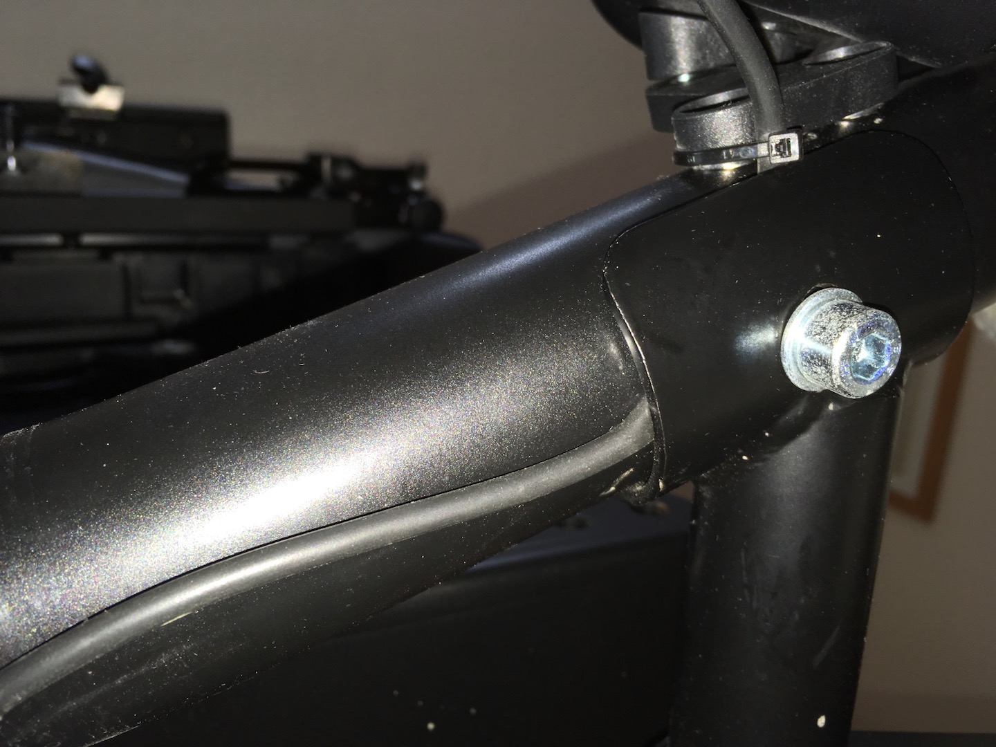

See this, it's the front right lighting cable. Would that have occurred when chair was assembled at factory, or do they arrive at the dealer in basic kit form and dealer bolts the major bits together? I.E. like flat pack furniture?
Postby Burgerman » 25 Mar 2018, 13:36
That looks like some numpty has done it wrong.
I moved my light inboard. Why? Because every bit of furniture or bed, or whatever you get close to to work on something smashes the lights.
Mine are moved in, but still shine past the outside of my legs fine.
See:
download/file.php?id=7719&mode=view
And
download/file.php?id=7717&mode=view
The bolts are now replaced with black, and have black plastic caps too.

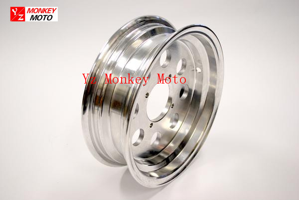

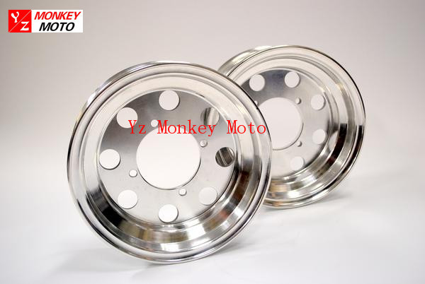

Postby shirley_hkg » 26 Mar 2018, 09:59
drunk2 Same price now ! :dance
Postby Burgerman » 26 Mar 2018, 10:07
No tubeless bead!
Posts: 70440
Postby Scooterman » 26 Mar 2018, 10:08
shirley_hkg wrote: drunk2 Same price now ! :dance
I forgot how much sorry :oops: They’re both 2.75” and same price and I get to choose?
Postby Scooterman » 26 Mar 2018, 10:10
Burgerman wrote:No tubeless bead!
Oh, but I could put on 3.50 x 8 tubed, yes?
PS. Can you stick a tube in a tubeless?
Postby shirley_hkg » 26 Mar 2018, 10:28
Scooterman wrote:PS. Can you stick a tube in a tubeless?
YES , you can , but you need not .
At close look , I think they have , don't they ?
cheers drunk2 cheers
Postby Burgerman » 26 Mar 2018, 10:49
Yes you can see it in bigger images.

1) front light wire that was trapped is as flat as a pancake. In fact I'm not particularly impressed by the routing of some of the other wires around the tilt/elevate mechanism. You can see signs of pinching on some wire. I've got to make some better brackets for front lights.
