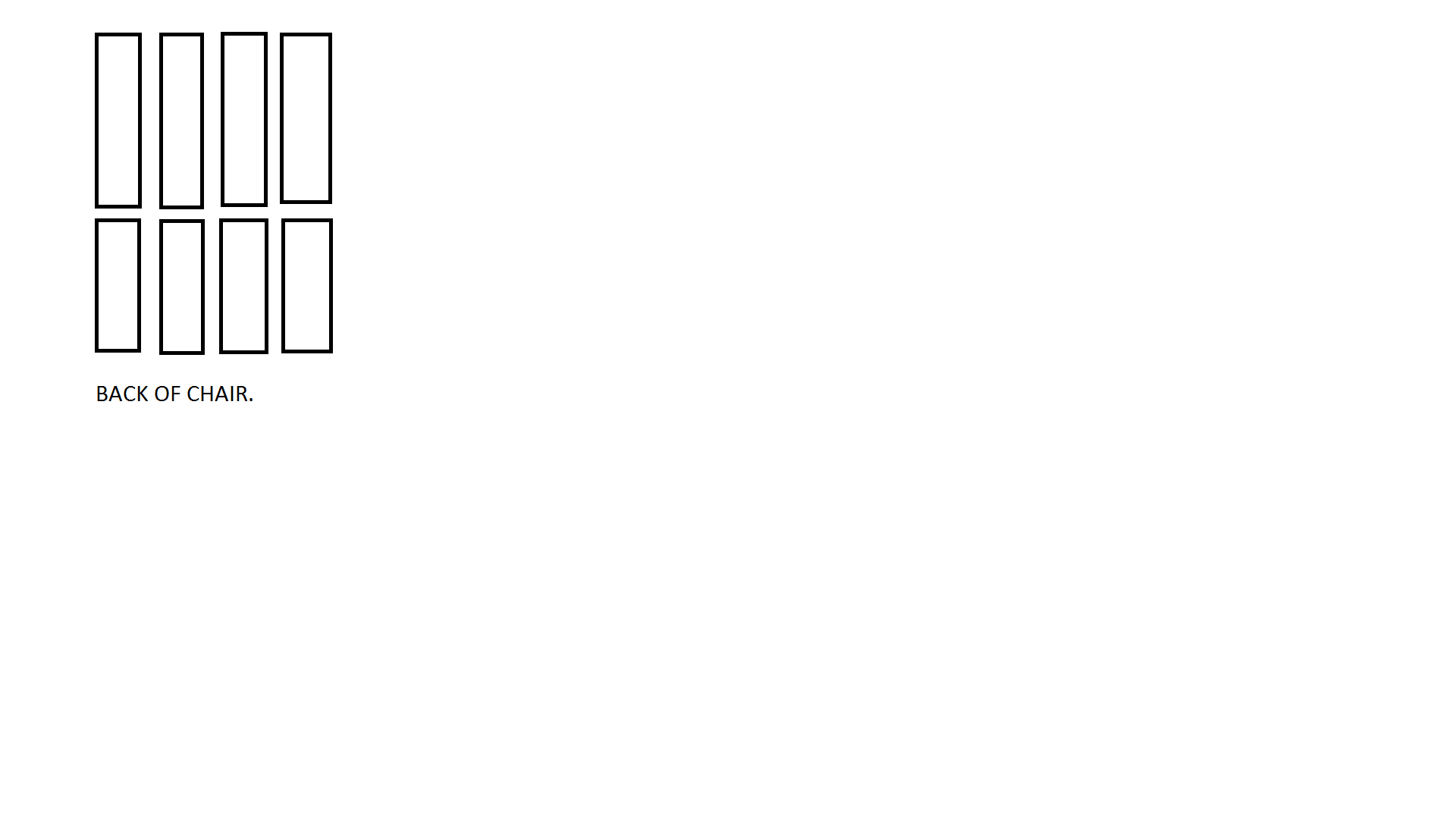

Mine has got to go like the picture I posted.
4 at the front and 4 behind. Thin side facing the front.

terry2 wrote:Thanks.
Do you think they'll fit for you in that arrangement? Or still not enough space in your battery area?

Postby terry2 » 08 Mar 2019, 18:18
That's the only way they will fit.
I can't have them length ways at that will be over 14 inches with 2 side by side.

Postby terry2 » 08 Mar 2019, 19:21
Scooterman wrote:I'm a bit confused Terry czy
Will your cells fit or not?
If I can put them in a pack like the picture. With a bit of modding to the battery tray I should be able to.
But i don't know how to connect them together.
I hope that clarifies things :lol:

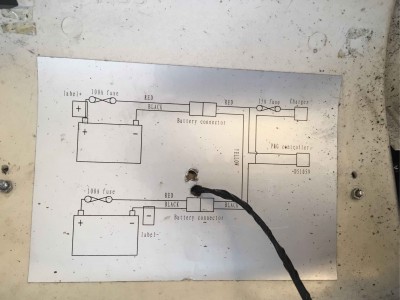

Postby Scooterman » 09 Mar 2019, 10:04
shirley_hkg wrote:Many chairs employ 2 sets of cables for the two 12V lead bracks, and wire them in series inside the PM. That makes user confused , which two terminals are 24V , and this is essential to how he put the balance leads in correct order . I gusee that's what he is looking for . drunk2 :dance
viewtopic.php?f=2&t=1813&start=3900
My scooter is wired like that
Sunrise Medical diagram on underside of battery compartment bodywork
Postby Burgerman » 09 Mar 2019, 10:07
No matter how the confusing cables look your chair runs on 2 lead bricks wired in series.
Like this. ------ is cable!
The battery is: 24v+CHAIR MODULE -------- 12v+ battery 0v- --- 12v+ battery 0v- ----------- 0V CHAIR MODULE.
Each battery has 6 cells
Each cell is 2 volts.
Two batteries together is 24v if connected in series.
Two batteries together connected in paralel is still 12V.
So while it may LOOK complicated, THIS is how every chair is actually wired up.
