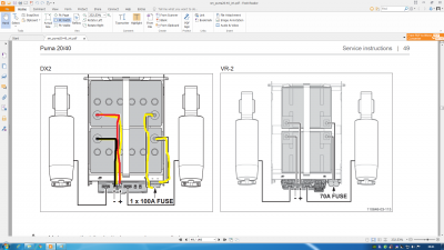

Burgerman wrote:You can re use the centre fuse, or breaker if it has one. But it will now not go in the centre, it will go in the + 24V end of the battery. Its likely easier to just throw all the olf stuff away, and fit a new fuse in your new wiring.
A 100A or 125A midi fuse (ebay) and 2 ring terminals and a bit of heatshrink is all you will need. About 2 uk pounds...

Here is my wiring. Mine is the DX2
Postby Burgerman » 10 Mar 2019, 10:30
Thats all just confusing. Chick all that away in a corner for now, and ignore it. The only bit you want to use is the 24V input connector, with its wires later on.
YOU connect your lithium 24V to the power module. You dont need to figure out how they managed to over complicate it all with 30 wires!

Postby terry2 » 10 Mar 2019, 11:37
Burgerman wrote:Thats all just confusing. Chick all that away in a corner for now, and ignore it. The only bit you want to use is the 24V input connector, with its wires later on.
So every thing in the picture that is yellow. I don't need.
Then from the modal plug I put 1 earth and 1 live both with 100amp fuses
Postby Scooterman » 10 Mar 2019, 11:39
I’ll reply just in case BM is at church.
Yes

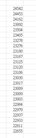

Postby shirley_hkg » 10 Mar 2019, 13:48
I have 24 cells and would like to group them into 3P8S, with the least deviation in capacity. :fencing
My score is △c=809, banghead between the two extremes
Can anyone help ? cheers

Postby Burgerman » 10 Mar 2019, 14:45
I am rubbish at maths.
But you need to add the lot up, div by 8. Then pick any 3 that add up to that number.
But it more important to group by self discharge rate.
Then by impedance.
Then by capacity.
And all 3 if you have the patience!

Postby Scooterman » 10 Mar 2019, 14:47
Would this work? :problem:
If they were sorted least to most, then group centre 3 cells, and work way out???
:thumbup: or :thumbdown:
Postby Burgerman » 10 Mar 2019, 14:49
Approximately.
Posts: 71100

Postby Burgerman » 10 Mar 2019, 23:25
Correct. Just feed the power module 24V with a fuse in the positive wire. Better to use 10 sqmm cable ideally. How thick is the wire coming out of your plug? You may be able to reuse that.

Postby terry2 » 11 Mar 2019, 08:40
I have bought the 10 sqmm wire you suggested.
I don't know how thick the wire coming from the plug is.
It is tucked away out of sight. And I won't know till I get both batteries out so I can see what's what.
The Puma 40 battery bay is very hard to get to. One is supposed to use a lift\jack when changing batteries.
A friend is going to use wood to raise the back wheels.
Then I hope we can sort out the new wiring.
