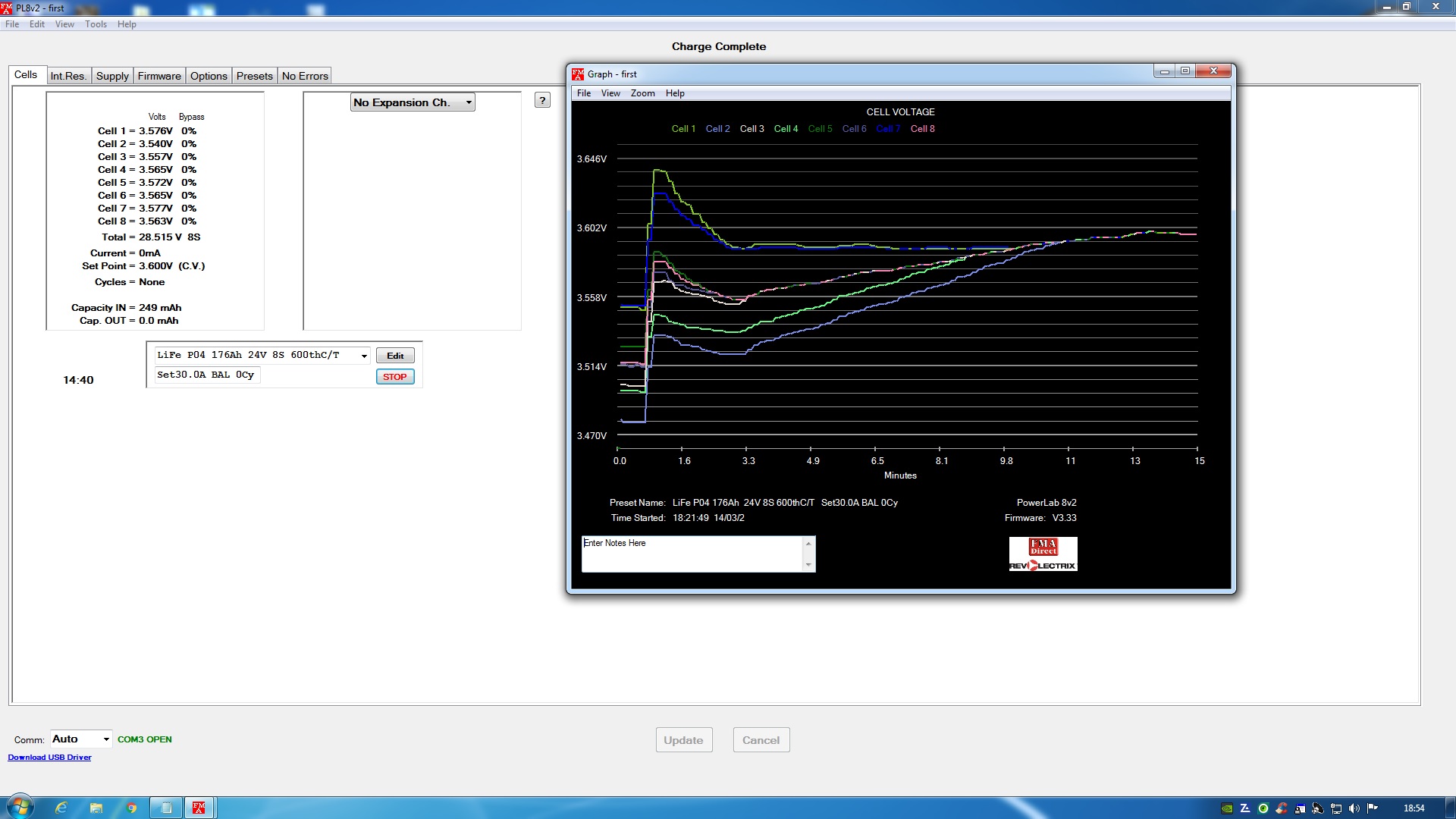

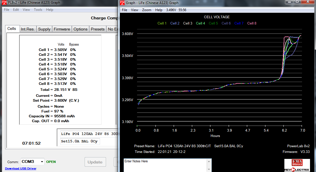

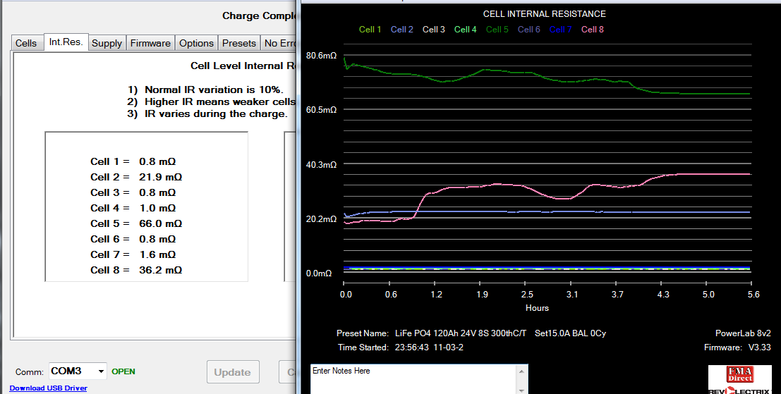

Postby Furio » 12 Mar 2019, 04:28
Hi BM,
After disconnecting and connecting the battery, the charger worked normal. :thumbup: But the voltage is all over the place.I am attaching the charge graphs of today and one of 20 Dec 2018.The internal resistance of 3 cells are way out and are getting worse. :fencing

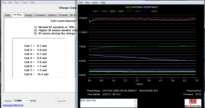

Postby Furio » 12 Mar 2019, 04:32
Dec 20 charge graf (Internal Resistance)

Postby Burgerman » 12 Mar 2019, 10:37
You have a bad connection. One of your cells or more is not making contact properly.
Bolts, oxidation, connectors? No crimps hopefully because that will do it...
Most likely crimps or loose bolts.

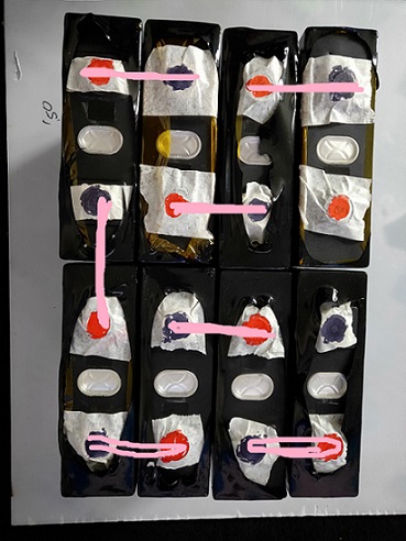

Postby terry2 » 13 Mar 2019, 11:59
I have put Kapton and heat shrink around the cells.
Does this picture look right for the connectors? Also which cells do I connect the balance wires to?
I know the red is for live and the black is for earth. But where do the other 7 go?
Postby Burgerman » 13 Mar 2019, 12:13
That will work.
But its easier if making your own ring terminal + wire connections (as you should) to turn all the cells the same way around. You still connect the same terminals, plus to minus repeated, but now the connections are longer and easy to make.
Where do the 9 balance wires go?
Starting at your black negative battery terminal, thats the first neg wire. So 0. Then the same battery plus. And every battery plus as you go along.
Postby Burgerman » 13 Mar 2019, 12:20
I numbered them on your image.
Your nine wires. Are in fact 0 neg wire start, then every plus terminal is cell 1, 2, 3, etc.
The neg or 0 wire goes where shown as 0
Every other + cell terminal then follows on as marked. So...
1 is the first cell.
5 is cell 5.
8 is cell 8 etc - i missed some out.
Dont get it wrong because you COULD smoke the PL8. :o
Its hard to do that he says :lol: . Because the sides of the white PL8 balance lead is marked with red and black.
Postby terry2 » 13 Mar 2019, 12:35
Burgerman wrote:I numbered them on your image.
5 is cell 5.
Thank you so much.
Yes I am making my own connectors using 10 SQMM wire.
And the cells will only fit that way. So not much choice in that matter.
Well if my PL8 smokes, I can blame you :D

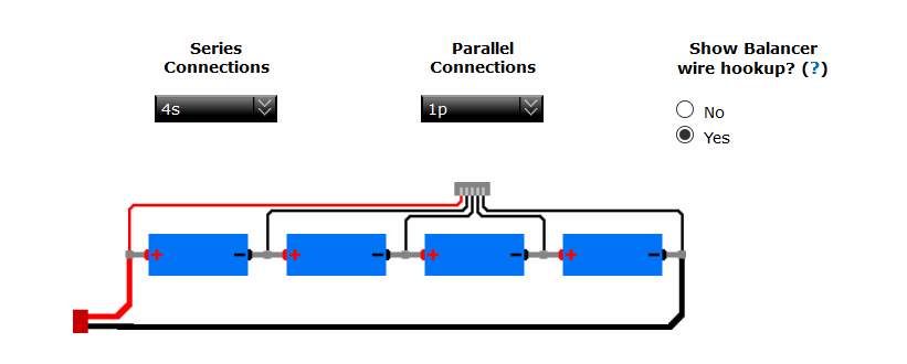

Postby Burgerman » 13 Mar 2019, 14:42
https://scriptasylum.com/rc_speed/lipo.html
For you to learn.
And you misunerstand. Put cells in same shape, but turn every other one 180 degrees. It means the cell connections are easier.
Postby Burgerman » 13 Mar 2019, 14:45
4S for 12v
8s is just longer...

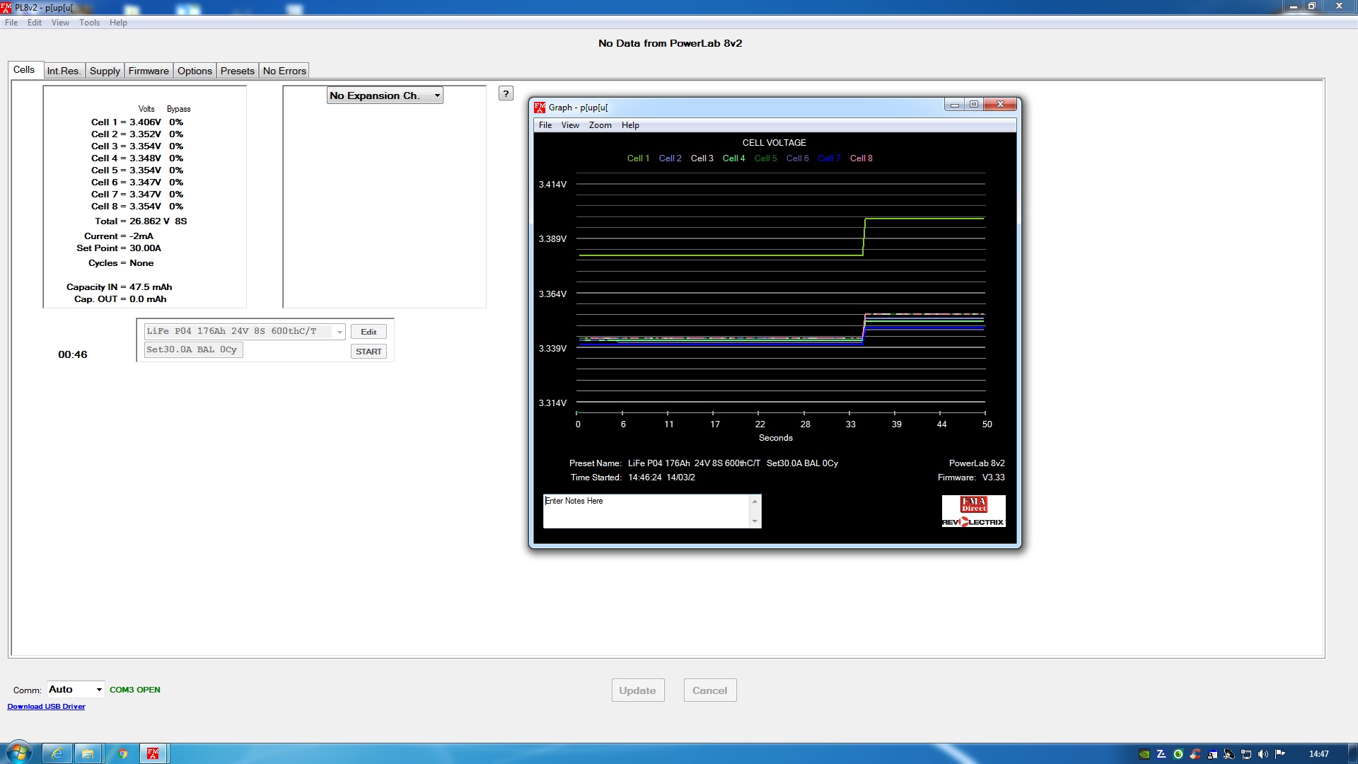

In the cells tab it says Cell 1=3.589 99% and above it. It says bypass
Postby Burgerman » 14 Mar 2019, 16:03
Set about 25V and 50A.
Then in PL8 set supply tab to 10 to 30V and to 47A max...
Cell 1 is much more charged than cells 234567.

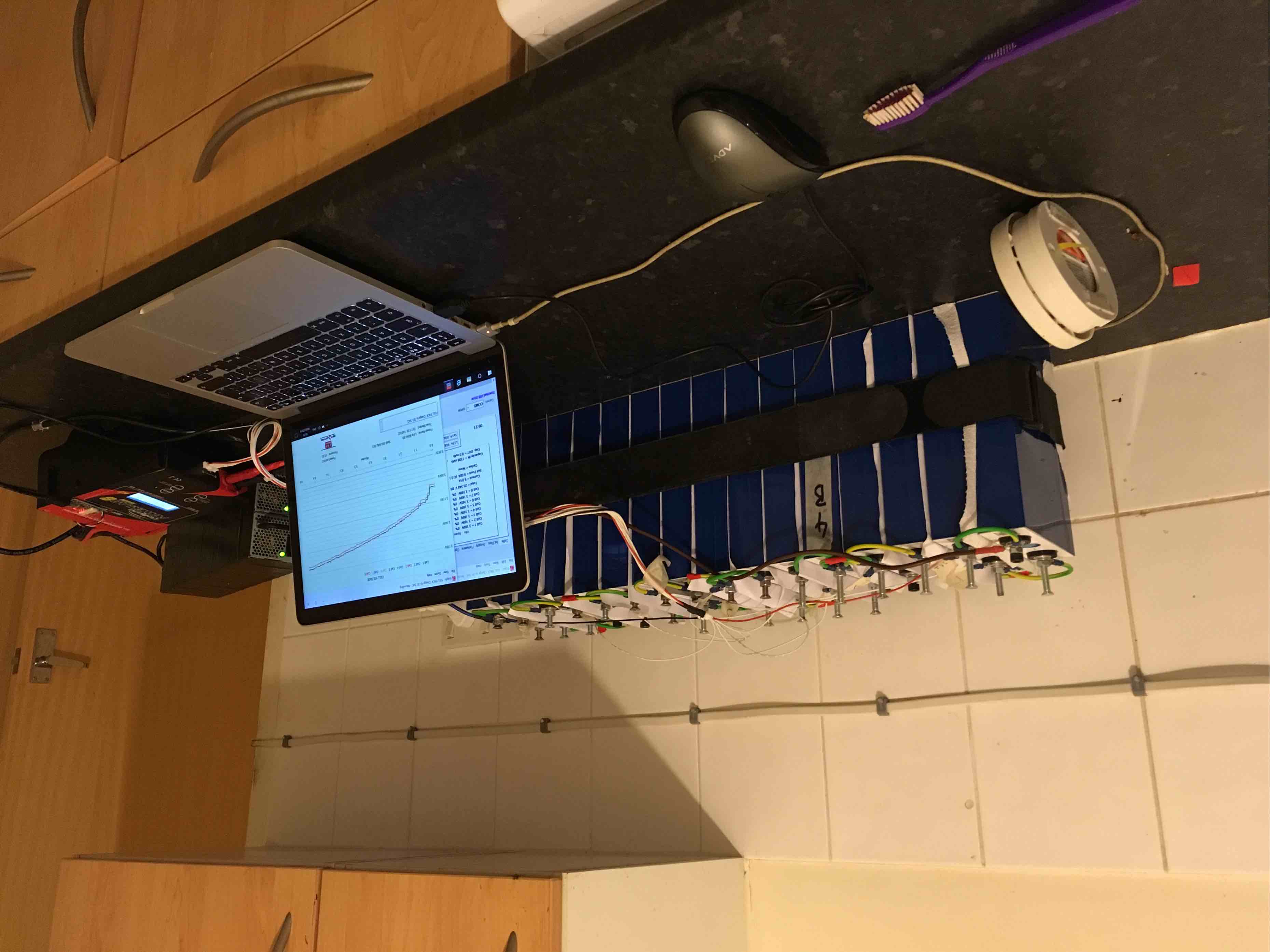

Postby Scooterman » 14 Mar 2019, 19:55
Temporary connections for partially recharging matched cells in 2P8S prior to building the pack. 16 cells in a row are a bit of a stretch for the pigtails, but it's a one off and I'm worn out so couldn't be bothered to rearrange the pack into two parallel packs.
I just wanted to say how nervy I was making all the connections. I dread to think what a nightmare a big pack of headway cells are to arrange czy
Postby terry2 » 14 Mar 2019, 19:58
Scooterman wrote:Temporary connections for partially recharging matched cells in 2P8S prior to building the pack. 16 cells in a row are a bit of a stretch for the pigtails, but it's a one off and I'm worn out so couldn't be bothered to rearrange the pack into two parallel packs.
I just wanted to say how nervy I was making all the connections. I dread to think what a nightmare 72 headway cells are to arrange czy

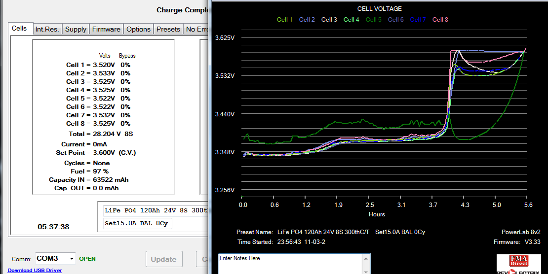

My pack has charge and balanced(I think)
Postby Burgerman » 14 Mar 2019, 20:04
Scooterman, how do you get all those cells to stick upside down and the laptop too? :worship :eh:
Terry, yes it looks balanced and well full.
Now choose discharge, for 2 to 3 hours. And post a screenshot.
All cells should be very close like a single line almost.
Then choose recharge, and they should all be almost completely balanced straight away as soon as the charging finishes.
And another screenshot.

terry2 wrote:
I felt the same.
It looks that way. The cells must have been full already because one cell briefly shot high and the whole pack only consumed 0.25Ah before terminating.
But I'll defer to better heads than mine, I'm still learning.
