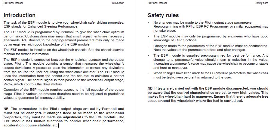

I found this picture in the other thread:
I have ESP! Could this be the issue? Where do I find the ESP module on my c500?

I believe that ESP in this case is Enhanced Serial Protocol....and it applies to the 1314 CURTIS Software...not P&G

This image was in the same thread:
Does this mean I wouldn't benefit from reprogramming the controller because the ESP is the guy in control?

It means Enhanced steering Performance (http://www.permobil.com/en-GB/English/O ... onics/ESP/)

Had a quick look thru the same pdf and it seems that you can program via the ESP within certain preset parameters... with the usual Warnings of Alterations by Expert Engineers only.
Never seen one or played with one ...no idea if changing the Pilot+ parameters would sod everything up ..but I doubt it as the ESP seems to just apply a percentage of the Pilot+'s setting.
Up to you to decide if you'd like to play with it ...taking notes of course as you change each parameter....and there is a reset to original facility .

Ok, I can't reach the esp on my own to press the "S" button. So I will have to ask someone to help me. I will create a backup of all settings.
I can now quite safely say, if you have ESP on your permobil wheelchair, it's not as simple as the guide here says :)

Cant you just unplug it and connect the pod to the controller as per usual? That ESP thing just interferes with stuff. Probably best without it. It will be to help those with bad hand movements or with alternative controls.

Not sure what model chair JenR has, but I have a vague recollection that the ESP module is used by Permobile on their FWD style chairs to keep them from ground looping and doing all the other FWD instability related stuff...
If she has an FWD chair then it might not be a great idea to remove it....
