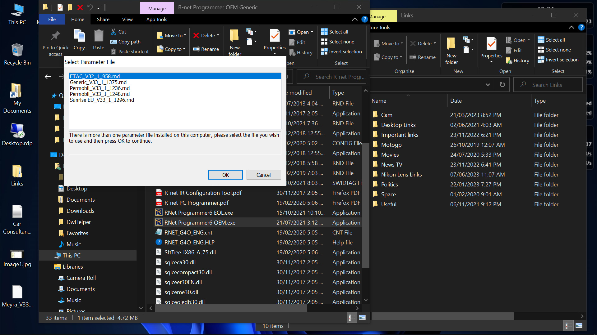

To clarify...
THIS IS PLAIN OEM GENERIC with no meyra anything, no extra files, as it comes. It already has the same new module SERVO settings. No file swapping required. It however does not properly program a meyra optimus servo system. And still has the same nonsense and potentially damaging settings in the speed section.
And as you see theres no meyra rnd files here. I selected GENERIC.
I have a few more than you here, and select whichever I need. I will now add AND SELECT the MEYRA one in the following post...
Posts: 71111

And this is the Non of these are correct to configure
a) the single channel power module that is customised for meyra. And other single channel scooter buggies.
b) the meyra made servo module
Some of it may work. But may have the wrong or unintended consequences.
I dont have a chair with a meyra module or a single channel controller here to test. But this is what I see just looking at the files and various programmers. Correct me if I am wrong! I may be.MEYRA version with the swapped files, and it is exactly the same...
