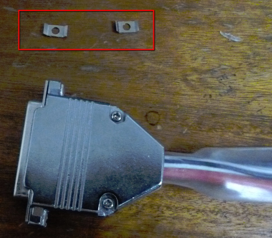

I just tried to fit a metal shell. There are 2 small pieces that I do not know where to put them. Do you recognize them? Where are they placed?
Posts: 1258
Postby sad_vampire » 19 Oct 2017, 11:13
Washers that go between the body of the D-Sub and the thumbscrew/screw that holds the D-Sub connectors (male & female) together.

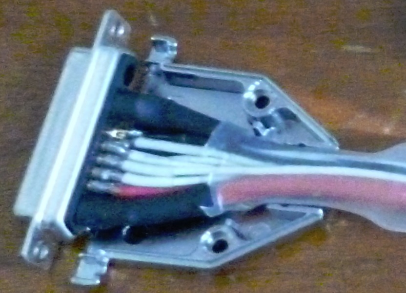

Postby snaker » 20 Oct 2017, 02:05
@expresso: Here is the picture of inside. My dad soldered this DSub, how does it look? I bought 2 pairs on taobao.com through a link that Steve or Sherly had posted here. In reality it is smaller than it looks in the picture. Comparing to your branded Dsub, it is not as good as yours. You can see it is not insulating painted.

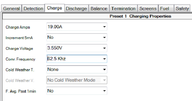

Postby snaker » 20 Oct 2017, 02:50
Burgerman wrote:After the first 5 or 6 charges you can drop charge voltage from 3.600v to 3.550 or even 3.500 if you want. But it will take more time to end CV and balance less well/slower.
I like to decrease the charge voltage down to 3.550V to check if the charging voltage graph gets better. Is the "charge voltage" in the Charge tab as in the picture below? Do I need to change any other parameters to match with the new charge voltage 3.550V?
Posts: 1258
Postby Burgerman » 20 Oct 2017, 08:52
Correct. But dont do that till you have everything working and completely balanced as it reduces balance accuracy and speed too.
