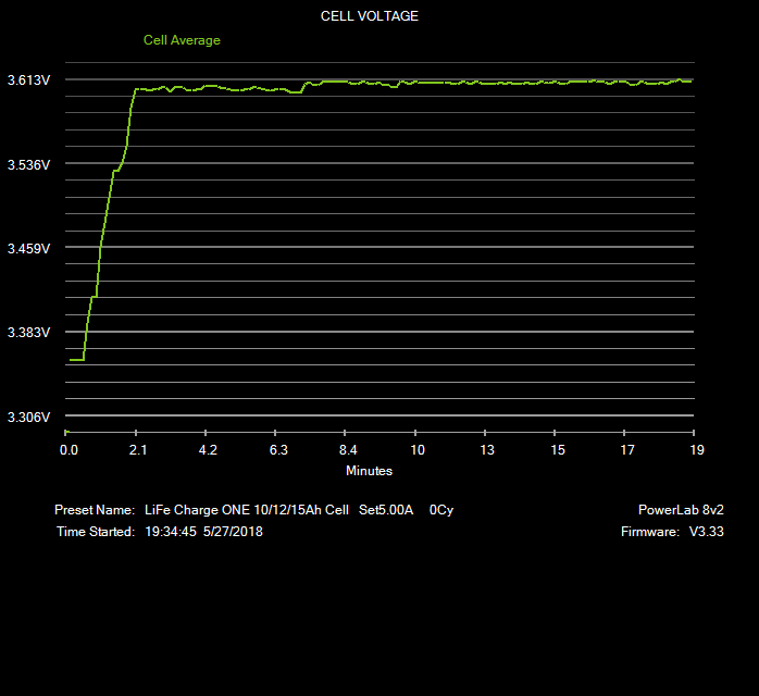

For charging 1 x 100Ah sinopoly cell at once with that preset, choose a charge rate between 1/6th to 1/3rd capacity. So:
On a 100Ah cell, I would choose 1/3rd, so 30A charge is OK. :thumbup: Less is OK too but slower.
And set termination manually to 100thC to 200thC for testing with no balance. (So set to .5A to 1A which is 500mA to 1000mA).
Set time limit on CV to 2 hours.

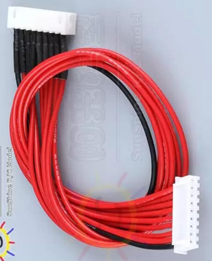

Buy a 8S extension cables , and cut it in halves . Extend the leads, and connect one half to a battery and the other half to the next .
Balance your two packs seperately. Connect the SB50 main plugs first, and then the extra 8S connectors .
Now all cells are inter-connected and PL8 will see them all, so no cell will be over-charged .
You have TWO charging connectors available now , and you can recharge the the two packs as ONE with any one of the them .
Unplug them all , and you restore them back to TWO stand alone individual packs .
Good luck .

Postby garriew » 28 May 2018, 01:58
My 1st one is done. Took 20 minutes.
garriew
Posts: 334
Joined: 06 Dec 2013, 07:11
Location: Mt Vernon, IL USA
Re: PINNED - ADD ON PACK Step By Step 30ah Pack build / pict
Postby garriew » 01 Jun 2018, 19:10
Batteries are charged! I didn't know what to write for the first five but saved the graphs. The others are:
6 = 273
7 = 209
8 = 233
9 = 339
10 = 312
11 = 436
12 = 241
13 = 252
14 = 289
15 = 253
16 = 245
17 = 502
18 = 245
19 = 243
20 = 323
21 = 254
22 = 357
23 = 266
24 = 280

Postby Burgerman » 01 Jun 2018, 20:55
11 and 17 are a bit away from the average. When you assemble the pack try to put those at the edge, as they are more likely to deteriorate then the rest.
Get the data from the graphs for the first few.
Assemble into 8 groups, of equal number, that have the same TOTAL mAh once they are added up.
