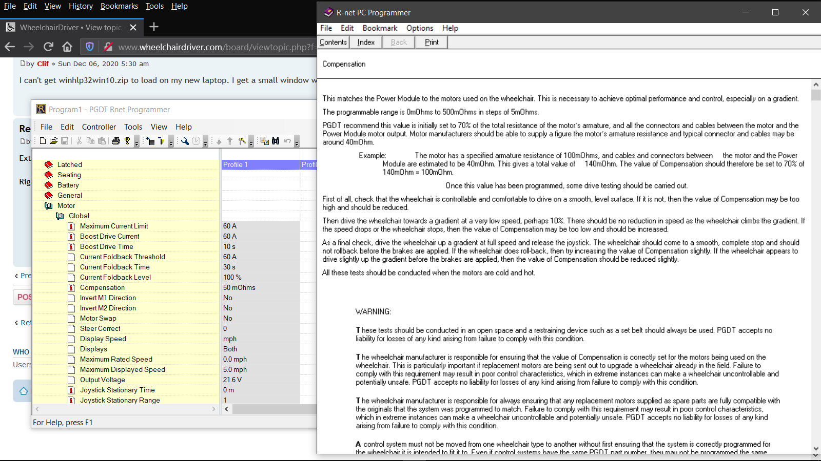

Postby Clif » 06 Dec 2020, 06:30
I can't get winhlp32win10.zip to load on my new laptop. I get a small window with a large i and 9009 written in it. Any ideas on how I can get help files?
Clif
Posts: 93
Joined: 19 Feb 2018, 19:59
Location: Fort Pierce Florida, USA
Postby Burgerman » 06 Dec 2020, 07:19
Extract the 3 files from the zip.
Right click the install.cmd file and choose run as administrator.
Postby Burgerman » 06 Dec 2020, 07:31
And then it works...

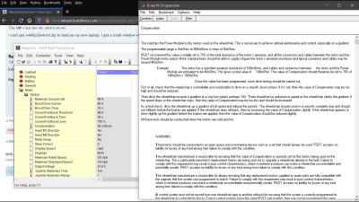

Postby Clif » 07 Dec 2020, 05:25
winhlp32win10.zip- I extracted , ran as admin but get an error code. (9009). This is on my new laptop. Works fine on my old screwed up WIn 10 laptop. I'll search google.
Clif
Posts: 93
Postby Burgerman » 07 Dec 2020, 05:44
You extracted THREE files to a folder.
You ran the dos file, not the other two. I suspect you attempted to run the exe file in error.
You right clicked it, chose run as administrator, and got the error? Its an error code that means file not found. I suspect you didnt extract the 3 files and have run only the cmd batch file.
Or you did, and are trying to run the exe file.
Just tested this on my ex laptop. Worked perfectly. Win10.

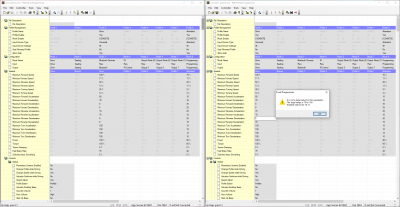

Postby Davey » 25 Jan 2021, 19:16
Burgerman wrote:Well one of the most popular manufacturers certainly doesent! And this is why DEALER LEVEL programming is useless. Well one of the reasons!
Look at this STOCK programming with WALLS set up here! On my new Sunrise Q700R.
No way to make the damned thing steer with all these wallS set up! I need to set at least 4 of those to 100 in "speeds" to make it steer. And others to higher than it will allow in other settings. And deceleration to less than it allows. DEALER = Useless for this chair.
One before. With all the restrictions.
One showing all the ones now set properly!

Postby Burgerman » 25 Jan 2021, 22:21
You SHOULD be able to save the OEM file with the dealer PC software.
Modify it in the same way as the one I did for the 3 with OEM software once you have saved that file to your desktop with the OEM software and then reopened it. Then save again after modification to desktop.
You can open 2 instances, as you copy the settings. So that you can clone it manually. Dont mess with seating or motor compensation, only the walls and the drive settings. Then write that back to the chair with the DEALER software and dongle.
You MIGHT need to change the character of the software to permobil from the top menu. CONTROLLER>PERSONALITY to permobil. If it will.
If that doesent work, blame permobil for messing around with firmwares to stop you programming it.
NOTE. Regarding FRONT DRIVE - yes yours is mid. You cannot set the turn accelleration and deceleration parameters (all 4) to 100 with a gyro set to on or it will be terrible to drive. A gyro tends to amplify the turn acceleration settings BY A LOT. I prefer these all set to 100, but with gyro off. Or no gyro on the chair. Then it steers properly. But on a front drive chair you cant do this as it goes unstable and tries to swap ends with no gyro. Its why I dont like front drive or permobil personally.

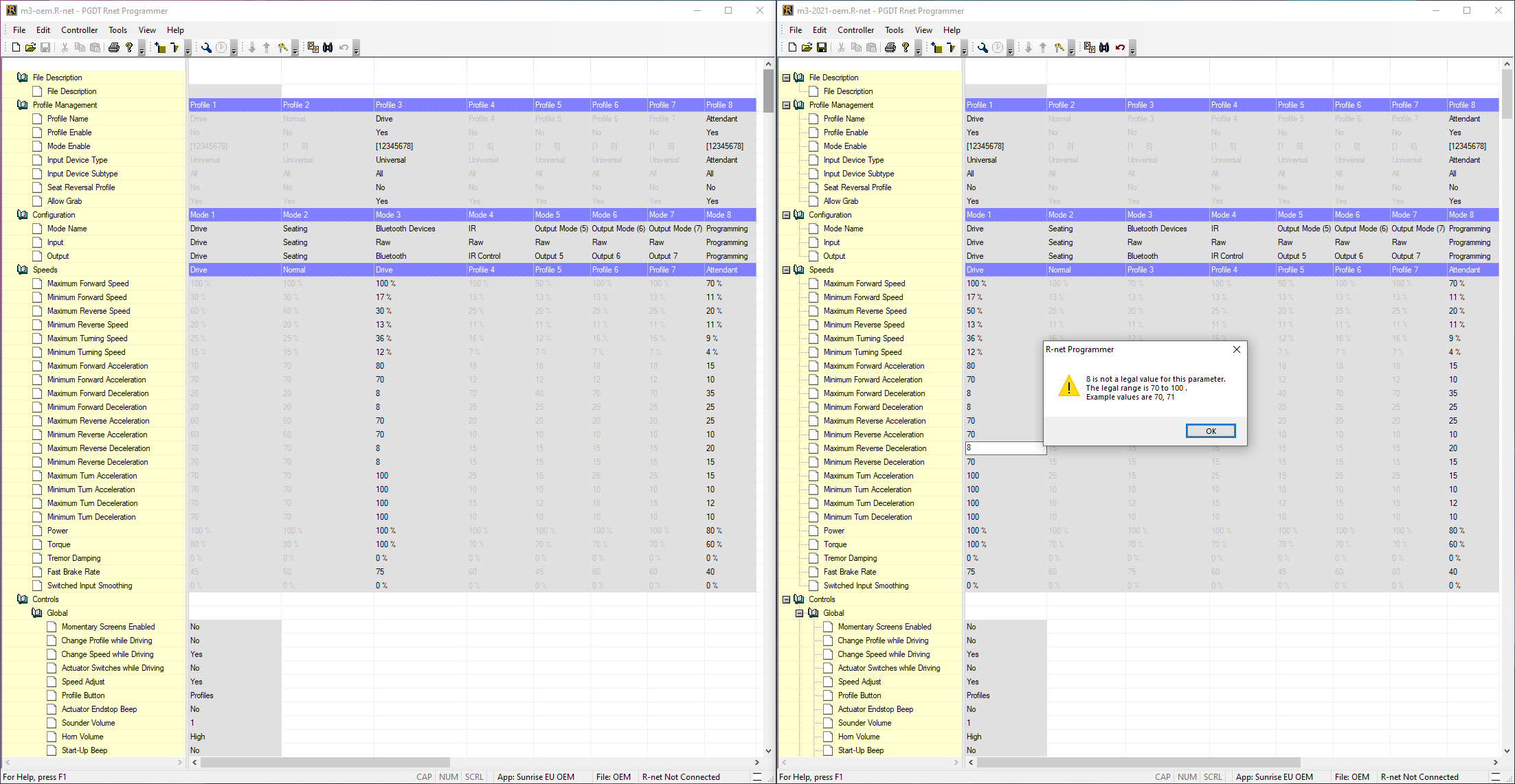

Postby Davey » 26 Jan 2021, 16:57
I'll give it another shot. I've been able to do all those steps (save OEM file, edit with OEM software, download OEM using dealer dongle/software, etc.), but as I remember, the OEM software still wouldn't let me go outside a particular range like you had set in the older config. Left me try again and report back with more specifics. Thanks!

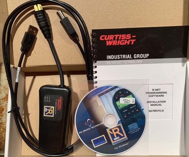

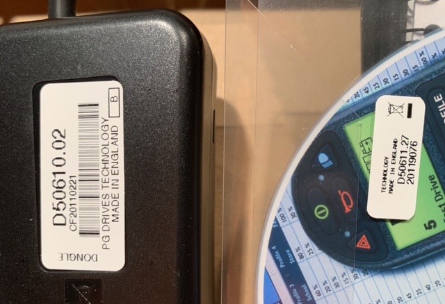

Postby majoraxis » 28 Jan 2021, 09:42
I’m new to the site. I wanted to share my experience in purchasing a new R-Net OEM programmer and software from (PM burgerman for info - edited by Burgerman)
I was able to purchase the R-Net OEM programmer dongle, software and USB cable from the above link. I mentioned I heard about them through wheelchairdriver.com and was able to purchase without an issue. It was $450 plus shipping.
The last one that sold on ebay did not have a label on the back of the dongle so I could not confirm whether it was an A for dealer or a B for an OEM so I didn’t bid to win it. It sold for $395. So for less than $100 more than the going rate on ebay, I was able to purchase a new one.
Here are some pictures of the contents of the box in case you wanted to know what you would get or what a legitimate OEM version on ebay should look like.
Mark

Postby Davey » 30 Jan 2021, 19:37
OK, I'm checking back in and everything went a lot smoother this time around. There were only two settings (Reverse Deceleration) that I couldn't get to match my old M3 settings (see below) so I'll see what those missing changes cause when I transfer to the new chair. Thanks Burgerman for your help, again.
