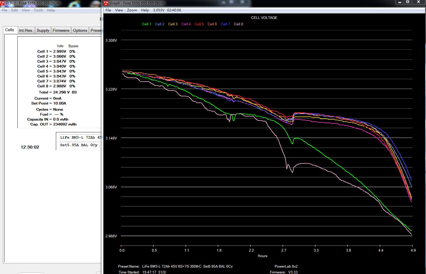

Postby shirley_hkg » 02 Apr 2019, 09:45
My mega G24 pack delivered 234Ah only. :blond
Connections are temporary and need further attention, especially at the 2 ends. :fencing

Postby Scooterman » 02 Apr 2019, 10:28
It's quite pretty though.
We could print and frame some of these graphs and flog 'em (sell them) as abstract art.

shirley_hkg wrote:My mega G24 pack delivered 234Ah only. :blond
Is the discharge curve steeper than just lithium because it's a discharge curve for a combined lead & lithium pack?
