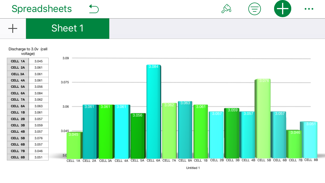

Shirley has kindly got me 16 of the EVE-LF90 cells which after a bit of time wasting by UPS arrived yesterday :dance
Going to be using them in my wheelchair as a 2P8S pack.
I've maybe overloaded myself on too much information from reading all the previous threads/posts and would like to clarify the best way to proceed.
    • Charging each cell to a fixed value. Leaving them for a few weeks to self discharge and measuring the loss. Making 8 pairs with similar self discharge over the set.
    • or Charging each cell to a fixed value. Discharging to 3 (or 2.9 volts) to measure capacity. Making 8 pairs with similar capacity over the set.

Postby Burgerman » 05 Apr 2019, 12:12
When you have many small cells like in the headways, its worthwhile doing that, both capacity and more importantly self discharge measurements and then building closely matched strings. With only 16 cells its a lot of work for little gain. So you could just build it and do a single test with all cells before fitting.

Postby foghornleghorn » 05 Apr 2019, 12:19
So just build the pack, test it as charging and discharging fine once assembled, then if ok fit to chair and start using.
Not worrying about matching cells up in pairs at all?

Postby Burgerman » 05 Apr 2019, 12:57
Depends on how much time and patience you have.
The idea is that you would make 2P groups with the same self discharge rate primarily. So charge all full. Then remove say 5Ah exactly from each. Then store for a month or more. Then charge each one individually. Note Ah returned. There will be a few mA difference between cells. So if one is high, match it with a low one. So its average like all the other groups.
You can do the same with capacity too. If you want. Thats not so important with headways as they are remarkably similar and with say 72 cells they average themselves.

Postby foghornleghorn » 05 Apr 2019, 13:13
Does the self discharge indicate an imbalance that will be amplified in use, or is it more a factor affecting leaving the chair sitting unused for a week? Just trying to get my head around whether pairing self discharge is more important than pairing capacity.
Posts: 710
Postby Burgerman » 05 Apr 2019, 13:51
If 7 of your 8 groups lose 20mAh per day, and one loses 120mah per day, and you charge daily, not a problem After a month without chaging, thats 30xdays 100mAh so one group are now 3Ah out. On subsequent charge it will take 3 hours to reblance with the PL8.
It may be closer or further apart than this. Only measuring can tell.
As far as capacity testing goes, then as long as you dont run it low, it wont ever make any difference. So a large pack, not a problem Small pack, where you may empty all cells to 95% but one group is 100% empty then you have issues...
So with a big enough pack, capacity testing and matching doesent matter much. But charging weekly, or monthly the self discharge becomes more important. Esp if unused and stored for 6 months...

Postby shirley_hkg » 05 Apr 2019, 14:23
If used everyday , self-discharge rate shouldn't be a big concern , or the cell were severely defective otherwise .
Capacity matching is more meaningful to me .
Set up two 1P8S batteries . Perform full discharge down to 2.98V via PL8.
THEN ASSIGN THE STRONGEST CELL OF ONE GROUP TO THE WEAKEST OF THE OTHER .
I'd get the lowest terminal voltage of pack , before the weakest cell pair reach 2.98V. This will make everyday use more comfortable .
