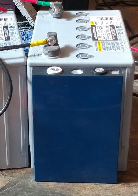

tested better than expected - finished 88.5ah discharged to 2.9v - from 3.6v -
Postby Burgerman » 07 Apr 2019, 01:34
So realistically they are 90Ah cells fully discharged. Thats not bad for real Ah rather than chinese smaller marketing Ah!
Also remember you would get a little more if discharged at say .5C as they warm up and perform better. So I would not worry about those. A solid 180Ah pack with 16 cells. For 54 dollars a cell.
If you compared to lead MK Ah they are already about the same.
MK GRP 24 are 73.6Ah at the 20 hour rate. But sadly in the real world we go 7 to 8 mph. So do 14 to 16 miles and run out of fuel in almost exactly 2 hours after setting off! And thats the 2 hour rate. And that means we get just 35Ah to 40Ah from them before we grind to a halt!
So GRP24 accessible only 40Ah. We will ignore the 7 times shorter lifespan.
For how much? 519 a set. Plus shipping that we will ignore. https://www.phc-online.com/GRP24_Batter ... -24-ft.htm
Thats 12.9Ah per dollar.
LITHIUM: 8X cells, 54 dollars each for the 24V 100Ah (90Ah usable) is 432 dollars! Plus around 120 fedex air shipping. So 552 dollars delivered.
Thats 6.13 dollars per USABLE Ah. HALF the cost per Ah.
Or 552 compared to leads 519 dollars, but with 2.5x the range.
But you can fit 16! So you can fit 5x the stock range. Which is the whole point!!!
I cant afford lead. These figures ignore the 10 to 12 year service life.

I have the 75Ah version of these cells from the same seller. Very consistent, all measured ~66Ah to 2.9v. I was a bit more conservative on the Ah to fit, as I am having a bespoke 1.5mm thick sheet metal box made to house them. Which will easily fit in the footprint of my lead bricks, insulation included.
Postby expresso » 07 Apr 2019, 03:04
thats the best bet all around for high Ah and fully sealed - if you have the room - thats the way to go - easy to work with that size
how tall are those ? 195mm ?
Postby Gnomatic » 07 Apr 2019, 03:28
Yes 195mm tall. Room to spare in all directions. Which is what I wanted.
Postby expresso » 07 Apr 2019, 03:43
i doubled checked mines - they are spec to be 202mm - i checked on inches and comes to 8 inchs - should give me room for wiring and end up the same as the MK at 9.5 inches hopefully
you have tons of room to seal those nicely and never worry :thumbup:

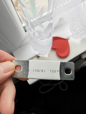

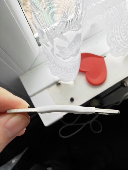

Postby terry2 » 08 Apr 2019, 10:55
Just had these come from the battery guy(I never asked or paid for them)
They are 2.2mm thick, but the middle is a bit bendable .
I have emailed him to see what he wants done with them.
Postby Burgerman » 08 Apr 2019, 11:28
Bin.
Postby terry2 » 08 Apr 2019, 11:31
Burgerman wrote:Bin.
:D
He may want me to send them back.
They are thin strips of copper plate. Solid at the ends and flexible in the middle.
Postby Burgerman » 08 Apr 2019, 16:55
How flexible? Like a cable?
