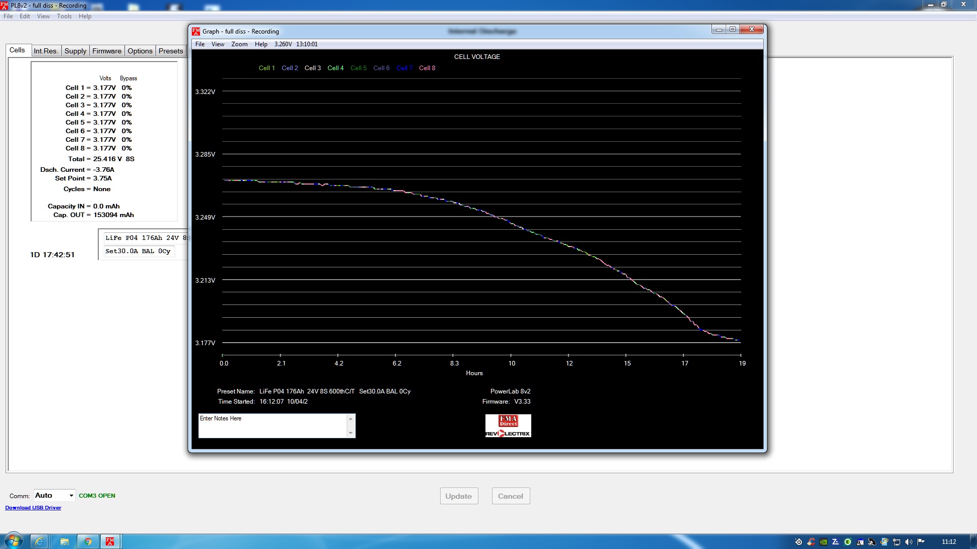

Postby Burgerman » 11 Apr 2019, 11:03
Keep posting voltage graphs and Ah.
Posts: 71095
Postby terry2 » 11 Apr 2019, 11:13
Burgerman wrote:Keep posting voltage graphs and Ah.
For some reason the graph only started 19 hours ago.
Postby Burgerman » 11 Apr 2019, 11:16
Computer went to sleep? Or USB did. Or something. Keep going.

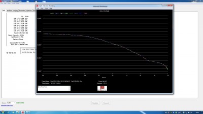

Postby terry2 » 11 Apr 2019, 13:18
Burgerman wrote:Computer went to sleep? Or USB did. Or something. Keep going.
Most likely. another graph. Not long to go now :)
Postby Scooterman » 11 Apr 2019, 13:30
It’ll finish any minute now Terry. See how steep the graph is dropping
Postby terry2 » 11 Apr 2019, 13:48
Scooterman wrote:It’ll finish any minute now Terry. See how steep the graph is dropping
Yep :)
The lowest cells is Cell one 3.108V
I wonder how many amps I will really get out of the stated 176Ah

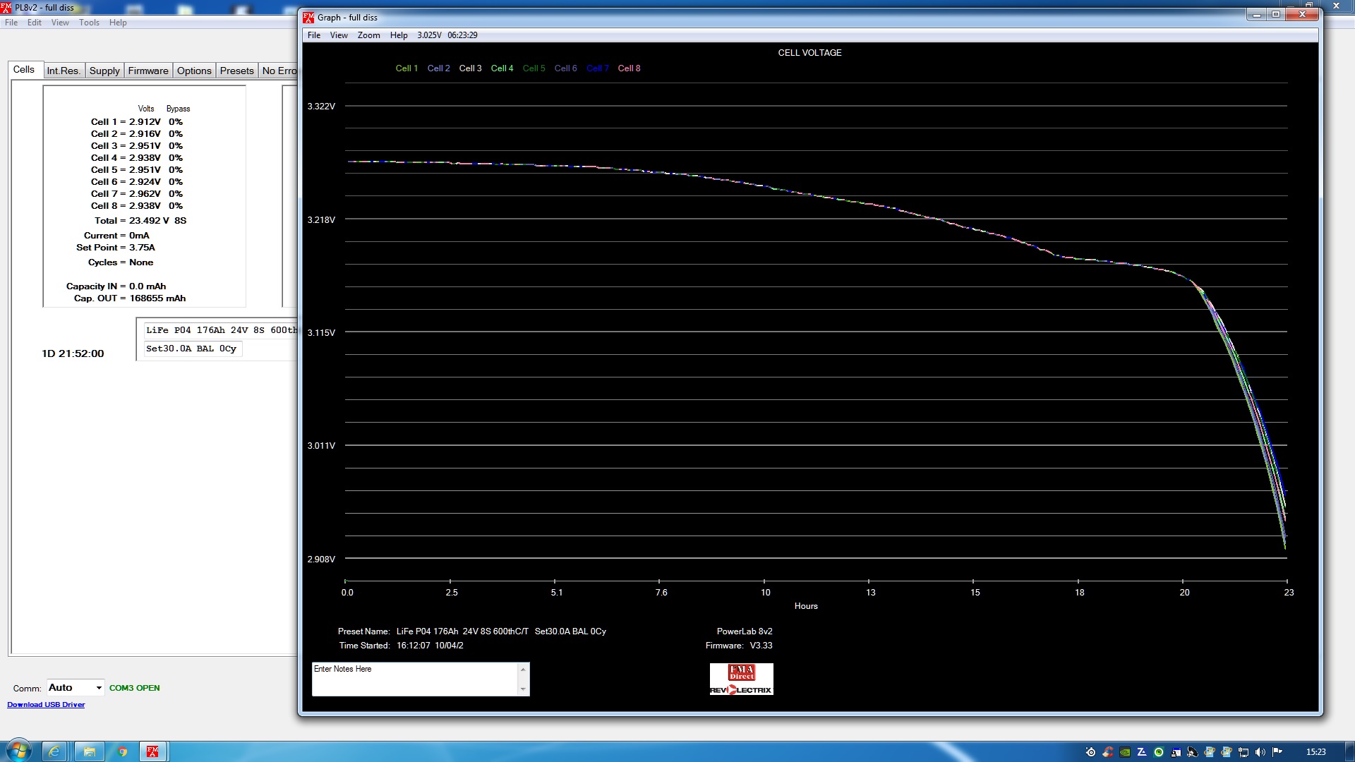

Postby terry2 » 11 Apr 2019, 15:26
All done :D :clap:
Postby expresso » 11 Apr 2019, 16:09
very nice you got what i expected - which is great - alot of AH you have there 168ah - - our of 176ah spec. its pretty good - less than 10ah difference which i would consider great - its a pattern i been seeing with all these Cells - so far - 3 sets of Cells -- all showed the same very similar -
i would say what ever Cell you find - what ever Spec they rate it at - just remove 10ah and the Cells should give you no less than the rated spec minus 10ah - i would consider that very good - :thumbup: you should have nothing to worry about - if anything - then its the connections
how long did it take 2 days nights ?
Postby terry2 » 11 Apr 2019, 16:16
expresso wrote:very nice you got what i expected - which is great - alot of AH you have there 168ah - - our of 176ah spec. its pretty good - less than 10ah difference which i would consider great - its a pattern i been seeing with all these Cells - so far - 3 sets of Cells -- all showed the same very similar -
45 hours in total czy
Now I am going to recharge them up ready.
And you are right. These cells we are getting are awesome.

Postby snaker » 12 Apr 2019, 02:11
@terry2: the discharge graph of your park is perfect. Why do not you enjoy it by driving a 'mad' trip until you or your pack is completely drained :mrgreen:

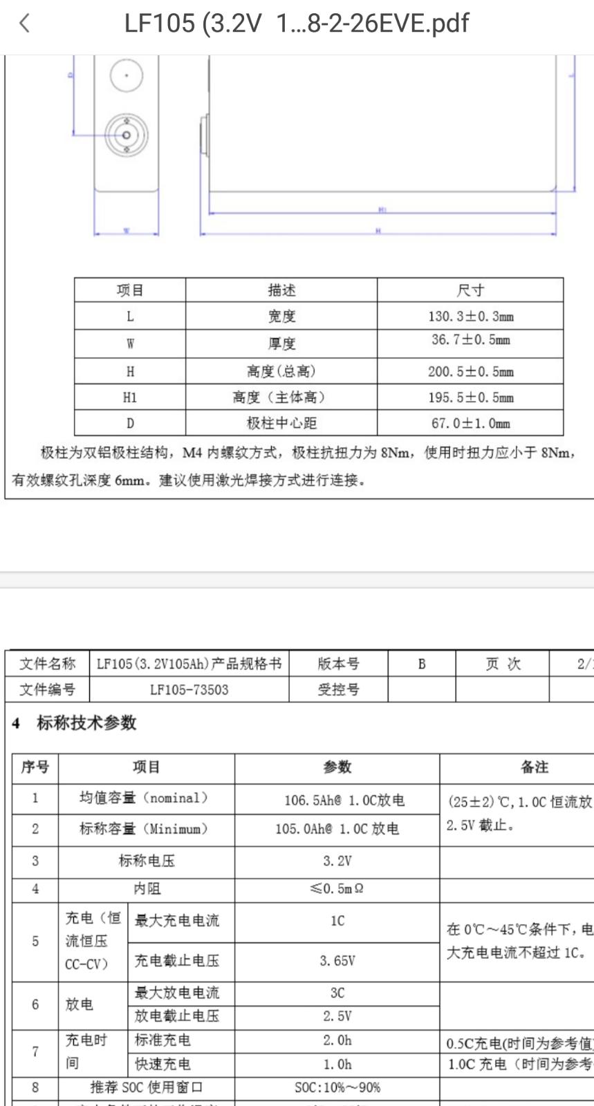

Postby shirley_hkg » 12 Apr 2019, 08:04
Going to get hold some EVE-LF105 cells , directly from factory . 105Ah rated and brand new .
John , do you think M4 will work ?

Postby Burgerman » 12 Apr 2019, 09:40
M4? Sounds dodgy! Might be OK if that aluminium alloy is hard enough. But it sounds a little small and weak to me.
Helicoils mean you end up with a M6 thread again, but it is steel/stainless steel.
