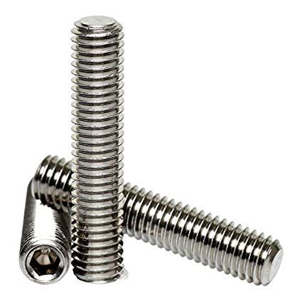

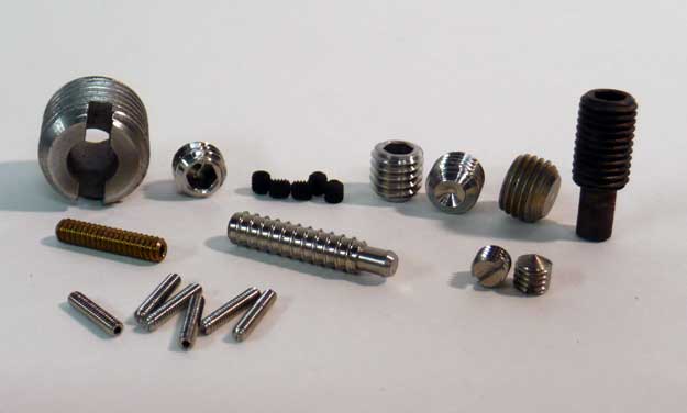

Postby Burgerman » 19 Apr 2019, 10:16
Threaded studs.
A grub screw is a short screw, used to tighten against a shaft, or to lock something in place like a pulley on a shaft for e.g. and can have various head types. Often hex, some are slotted, some square but are short, designed to lock something in a hole without protruding.
Heres a google page showing them. https://www.google.com/search?q=grub+sc ... 25#imgrc=_
Heres an image of them.

Postby Burgerman » 21 Apr 2019, 01:03
By grub screw, you actually mean a threaded stud dont you?
Because a grub screw is a short screw, with pointed end, ir a nylon insert end, a thing used to tighten against a shaft to lock a wheel or pully or something in place. Thats not what we are doing with a battery.
Thats not a permanant thread lock.
Threadlocker Disassembly Removable,
It MAY work, a bit like your blue one but probably harder to undo. But it also may unscrew when you knock a ring terminal, or try to undo a nyloc style nut - which we do not want.

Postby LROBBINS » 21 Apr 2019, 10:03
Although a grub screw is usually a "set screw" as Burgerman describes, they actually come in sharp point, cup point, dowel point and flat end varieties and in long lengths as well. Here's an example:
The flat end type, normally used to lock something on a flatted shaft, can be used as a stud and because they have a tool fitting at the other end they are easier to install than plain studs (for those, it helps to first put on a pair of nuts and tighten them against each other) and, if for a hex key, you can use the key to keep them from turning, even with removable loktite, while installing or removing terminals.
