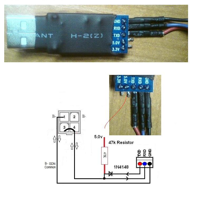

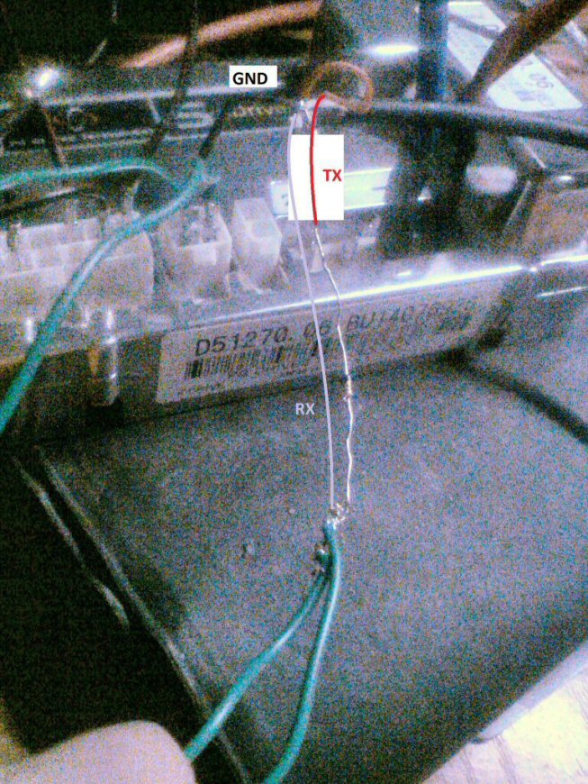

I did check. Kenwood cable. Connected to the computer. Connected to the controller. Then launched a program to check the data signal COM port. The program has shown that data transmission errors is NO! Run the program Mobility gives an error that shows no COM port - no connection! Help what to do?

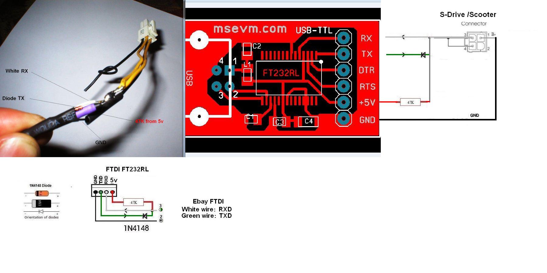

I have sent you various pictures of how to wire the controller.... as far as I can see from the pic the wiring is WRONG.
BUT ...Having the wiring correct doesn't always mean that the cable will actually work ... some leads work ...some don't.
Postby woodygb » 10 Jan 2015, 21:18
SOME leads may need the resistor ...others not.
Wire COLOURS vary on different cables

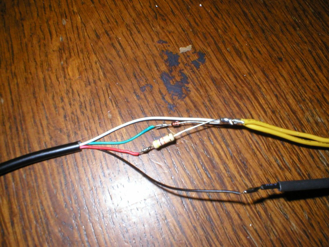

Postby woodygb » 10 Jan 2015, 21:31
Picture 009a.jpg (207.74 KiB) Viewed 14435 times
Postby woodygb » 10 Jan 2015, 21:45
Re wire like this ...
BUT it may not work................ SOME cables do not ever work.
Postby vinsen » 10 Jan 2015, 22:13
bad pictures. Dark. Morning photograph.
There are two versions of the cable. On-chip and chip PL2303 and FT232RL
Cable PL2303 chip - there need to put only a diode. The resistor is not required. On the cable where the FT232RL chip - you need to put solder a diode and a resistor. I probyval all options. No connection. Tomorrow make an exact copy of your cable as in the photo. Check .Because report results.
thank you.

Postby woodygb » 10 Jan 2015, 22:39
Bad photograph ..but where is the second RX wire?
