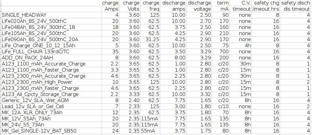

in an attempt to better understand preset values for the PL 8,
i summarized a few files in this table: comments?
preset files table

Postby Burgerman » 28 Oct 2017, 17:36
Theres many reasons I change settings. Both ones you can see in the charger software and some that you cannot. I wouldnt collect presets that way, as you have no idea waht or why I set whaat I have. I make changes to charge a specific pack or cell for a reason. It may be age, to charge roughly full, to assemble a pack, to fully charge quickly to stor the same cell, to measure self discharge etc. It may have wide or narrow voltage limits or whatever, that are unseen etc.
All the stock presets that you have are also very restrictive and will likely give errors on a large LiFePO4 pack such as cell voltage spread too wide and it will limit to .5A etc. Best not to save all those unless it came with a page of notes.
I actually hate presets. Better to have a charger that just allows you to set anything you want and save it. Presets have hidden stuff... some of which I change.
And all the stock presets are hopeless for everything but hobby sized lipos, all the stock generic lead acid presets are worse than useless and will damage the batteries.
