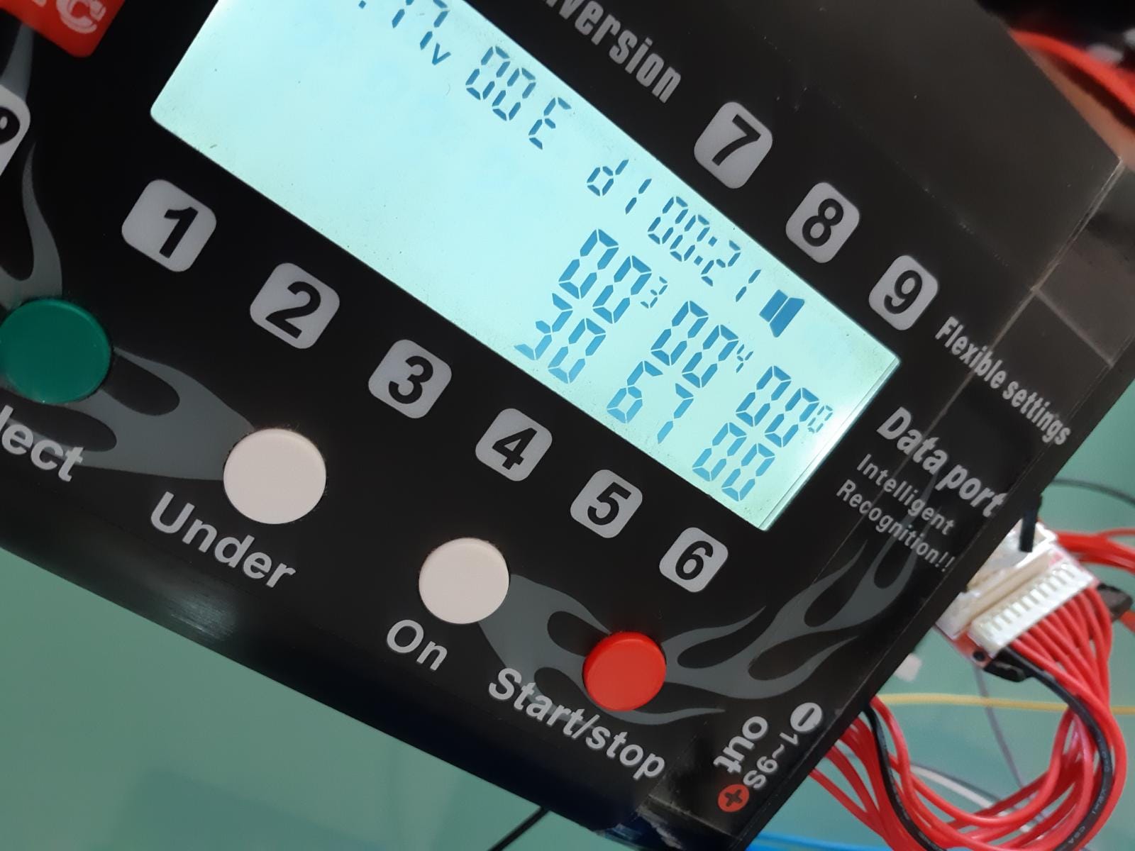

Drained all cells to their 3.00V, to measure their difference in capacity.
Max 515 --- Min 316 in mah.
Postby shirley_hkg » 27 Apr 2019, 08:39
Recharging. Lines are solidly close so far, 98Ah back already. Will be full in minutes. cheers

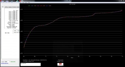

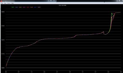

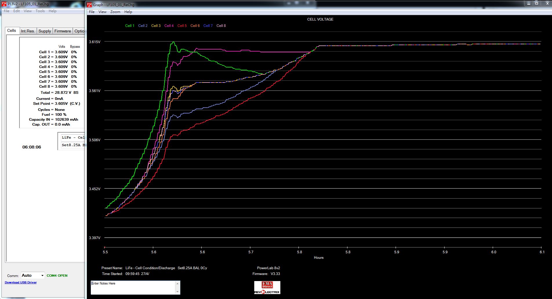

Postby shirley_hkg » 27 Apr 2019, 09:22
Put back less than 103Ah. :fencing drunk2
102.639 Ah.

Postby shirley_hkg » 27 Apr 2019, 14:37
Recharge graph looks solid as a rock . :clap: cheers

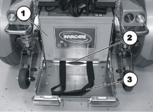

@shirley_hkg is there any chance you can give me the over all dimensions of your battery pack? It might give us a better idea of what chairs it will fit.
I'm using a storm 4 X-plore.
And if you will be going to the trouble of getting some for users how much would it be for eight delivered to the UK?

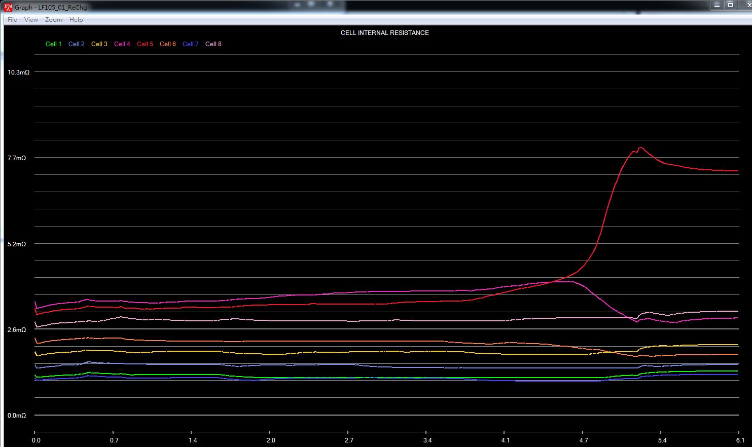

Postby shirley_hkg » 28 Apr 2019, 14:14
Second half of a 2P8S pack. Cell #2 is the weakest . Bucket effect allows only 99.615 Ah only.
Draied all cell to their 3.00V , to record their actual capacities.
Cell #1. 99615 + 1350 = 100965
Cell #2. 99615 + 0457 = 100072
Cell #3. 99615 + 0860 = 100475
Cell #4. 99615 + 0965 = 100580
Cell #5. 99615 + 0794 = 100409
Cell #6. 99615 + 0765 = 100380
Cell #7. 99615 + 0742 = 100357
Cell #8. 99615 + 1168 = 100783
Two halves are close actually,except that cell #2 .

You shouldn't get 8 cells . Go get 16 of them.
BM owned a Storm4 X-plore once , so he knew it well. I didn't.
He said it can take 16 cells plus insulation. cheers

Postby Dan » 28 Apr 2019, 15:32
shirley_hkg wrote:My pack hasn't completed yet. drunk2
I would take 16 if I can get them to fit :dance Unfortunately I have to wait until I can get someone to measure its battery box but it looking a little tight.

Postby Burgerman » 28 Apr 2019, 21:35
Not sure it can. It would be very very tight. That batt compartment is exactly the right size for 2x MK.
