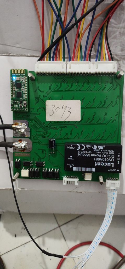

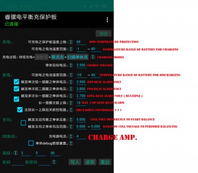

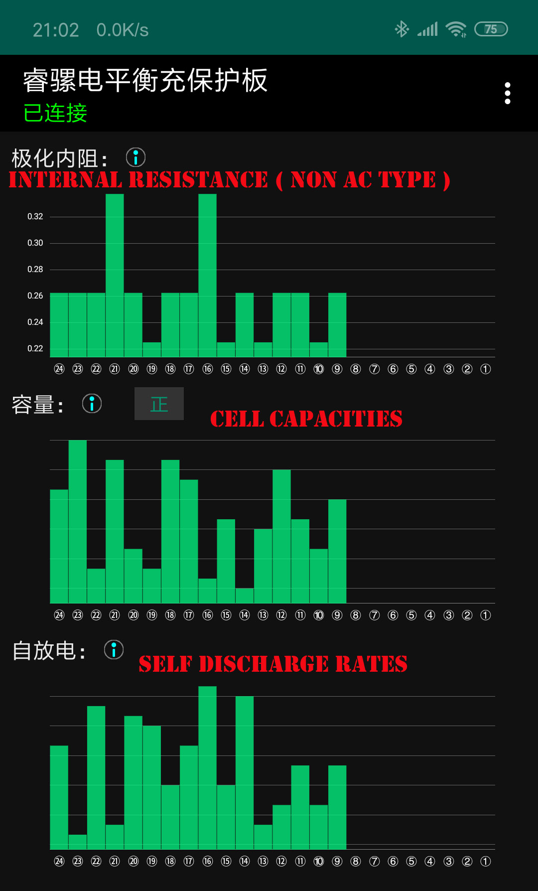

Postby shirley_hkg » 02 May 2019, 15:21
The first BMS I knew that controls the charging current .@50A max.
Direct output. Instead of cutting output, it has three alarms to inform user battery states.
BT connect to cell phone , and to program the BMS.
Individual cell scaning and balance @2A.
Many more , till I look into it later.
Postby Burgerman » 02 May 2019, 15:40
Again, wrong thing. In wrong place. Asking wrong questions if that phone screenshot is part of it. But as always the devil is in the details that we will never know! Does it proportionally balance, stay below the correct CV voltage per cell, and throttle the charger? Not ON/OFF?
Postby shirley_hkg » 02 May 2019, 23:38
Yes , throttle the charger amp , so no more ON /OFF.
Postby Burgerman » 02 May 2019, 23:42
How?
