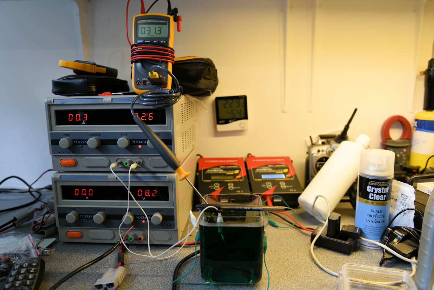

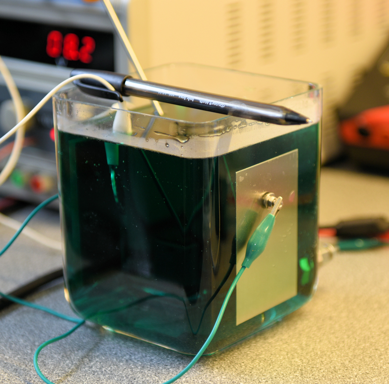

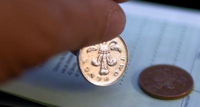

Heres my attempt at nickel plating. My first attempt and TOTAL settings guess! :fencing
2.7V actually 3.0v but limited by the Amps set to 0.3A. Turns out this is too high, it plated in seconds.
I tried plating a coin and ignoring all the acid bath cleaners, and distilled deionised water baths etc.
I simply cleaned it with washing up soap, as used for dishes, with scotchgbright cloth. For all of 15 secs...
Then straight in the plating bath, after a rinse under the tap. And no gloves, handled by fingers etc. Everything wrong!
So power on for 30 seconds, and at 30C (too cold by all accounts, needs to be 50C? But I have no patience!).
Its super shiny, and totally covered, and its so easy. I dont know what the fuss is about.
Now all my money will be worth more and shinier than other normal peoples money... :clap :admirer
FIRST EVER ATTEMPT, 1 WEEK BACK.
Nickel plated copper coin.

Obviously, the plating is not intended for my money! That was a test. But to nickel plate any copper, brass or steel parts. So that they have a shiny chrome like plating that prevents oxydation and looks pretty. Every washer, bolt and nut, or part for hobby stuff. For instance I have a new chinese hit and miss engine on the way. The brass parts will go brown and oxydise. The steel crankshaft will rust. So I will bright nickel plate all those parts.
Theres many coatings.
You can cote in copper easily. But it goes blue and is soon covered in a mass of blue powder. Copper oxide..
You can cote in zinc or a zinc yellow passivate. But it soon goes black and dull.
You can coat in silver or gold. But its soft, and wears off easily. And its $$$$$$$ to do.
You can cote in cadnium. But its not bright, and it dulls fast.
You can cote in chrome. Many chemicals, and its all harmful acids and many baths. And its not easy to do at home.
OR you can plate it in NICKEL which stays silver/grey and looks similar to chrome but is less blue.
You can also do BRIGHT NICKEL by adding a few extra chemicals that make it look very shiny, or by buying the whole green electrolyte in a bottle ready to use. Its harder wearing than zinc, etc and is good for electrical parts and so on. The other advantage is that its stupidly easy!

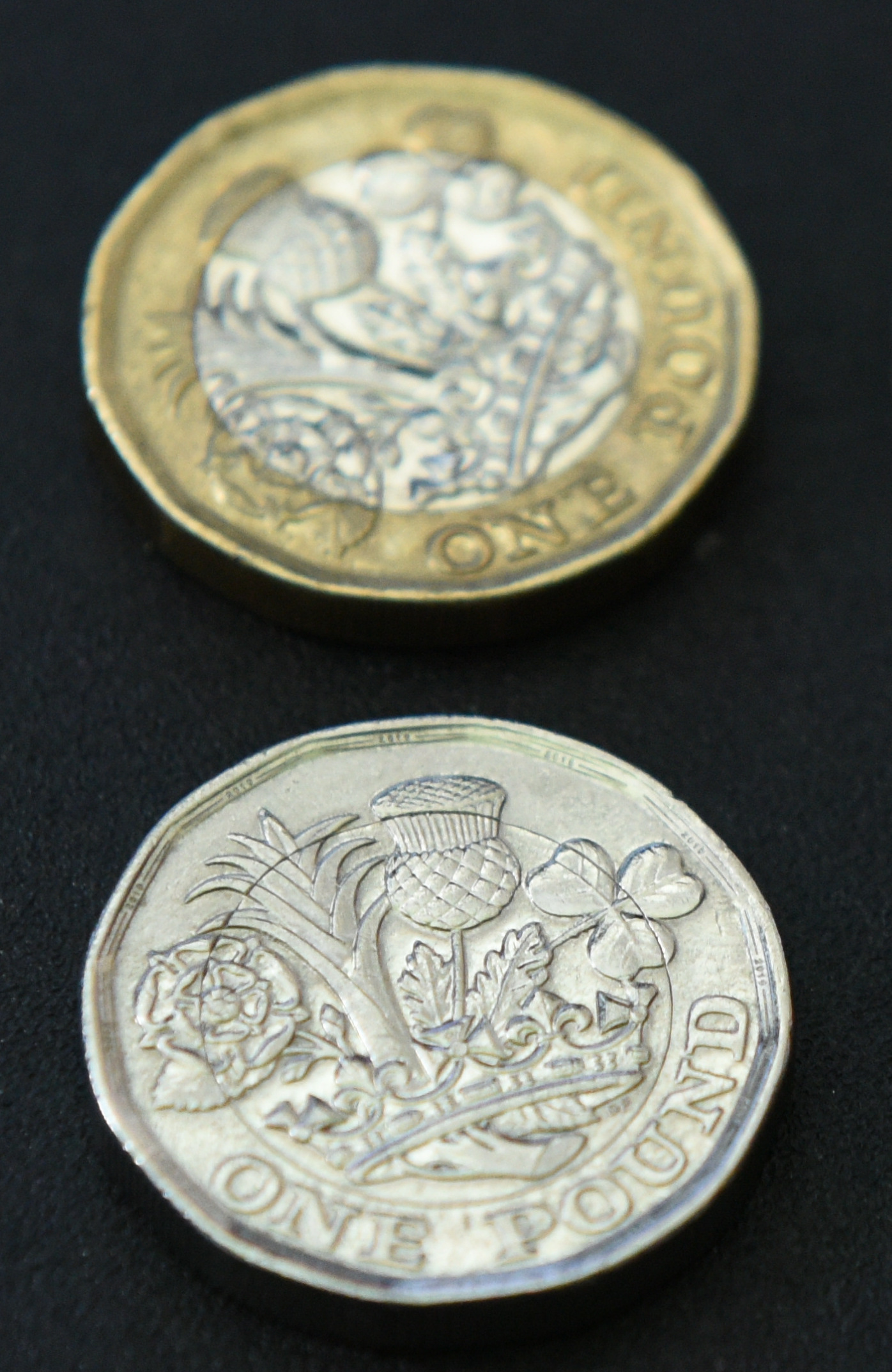

Dont like 2 tone pound coins. Mine are all now nickel...
Posts: 71101
Postby Burgerman » 08 Jul 2019, 08:44
I am not defacing it, I am improving it! :fencing
Yes in theory. In practice it will never happen.

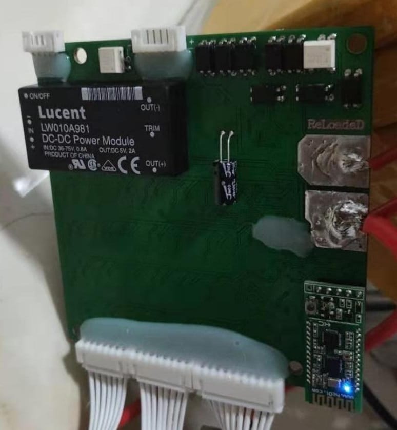

This new breed of BMS I mentioned earilier in page 162 , is available now. I need to change the power module to a 18Vdc---36Vdc , 5V / 5A one for our application.
Which model will fit ?

Lenny , it's a BMS for dumb chargers .
It runs on 5V from your pack, via an isolated step-down module .
It can do 1S --- 24S.
It doesn't control the discharge, so no unexpected power cut . It has 3 alarms to warn you low cell volts . You can set it to disconnect output after the third alarm sounded.
It has bluetooth communication with cellphone , displaying cell voltages and beep.
It doesn't drain the highest cells during balance .
It has 4 charge states (can be disabled seperately) :
1, bulk charge ,
2, absorption with full throttle . On /off , like usual , to let the highest cell is nearly full till it can't accept more.
3, absorption further for the highest cell "via controlling the charge rate" , so no more ON /OFF.
4, it starts to scan all cells , and charge the LOWEST CELL INDIVIDUALLY @2A max, one at a time. You program it when to stop, say within certain voltage drop.
It can take 50A charging .
It costs ≤ £30, and measures 100 X 100 X 20.
I need to change the Lucent LW010A981 to a 24V model . Any recommendation ?
HOW? Most chargers will not respond well to being controlled and will try to correct the voltage from increasing as the load falls, by reducing current, and then think its time to switch to float... Or end the charge at around 1A. So I cant see how this is possible. Charge will end when the "charge is controlled" at the BMS before the cells get balanced. I can see how it could work with a power supply, but not a generic charger. Because it will turn off!
By using battery power or charger power?
Because without the charger, which will turn off, you can only balance the pack below 3.6V. And as soon as it falls below 3.5V balance doesent work. So pack will stay unbalanced... You cant balance a LiFePO4 using its own power. That could work on lithium ion, or on lipo. Not on lifepo4. Because 3.45 to 3.6v is under 1 percent of capacity. So I remain unconvinced! :fencing
Posts: 71101
Postby shirley_hkg » 11 Jul 2019, 07:24
:thumbup: Good questions. I will raise them there . May be a power supply is more appropriate . cheers
Posts: 4657
Postby Burgerman » 11 Jul 2019, 09:20
I suspect the only way. But then, what determines end of charge? Ideally it should be: Once all cells are balanced to cery low current of say 3mA, around 3.55 to 3.6V, and only when CV current is at approx 300thC. What determines end point?
