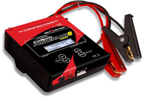

Postby steves1977uk » 21 Jul 2019, 16:18
Scooterman wrote:
Burgerman wrote:Its exactly the same with the lid off. Bar a different voltage capacitor on the input and its firmware.
Did they have problems with version 1?
Here's a PL8 v1 which could be upgraded to v2 firmware, no idea if v3.33 would work on it.

Postby Burgerman » 21 Jul 2019, 17:10
Theres no difference between the 2 electrically. Only a firmware update to allow more power.
Posts: 70444
Postby Burgerman » 21 Jul 2019, 17:12
Upgrade to 3.33
