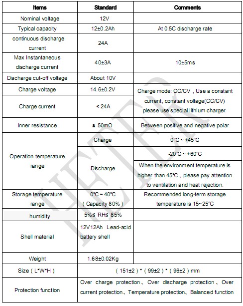

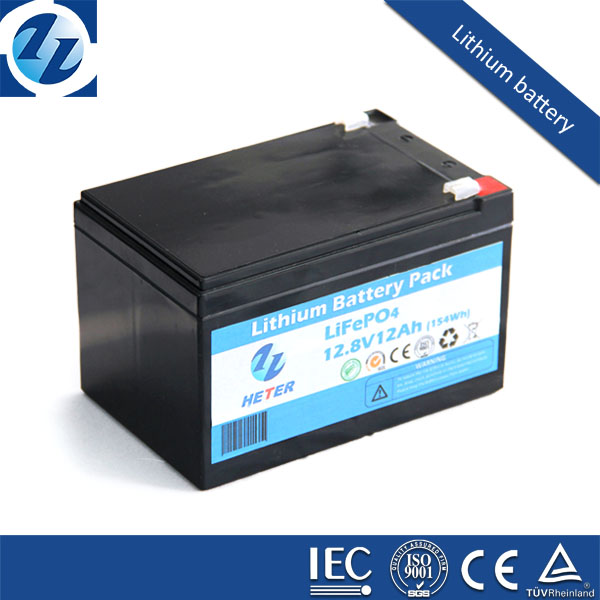

Hi to All.
I want to create add on pack to my Permobil C500S wheelchair.
Now I have 70 Ah EverExceed 1270 AGM batteries.
I have a few questions.
1. Can I use these LiFePO4 batteries? 4 units connected 2x2, 24 Ah.
LiFePO4-battery-pack Heter12V12Ah
LiFePO4-battery-pack-tech-spec
2. Where have I connect the pack to? Main batteries connectors?
3. Can I use my ProMariner ProSport 12 charger for both - main batteries and the pack? Now it in AGM 14.6V mode.
Thanks.
quadcopter
Posts: 124
Joined: 04 Jul 2016, 21:32
Re: PINNED - ADD ON PACK Step By Step 30ah Pack build / pict
Postby Burgerman » 18 Sep 2018, 12:34
They are physically big for the Ah they will give you. You are swapping 2x lead,12Ah size for lithium thats only 12Ah as well. One of the advantages of ithium is it has higher energy density so you can get more Ah into the same volume. So no gain here... So physically large for its capacity.
And they contain stupid problematic BMS (4 of them!) so I wish you much luck, and you may well have reliability issues and will have a short service but at least that wont stop the chair as you try to climb a ramp or something as the lead will take over. Takes up much space for small Ah compared to something like expresso uses. You can build a better setup thats more compact, for less money too.
You just need to add an anderson or other connector to the 24V system on your chair to connect to.

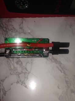

Postby ex-Gooserider » 09 Oct 2018, 00:04
Another BIG problem that I'm sort of surprised that BM didn't pick up on - if you look at the spec chart, it says the MAXIMUM peak discharge is only 40A.... Given that the controllers in our chairs can pull MUCH higher currents when turning or other high load situations, you are likely to either damage the batteries, or (more likely) have the BMS in them shut you down every time you try doing anything that draws a high current....
I also notice a 50mOhm internal resistance spec - that is disgustingly high even by lead brick standards.... IOW big voltage drops as the current draw goes up - potentially leading to controller problems at worst, and poor performance at best...
This is a pretty typical set of issues that we see in almost every 'one piece' lithium replacement battery.... It is WHY we consistently tell people to build their own packs - without a BMS....

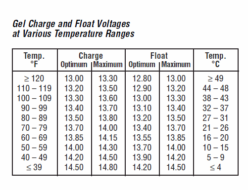

Postby BugBayMx » 09 Nov 2018, 04:27

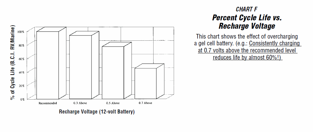

Postby Burgerman » 09 Nov 2018, 11:05
Hi, I have mk gel battery, what care should I have to prolong your life ?
Wrong thread, but:

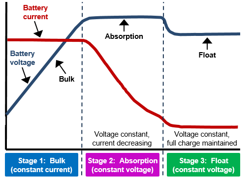

MK gel, CYCLIC use:
Charge at up to 24A ideally, but limit to 12A via XLR connector IN CC STAGE (called BULK by ignorant people!).
CV stage (called Absorption by ignorant people) at 25 centigrade battery, 20C room, for healthy newish battery, 28.00 to 28.20V max until 8 hours, or current falls to 1000th of capacity , so 70mA on a 70Ah battery. Whichever occurs sooner. No float needed. Limit to 4 hours CV for a light discharge or top up.
Or terminate at .4A to .5A and 27.0V float. (Slower).
The above is the best you can do without a laboratory!
Heres the tech spec sheet.
http://www.wheelchairdriver.com/MK1.pdf
Heres what happens if voltage is just a tiny bit too high... Study carefully.
Posts: 71106

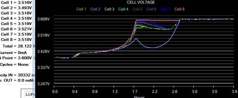

Postby Dan » 14 Dec 2018, 20:20
Just charged my little pack up after its been sitting for about a year. It started of stored about 85% capacity.
Down to 27V
Dan
Posts: 577
Joined: 10 Nov 2011, 03:03
Location: Northern Ireland
Postby Burgerman » 14 Dec 2018, 21:53
Cell grp 2 has a little higher self discharge than the rest, but after a year thats not bad. Although a 100mA BMS would have needed about a week to straighten that out... But a 1A balance does it reasonably quick.

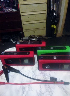

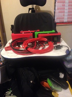

Postby Mechniki » 14 Jan 2019, 16:06
guess where this is going
Sorry for not posting for a long time i'm a lot lazier these days

Postby Mechniki » 14 Jan 2019, 16:12
12,000mAh +12Ah per pack, still waiting on XT90 connectors and anderson connectors

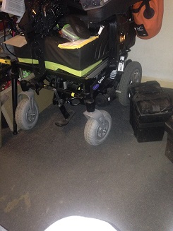

Postby Mechniki » 14 Jan 2019, 16:24
Hoping to put pack on the chair I am currently sitting in (not the old one of the same model) behind the casters, below the seat. Bought Battery jump starters from Amazon, 12Ah, £35 for the first one, which was damaged, couldn't plug the booster lead in. Got a free replacement. Second booster was £46, Third booster was also £46, ended up with 4 boosters. I just want to make an emergency add on. This chair has already had new 55Ah AGM batteries as the previous new ones failed after 5 months, and these new ones (warranty replacement) have already started to fail @ 6miles, cold not helping. I was also intending to put bug eyed 3w LED fog lights on, using one of the boosters as the power source.
Postby Burgerman » 14 Jan 2019, 16:32
Boosters?
As in 3S Lipo fire hazards? Those wont work well. They are 25V fully charged, but drop fast. Your chair stops about 23.5 to 24v. So you will only be able to use about half the capacity or a little less. You need 7S for 24V systems. Try it. Your battery meter will tell you its dead at about 2/3rds charged. Other issue is that they only do a few hundred cycles. OK for emergency, but not regular use.
Posts: 71106
Postby Mechniki » 14 Jan 2019, 17:00
shouldn't half the capacity still be able to accomplish half a mile of gradual hill. I lose a green light on the controller at the bottom of Horsham Road Junction South Street, Dorking, then before the 1/4 of a mile of hill I have lost all the lights, Turn off, wait a little bit, go a little bit further, then repeat. At the top of the Horsham Road (Flint Hill) it's all down hill from there, and even in limp mode I can get home. But at that point the tiniest obstacle.
So would my jump starters actually blow up?
Thanks for being very quick BM
Mechniki
Posts: 272
Joined: 22 Oct 2013, 21:59
Location: Dorking, Surrey
Postby Burgerman » 14 Jan 2019, 17:07
No, but they wont help much. Voltage too low. They are nominal 3.7v per cell. Thats half way between empty and full. So 3.7V x 6 is 22.2V. And your chair stops rolling before this. So you will gain about 6Ah total usble. So about 2 miles extra at a guess?
You would have done much better to build a real ADDON, with 8 LIFE cells, or say 2x or 4x hobby king 8400mah life packs, or just bought some decent lead batteries. Although they may help a tiny bit with hills.
