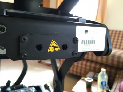

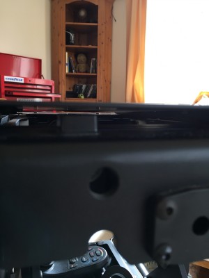

Postby Scooterman » 30 Mar 2018, 12:08

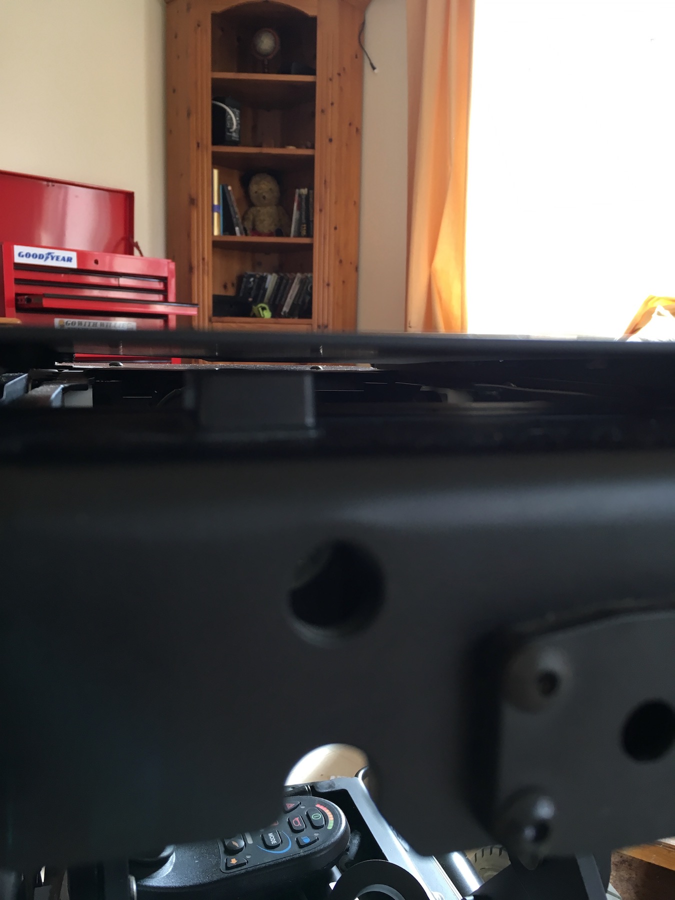

When tilt is down should seat plate rest on bump stops? It doesn't, sits a few mm above.
Is it adjusted with these recessed allen bolts?
Or is safer alternative to fit thicker bump stops? (don't want to screw up mechanism not knowing what adjustment screw does what)

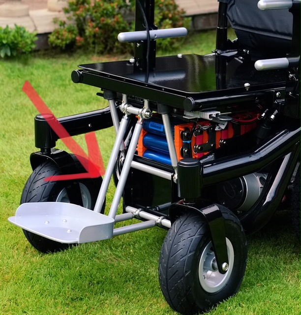

Postby Scooterman » 30 Mar 2018, 13:32
Hi BM, please can you tell me what these adjustable length rods are called? I've searched tie rods but only get hits for motor vehicle parts. I was hoping I might be able to find some of a similar type on eBay.
Postby foghornleghorn » 30 Mar 2018, 13:39
The adjustable end is a rose joint.
Posts: 710
Postby Scooterman » 30 Mar 2018, 13:46
foghornleghorn wrote:The adjustable end is a rose joint.
Many thanks. I now just need to find out what the internally threaded rod is called.
Postby Burgerman » 30 Mar 2018, 13:47
And the bars are 14 or 15 mm alloy bar...
https://www.ebay.co.uk/itm/Round-Bar-Ro ... oY5XgtvA0A
Posts: 70778
Postby Scooterman » 30 Mar 2018, 13:53
Burgerman wrote:And the bars are 14 or 15 mm alloy bar...
I see, many thanks for the link :thumbup:
EDIT: That's especially handy because rod can be cut to make adjustable bars of any length (within reason).
Postby Burgerman » 30 Mar 2018, 14:20
I buy 3 meter lengths. Usually 15mm or 16mm. If you want fancy, use carbon fibre bar...

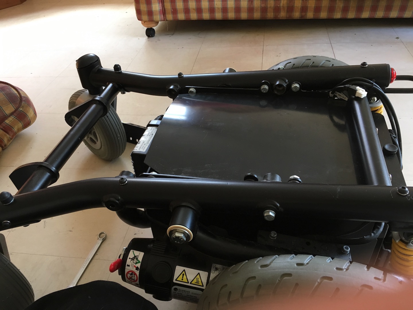

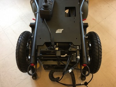

Re: the salsa and dump. I managed to drill the lugs today. But I found it too difficult to drill through the frame while sat on the floor. So I removed the T/E unit and drilled the lugs on the work bench. Also with the T/E unit removed I took a couple of new photos and more accurate w x h x d measurements of the battery compartment. I'll post them tomorrow.
One other reason I removed the T/E unit was that I wanted to see how easy it would be to fit a static seat pan at a later date. The T/E unit weighs a ton, I don't know how much but I plan to weigh it on the bathroom scales before re-installing it.
One thing I notice though was that once the T/E unit was disconnected (unplugging three connectors) then the chair wouldn't drive. The joystick battery indicator lights just kept on blinking on and off. This might cause me a problem at a later date if I decide to go down the weight saving route and ditch the T/E unit? But I'm sure BM, or another WD member will have a solution for me. :)
Postby Burgerman » 31 Mar 2018, 22:40
The solution is programming.
Graphite grease will be OK. If a little messy. Dont use it on bearings.
If you weigh all the power footrest and backrest actuators and linkages, the seat mountings, lift and tilt module, extra electronics etc you will see it adds 50 to 70kg... :cussing

Funny you say about weight. When the chair is stripped down this far it doesn't look too heavy. While sat on the floor I even tried lifting one side although I couldn't manage it. Although I would imagine you could tilt it up once it is stripped down this far. NB: I will be removing the suicide bar, I'm just leaving it for the moment because it's a handy jacking point for front castors.

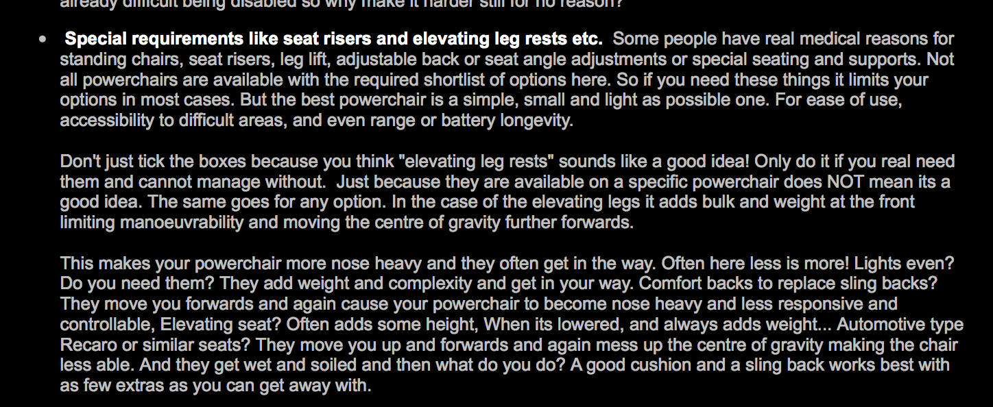

I going reinstall everything on the chair apart from the reclining backrest and suicide bar. Then using the chair I will get a good idea of what I need from a powerchair. I'm mindful of what you wrote here:

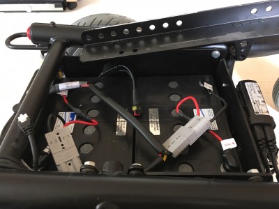

Postby Scooterman » 01 Apr 2018, 10:55
Length 350mm
Width 265mm
Height 238mm
Height is tricky to measure. The more dump the more the rear end of rail encroaches into battery compartment. If rail and rear cross tube are avoided, then bags of room.
Postby Burgerman » 01 Apr 2018, 11:22
The limiting part is that horizontal bar across the rear, at te top, where the battery slides in and out. What is the measurement from the floor where the battery sits, to the underside of that bar?
I intend adding a 6mm or 8mm steel plate to the bottom of this too. For stability/cg purposes. And to add my tie down bolt.

Postby ICEUK » 01 Apr 2018, 11:24
Your going to remove the cross member on the front of the.chair which you call sucide bar? I dont understand why or i may have missed something
ICEUK
Posts: 580
Joined: 27 Apr 2013, 11:51
Postby Burgerman » 01 Apr 2018, 11:31
Its just a mounting for the curb climber thing that hits stuff and throws you out at 6mph if you are not careful about what it hits. So mines is long gone on all my chairs, the one in the pic above is just a remnant!
Although I may make a rose joint/alloy bar version if it adds frame strength. Not sure it does tough.

Postby Scooterman » 01 Apr 2018, 14:58
Burgerman wrote:The limiting part is that horizontal bar across the rear, at te top, where the battery slides in and out. What is the measurement from the floor where the battery sits, to the underside of that bar?
The height measurement is the to underside of the cross tube give or take a millimetre or two. Sorry it’s not more precise, it’s a bit tricky measuring with the batteries in situ and the chair on the floor. While sat in my manual chair I can’t get my head down low enough to see the underside of the tube. L and W are easy and spot on.
Postby Burgerman » 01 Apr 2018, 15:18
So 135?
If so will order a set of 100Ah Sinopoly, plus 7 bus bars. And a 8mm thick steel plate that measures 340 x 260mm for mass correction.
