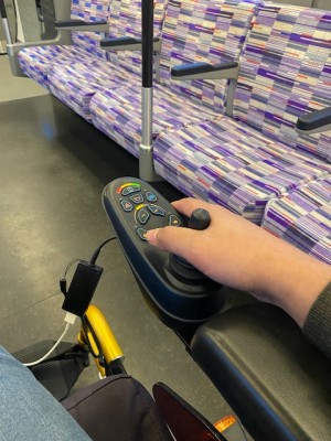

Postby MarkFox » 24 Mar 2021, 14:56
Mine is usually as shown in the attached picture, and I can steer with pinpoint accuracy. I'll make slight variations to accommodate muscle issues on rare occasions, but this is what works 99% of the time. (Here I was using an empty train carriage as an obstacle course to test my new control settings on a new control module)
It's like handwriting - everyone holds pens/pencils slightly differently, but there's multiple ways to have good handwriting. Ditto driving a car, people adjust to what's comfortable and safest for the combination of their body and the car's design.

Postby Burgerman » 24 Mar 2021, 15:17
Watch my hand only! The vid was demonstrating turn acceleration/deceleration, ignore that for now!
http://www.wheelchairdriver.com/gopro/control.mp4 The palm + forefingers is the reference position. THIS is what matters. plus no wobbly control pods wobbly arms, or incorrect pod height etc. Yours appears a little low to me. And no gap between arm top and joystick. Arm top alone needs moving back, to give a gap if joystick remains in the correct place?
Postby MarkFox » 24 Mar 2021, 15:28
Burgerman wrote:Watch my hand only! The vid was demonstrating turn acceleration/deceleration, ignore that for now!
I've watched that video - as I said in my previous post, if I followed your positioning it'd lead to my joints locking in dangerous way, and once they lock it's a trip to the hospital & IV muscle relaxants to fix it.
The pod is stable, my arm is rock stable relative to the pod and in the most natural position for my joints, and I can control the chair accurately at both high speed, and in tight environments.

Postby Burgerman » 24 Mar 2021, 15:30
I didnt post for you really,, just for others to show importance. I see most people while out and about steering like its a pudding.

Postby biscuit » 28 Mar 2021, 10:53
Thanks for the photo, Mark. That's the way I hold the joystick too, also with the js in the crook of my thumb. This way does not bend the wrists, keeps the hand relaxed (not dancing all over) yet steady, and as you say steering is pinpoint accurate.
Different ways for different people.
