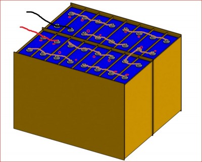

Here is a mock up of a 16 cell 210Ah pack using the Shirley cells. Wired 8S2P
Worst case dimensions, allowing for tolerances & using 0.5mm polycarbonate sheet insulation, are 302.1 L x 262.5 W x 208 H (inc M4 allen bolt heads and 2 x ring terminal). Compare that with 2 x MK 74Ah gel with spacers as per LH Puma diagram below is 352 L x 270 W x 210 H (inc M6 allen bolt head and ring terminal)

Postby Irving » 03 Sep 2019, 20:20
Wiring:

Postby Irving » 04 Sep 2019, 15:01
An alternative, and arguably neater, wiring scheme.

Postby Irving » 04 Sep 2019, 15:24
Here's one that replicates standard Puma wiring layout
edit: forgot to show the cell + poles but its not hard to work out.

Irving wrote:An alternative, and arguably neater, wiring scheme.
Basically you are putting two cells in parallel to make one 3V cell than put 4 of those in series to give you a 12V battery. Do the same with the other cells and you than have two identical 12V batteries which you then put in series. Giving you your 24V.

James,
Are they these ones?
https://m.aliexpress.com/item/33054219276.html
In a 8s2p configuration that's 210A continuous, 600A pulse. Which should be fine.
Today's Ali express price delivered is £1128 for 16 cells so if that's for 18 that's a good price (£1178 @ MasterCard fx rate) but check your conversion rate us$ to gbp. Better to get vendor to quote in gbp.
