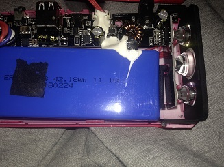

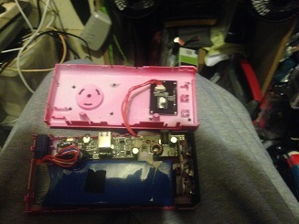

Postby Mechniki » 14 Jan 2019, 22:09
iphone5b 037.jpg (45.39 KiB) Viewed 51943 times
iphone5b 052.jpg (56.97 KiB) Viewed 51943 times
So in theory I could just change the Lipo for lithium ion for a better result? cheaper too

Postby ex-Gooserider » 15 Jan 2019, 01:40
NO!!!! Different battery chemistry, different voltages etc. so you would have MAJOR problems if you just tried to swap out the LiPo cells for LiFePO4 cells....
You would be much better off to pass those boosters to someone else, and build a proper LiFePO4 based add-on or just do a total conversion, with a PL8 charger and so on as described earlier in this thread...

Postby Burgerman » 15 Jan 2019, 01:48
And buy new lead batteries that are both high quality and charge correctly.

ex-Gooserider wrote:NO!!!! Different battery chemistry, different voltages etc. so you would have MAJOR problems if you just tried to swap out the LiPo cells for LiFePO4 cells....
i guess I don't understand it at all even with pictures, charts, diagrams. If the voltage is the same. 3 x 3.7v = 11.1 the only difference is amps, and if the specified amperes are the same, why wouldn't it work. The device would use the same charger except the new batteries wouldn't blow up. Or could they
When things are over complicated I need to see, physically see to duplicate. Not everyone can afford to do this stuff. I cannot buy the right lithium batteries
right now, and even if I did buy the right batteries, how would I know they were the right batteries. Many batteries look very similar. If it says on the label they are LiFePO4 but they're not? Or in the case of the ones I was looking at, there's no label to suggest they are actually LiFePO4
Thanks for trying

Postby Burgerman » 15 Jan 2019, 17:55
You are confusing 3 different chemistries.
Lithium polymer, as you have now are good for really high currents so a small battery can start car or drive a chair, as both need up to 200A to do... Those are nominal 3.7V. They are USED from 3.6 to 4.2V and are damaged if higher or lower or can explode. These need 7 cells in series, not 6, so wont power your chair. 100 to 200 cycles. Or about 1 year in storage.
Lithium ion, as used in laptops, would be able to be charged in your car jump starters, but they still burn or explode. And while they have the same ish 3.6/3.7V nominal voltage they have a lower empty voltage so are used from 2.5V up to 4.2V and again you need 7S not 6. And they cant do high currents like your LiPo. So you would need about 70Ah to make any sense. 200 to 400 cycles, and about 2 years in storage.
Lithium ion phosphate, or LiFePO4 are safe, dont burn or explode, and also cant do big currents. So you really need about 90 to 200Ah ideally, or say 30Ah minimum to HELP your healthy quality lead batteries. And 8 in series. Not 6. They are 3.2 or 3.25 nominal volts. And are 3.600V charge. So your devices cant charge them. They also cant do big currents, and have 2000 cycles, and a 10 year calendar life.
Theres no cheap or easy safe way to do it.

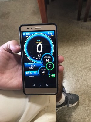

Postby Scooterman » 08 Feb 2019, 16:32
What's this app you're using called expresso?
Also does anyone know of any other decent speed, distance, avg speed, map route, etc Apps?
Must be available on iOS, me being an apple fanboy, not really :fencing

Postby Dan » 20 Apr 2019, 10:35
Another good side effect of the little add on pack is that it really perks the chair up or at least it does mine a brushless storm 4, top sped is up a little and its averaging almost 1MPH faster.
12 miles cruising around a seaside town. 12Ah returned to the lead Voltage on the 30Ah pack was down to 3.21V but 20Ah returned seems a little high?

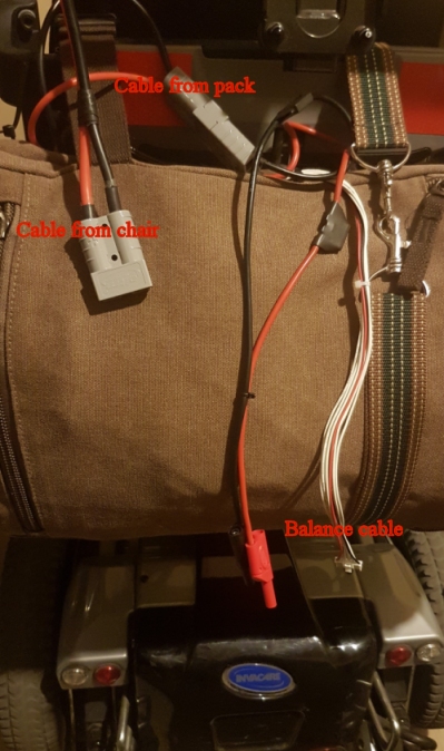

Postby Dan » 20 Apr 2019, 11:06
I'm using a 30Ah add on pack connected to my chairs lead battery. Hanging off the back of the chair.
After doing about 13 miles in the chair I charged the pack and the chairs batteries separately.
The lead batteries are fully charged after taking about 11A returned.
The add on pack is still charging with 21A put back into it.
The chair is taking a lot more out of the add on pack than its lead batteries.

Postby expresso » 20 Apr 2019, 15:40
You dont have to charge them separate - you can leave it all connected and charge from the ADD ON pack Charge Cable if you made one with the Subd ?
use a combined preset - i use - i have one chair with the same setup - only a 60Ah ADD ON - also you may not be fully charging those leads
are you using a dumb charger for the lead ? most likey wont be fully charging them correctly - you can make these easier if you leave them always connected and charge all together once with the pl8 -
you can also try adding a diode that is talked about - i have and it gained me a bit more mileage - you add it on the ADD On pack to slow down its discharge. they should discharge more evenly after -
if you feel its not enough for you - later on - add another 8 Cells - giving you 45ah ADD ON - i have done that also to use up the free space.

Postby Dan » 21 Apr 2019, 00:13
I lacked the dexterity to solder a Subd plug so kept it simple. Just a lead from the lead batteries terminating in a SB50. I have the same on the add on pack, just an SB50 on a cable from the plus and negative and a balance cable that plugs straight into the PL8.
When I charge the pack I just disconnect it from the chairs batteries then plug its SB50 into a cable with banana plugs at the other end for the PL8. Then plug the balance cables into the charger.
When its done charging I just plug it back into the chair and tuck the leads into the bag.
It works great apart from the chair draining the add on pack and not using much lead. If a diode would help what type should I try?

Postby Burgerman » 21 Apr 2019, 00:28
The two batteries work differently. You will use more lithium than lead. Because while both charge at the same overall voltage, the lead soon drops below that after you stop charging. And the lithium voltage will stay much the same for the first 50% of its charge. So you will not lose a green light for around 50 to 70% of the lithium battery range. From this point on, your lead and lithium will work together. With the lithium ending the trip at around 24.0V which coincides with about 2/3rds your battery gauge used up. And with a little lead remaining. Since the lead doesent like being discharged deeply and soon dies if you do that its OK this way. The lead battery will last years!
But to get ultimate range, and better match the two batteries, you can use the Low voltage drop diode I spent a while figuring out for expresso. But I dont remember which one it was. But expresso can help there as he will have made a note (I hope). It will still never mean that you will use the same amount of each in Ah though. Because the two discharge curves do not match. And are different to each other depending on load as well.
