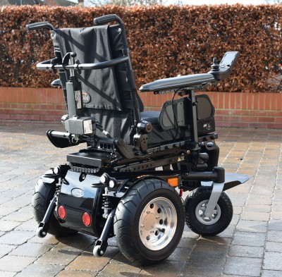

Postby Scooterman » 05 Apr 2018, 19:32
I wrapped one wheelarch today, but it wasn't very successful. I really really like the carbon fibre effect but my wrapping technique leaves a lot to be desired. The one wheelarch must have taken me a couple of hours :(
My first attempt with a single sheet was a disaster. The second time I did it in sections but there are a lot of wrinkles and air bubbles. But imo it looks better than the Sunrise Blue. I'm not looking forward to doing the other two panels as it is really difficult to do. :thumbdown:

Postby Scooterman » 05 Apr 2018, 20:29
Burgerman wrote:Sadly, after doing a lot of this stuff, and on bikes, for 40 years I knew that this would be the result. But nobody likes a "told you so" so I wont mention it! Even though I alreadty did when you said you were going to do this! :oops: :shh:
Postby Burgerman » Mon Mar 26, 2018 3:39 pm
At a guess, all wrinkly, and not stuck well. And you will wish it was painted gloss black!
10 days ago... Dont worry. Bung a spray shop 30 quid and they will do it in a nice slightly metalic black with 2 pack laquer. :ak47
Also, those wheel spacers are available in 8, or 12mm should you need them.
When you told me last week that it would end in disaster I didn't mind in the least, it made me laugh. But I was determined to prove you wrong, how wrong was I! :oops: Lol :D
Even though I must be glutton for punishment I'm going to wrap the other two panels. Afterall I've bought the wrap now! But once the chair is up and running I will seriously consider getting the panels sprayed as you suggest.
