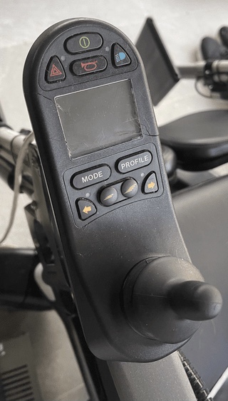

Is this a R-Net controller?

Postby Burgerman » 16 Sep 2021, 13:10
It is. Theres several.
https://www.cw-industrialgroup.com/Prod ... ions/R-net have a browse...

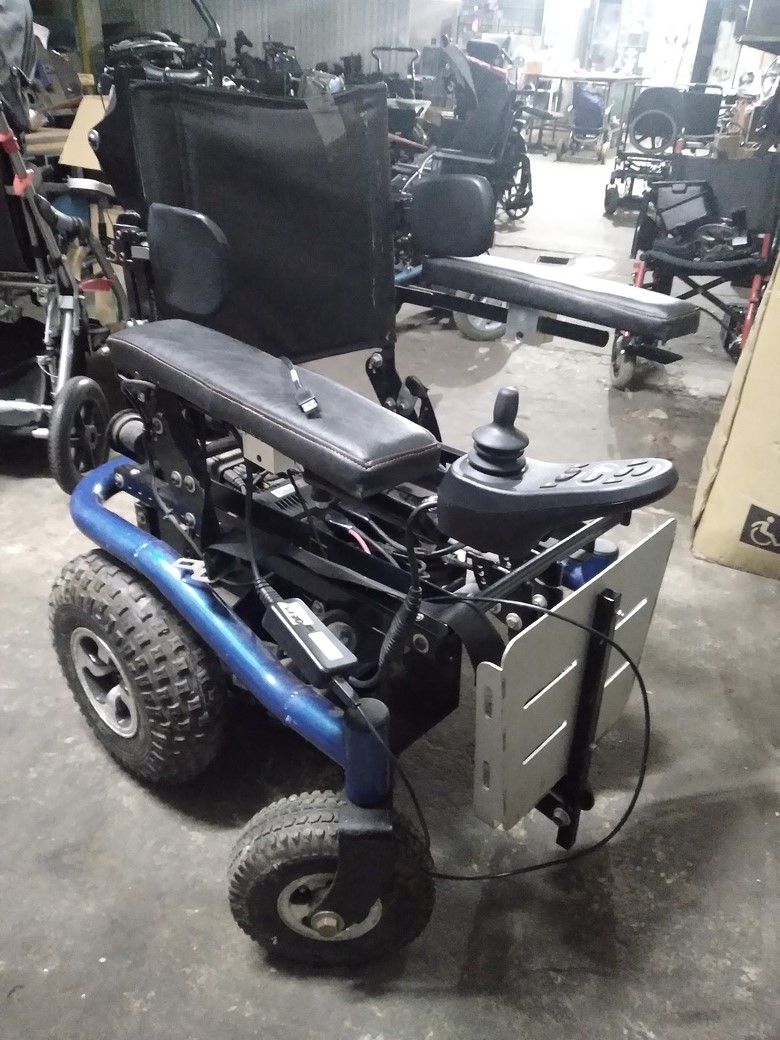

Postby REPARACIÓN SILLAS » 10 Oct 2021, 22:23
Good afternoon dear forum, I am programming and at the same time learning an armchair assembled out of series with an R-Net led equipment and D50903.12 controller with my old pc and we got the OEM and DEALER dongles that it cost us to find 2 years ... I appreciate to each and every one of you what we learn is infinite. We are trying to vary the turning speeds to a minimum since as they are, it is not possible to drive.

Yes dear Burgerman, we are trying to minimize turn speeds and increase forward ground speed. The chair is an out-of-the-box copy that someone else made.

I am well guided by you and the oem dongle that we acquired for the chair is similar to the one at the beginning of this post (homemade here in Argentina)
DATA: engines AMT Typ: srg0111
24 volts 4000 / 153min-1 0.35kw 17A
R-net led joystick with light actuation and control, PG DRIVE R-net D50903.12 control board.

Postby REPARACIÓN SILLAS » 11 Oct 2021, 01:52
If I try to upload, but I think we do not have the permissions to upload photos, avatar, etc. We are testing since yesterday and we are very close to achieving the changes. We haven't been able to slow down tour speeds yet, though.

Postby REPARACIÓN SILLAS » 11 Oct 2021, 02:00
Rear wheel drive, without actuators, with light kit

Postby REPARACIÓN SILLAS » 13 Oct 2021, 22:08
Good evening, let me tell you that the chair worked very well with the parameters that we were changing, only if we position the front wheels of the chair in front of an edge and we want to raise it, THERE IS NO MOVEMENT, but if we make a small movement of the joystick towards any steering the chair overcomes the obstacle without problem. My question is: how should we regulate and what parameters so that this dead time disappears? THANK
