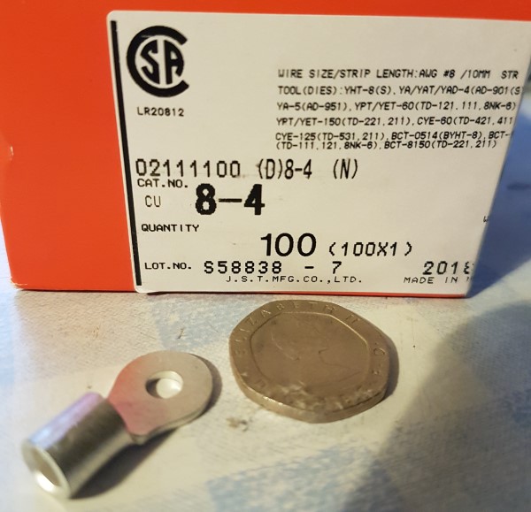

The new cells have arrived, finally!
They're to go in my Salsa R2 powerchair. They're a tad long to fitted in the battery comp' but I knew that and will need to make a new battery back plate out but that's easy enough, it's just a rectangle with two slightly bent flanges to gain a few more millimeters.
They were extremely well packaged, although one box looks like it was opened to inspect the contents?
I won't be using the busbars but they're not bad, quite thin and with a bit of flex. AND rather than screws they've supplied M6 studs flange locknuts and washers.
I've only unpacked and inspected one cell at the moment.
It looks brand new, the only caveat is the terminals, although the threads seem good.
After purchase I notice one or two reviews of the cells posted on the site and the buyers mentioned marks on the terminals, some even uploaded photos. I don't whether that means they're old cells, or the company/factory tests the cells, there's a 'tested passed' sticker on the cells and the milli-ohm rating. I guess the 3.29v means the voltage they were stored at prior to shipping? Whether they're tested NEW cells or tested OLD cells, I don't know, but if they were old I would have expected to see more marks on the outside of the cells. I check out the others later.

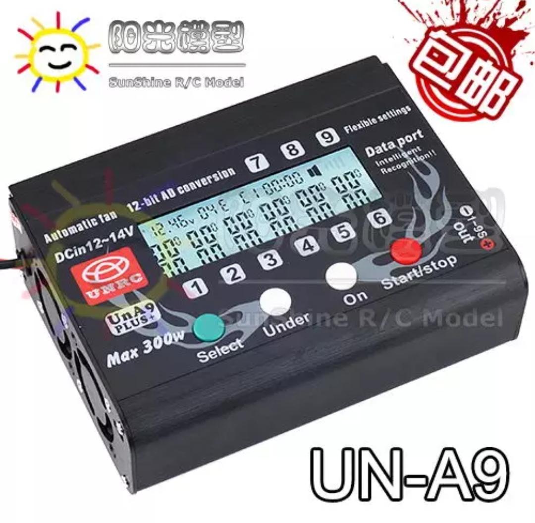

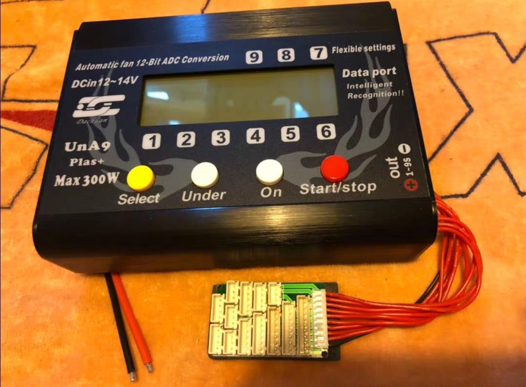

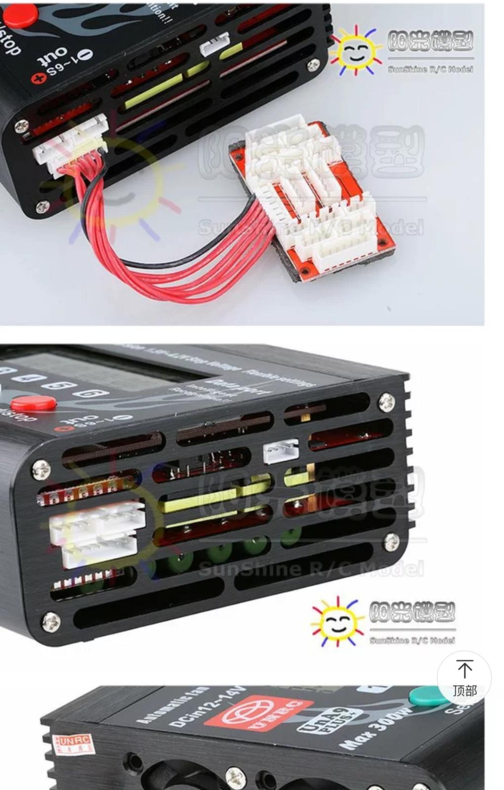

@LORBBINS, This genuine 9-channel charger may be more reliable and still easy to operate.
It can auto start as it sees a battery. Can also discharge @2.7A
May set all 32 memories with SAME volt & amp for foolproof .
UN-A9 can do 8A max (advise to add 1.00-1.25m㎡ balance leads from pcb direct, the 2.54XH plug is too weak)
In view of RACHI's low consumption , it can put back 60---70Ah overnight .
Powered from 12V @HKD $400.
