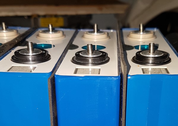

I hate complaining, but look at this! it's not been drilled square :cussing Not happy I've just sent them a snotty email.

Postby LROBBINS » 15 Feb 2020, 16:45
Steve,
That's lousy, but if you put a large flat washer on the stud and moderately tighten a nut, does it straighten out? This is probably a soft alloy (perhaps even 1000 series = pure aluminum and it may deform pretty readily. If it doesn't you'll never get really good electrical contact with canted studs.

Those are obviouly tapped or drilled by hand, by the apprentice...
They should at very least use a drill press.

Postby LROBBINS » 15 Feb 2020, 19:27
Steve,
Did you open a dispute on AliExpress? If it's still possible to do so I recommend it - if the seller turns out to be uncooperative, AliExpress will apply pressure that seems to work (at least for small items). Of course, if you paid the extra to use PayPal on AliExpress, you have that route as well.

I got my cells from BLS direct instead of using aliexpress because I like to have the safety of using PayPal so you can get your money back if there is an issue. Only one of mine is drilled and tapped slightly out of square and on that one yo could see that the drill point had wandered about before hitting the centre and drilling - not too bothered as it makes a good connection. What has really p"£$%^& me off though wasn't with my new cells but with my PL8 - I fought on making the wiring up nice and neatly and had it all complete and ready to do a balance charge and it tells me wrong number of cells. I fought on trying to find a dry solder joint, bad connection etc all day and in the end I cut everything apart again and started with just the balance wire that came with the PL8 - same problem - so I tried my other PL8 - still the same problem - breaks are in the flipping balance wire jst plug and I don't have a spare. So I'll take a couple of days off to calm down while the new cable arrives - why are they so hard to get hold of?

I might take a careful look at those and helicoil all of them. Very carefully and accurately. And loctite the helicoils in with the red stuff.
Depending od depth available.
