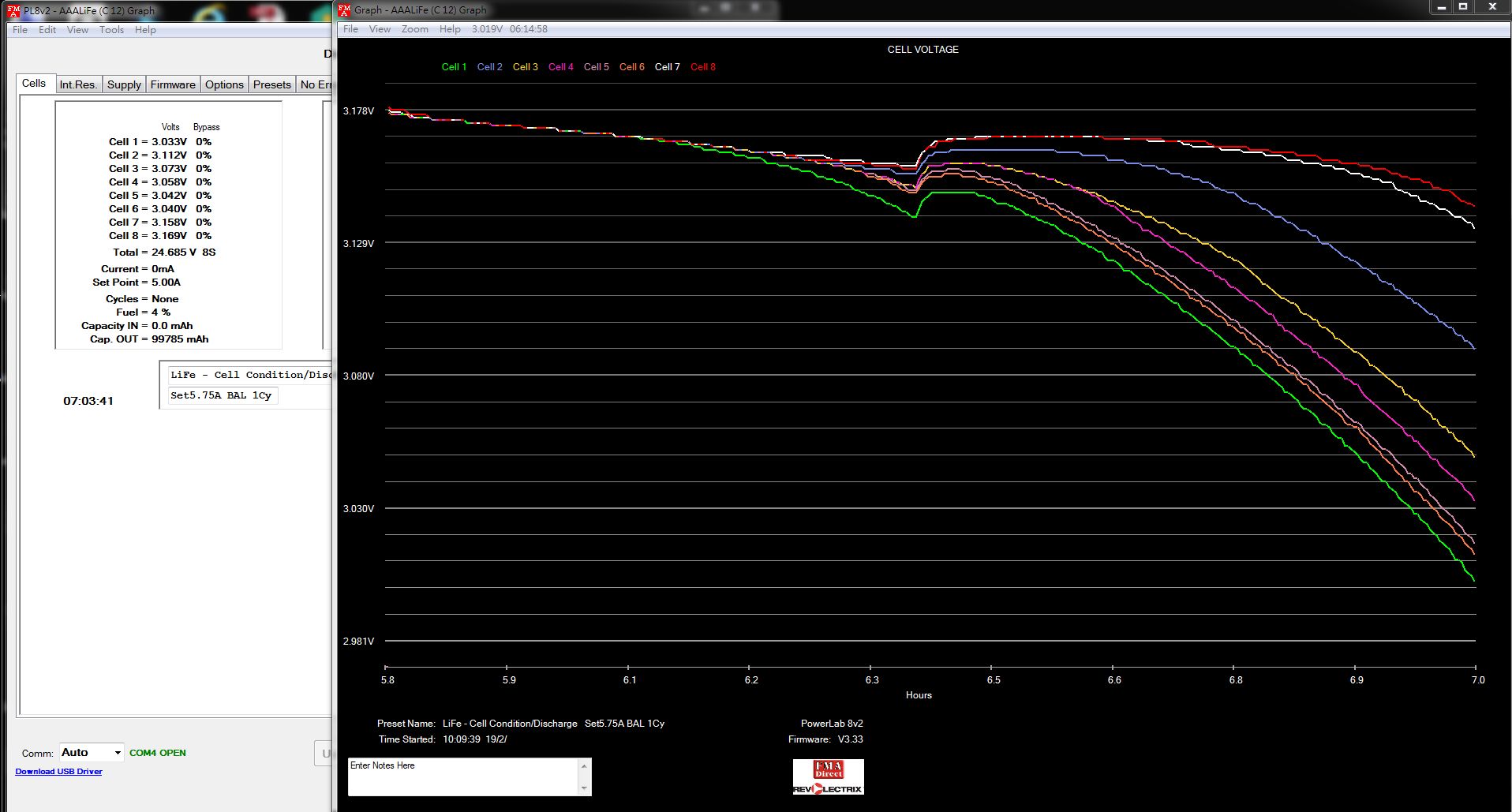

Postby shirley_hkg » 19 Feb 2020, 11:25
Ridiculous ! ! ! drunk2
Open the last box of the EVE-LF105 lot I bought in April 2019.
Damn. I found two cells at 2.957V & 1.3738V respectively. :fencing
I'm afraid that they were going to the bin, as stored at such low volts and prolong period.
I wouldn't throw them away without testing , would I ?
Charge them full, and did a discharge .
Very surprised to find that they are not damaged , but also the strongest 2 ( cell 7&8 ) among the them.
Besides , no significant increase in IR & self-discharge are noticed.
EVE-LF105 cells are good and robust. cheers
Ridiculous ! drunk2

Postby shirley_hkg » 19 Feb 2020, 11:36

Postby Burgerman » 19 Feb 2020, 11:54
2.95 I would expect to be OK.
1.37 i would expect has a high self discharge already as it was lower. But also now ruined. I am rather surprized/skeptical! I never got a cell to recover from seriously discharged...
Posts: 69921
Postby shirley_hkg » 19 Feb 2020, 13:40
Down to 3V , and voltages bounce up a bit after 20 minites.

Postby Burgerman » 19 Feb 2020, 13:49
Do a 2.9V discharge, but set CV discharge, and set termination to 400mA. And get a truer idea of capacity.
Posts: 69921
Postby shirley_hkg » 19 Feb 2020, 13:56
Using CV mode down to 3V to record capacities of each cell. :fencing
Kind of strange ! drunk2
Cell 7: 102852 mA , previously @ 2.957V cheers
Cell 8: 103024 mA , previously @1.3738V cheers
Posts: 4483
Postby Burgerman » 19 Feb 2020, 17:48
Because of resistance.
Posts: 69921
