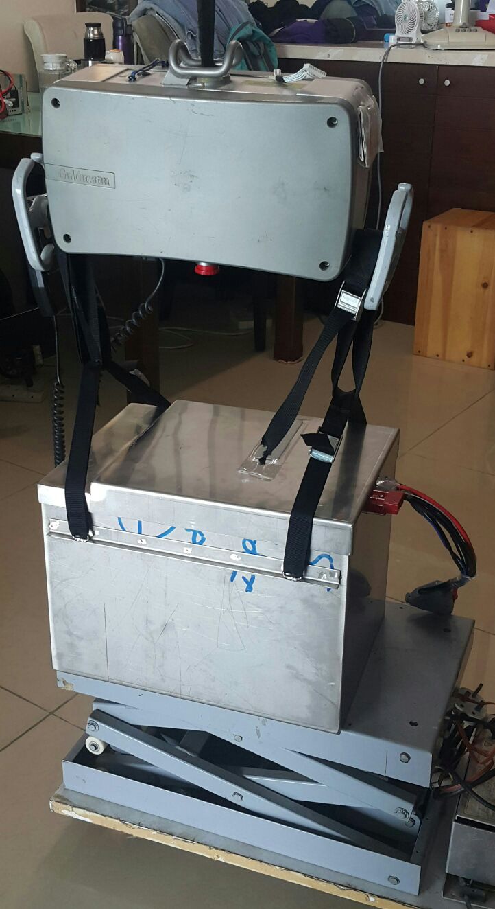

Postby expresso » 07 Mar 2018, 00:14
BM - i made the presets to charge from my chair to the other chair -
one preset is for charging the whole chair combined as one -
the other is just the ADD ON - if for some reason i needed to charge it fast
can you take a look at these presets - tell me if they are OK - or if i missed something
one thing i noticed - i have to pick the Supply i will be using the charger with - i cant pick battery power with one preset and DC power for another preset
so in my case - it would be best to check off battery power before heading out for the day if i may need to charge chair to chair ?
i set it to 35A charge rate - and 60A max out - i never used it past 35A charge - dont want to blow this thing up when i need it the most :)
Postby Burgerman » 07 Mar 2018, 00:55
Not looked yet. But its better to charge both together. Or when you reconnect the lithium will try and charge the lead... But you can do this way too. But theres a risk of blowing a fuse if you connect a full lithium to a dead lead.
My power supplies are set to bench for the ones sat on the bench, and battery for the ones in my van. But they will work if set to battery on your power supply too. And the other way around. You can just leave it set to power supply if you want. It will be fine. When set to battery it stops charging if the battery supply gets low etc. But you know that you will not be doing that, just a top up. So dont worry. Or just set to battery when you leave. It will work either way. As long as you set low voltage to say 23v or less. Mine are all set to 10. And 40A max input.
The only real danger is that when set to battery, you can also do regenerative discharge. Not at the internal 100w or 10A but at 1440 watts and 40A into the other battery if you wanted! But if you try this on sme power suplies they dont like it! hanged
Mine doesent care. But some are not protected against putting power in. So dont use the battery input setting on your power supplies.
Posts: 71086

ok - about the cables now -
her chair is stock - not sure what size fuses they have on those batteries - so maybe 40A may not be a good idea -- if fuse blows - then shes stuck -
cables look to be 8AWG and thats what i am using on her chair - to connect the pack to her batteries -
Postby expresso » 07 Mar 2018, 02:18
now thinking about it - may not be a good idea to try to charge her chair at high charge rate - no way to know what fuses she has in there and cant risk blowing them -
Postby expresso » 07 Mar 2018, 04:13
Cant see what size fuse they used - not sure now if charging fast is a good idea ?
i would think 25A charge is fine or at least 20A since thats already been proven with charger -
but if i charged at 35A - i would think it should work - i would also think those fuses are about 70A - since most breakers on my stock chairs came with a 70A
i may be wrong - last thing i want to do is try to charge her chair with mines at fast rate and blow her fuse - then we are really stuck -
what do you think BM ?
Postby Burgerman » 07 Mar 2018, 04:33
Are these the same fuses that are used to drive the chair? If so they will be at least 80A.
Posts: 71086
Postby expresso » 07 Mar 2018, 04:39
Burgerman wrote:Are these the same fuses that are used to drive the chair? If so they will be at least 80A.
yes they are built into the wiring for the battery cables in the photo - fuse on pos and neg cable - its heatshrinked on
my chair has a 70A breaker - the lead combined chair - -
so i should be good at 35A charging then ?
Postby Burgerman » 07 Mar 2018, 04:48
If driving the chair runs through them, they must be good for at least double what the charger can do. If they were put there JUST for charging, then who knows.
Posts: 71086
Postby expresso » 07 Mar 2018, 04:56
Burgerman wrote:If driving the chair runs through them, they must be good for at least double what the charger can do. If they were put there JUST for charging, then who knows.
on my chair - its in the chair wiring - not on the batteries - - but its on the battery wires on this chair - look at the photo above - and it was on my batteries also with the 646 chair which i went to lithium - and used it for the whole summer not realizing i had no fuse since it was on the lead i removed
now i have a breaker on it 100A - -
no way to know either if its for the chair or just for charging -
cant even look it up -
Postby shirley_hkg » 07 Mar 2018, 05:16
These fuses can run that chair uphill , so two PL8s in max output cannot burn them .
Just focus on the charging harness .
Postby expresso » 07 Mar 2018, 05:38
Ok. I will use the charge cable I made balAnce etc and power side cable is 10 awg cable. It will be taking power from my chair over the. 10 awg cable should be fine then. This way
