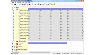

No...
I want a copy of your SETTINGS FILE. From the chair. Not a picture of it!
Like THIS
My Q700R AX20070214 ver5 (loaded).R-net
(4.37 KiB) Downloaded 383 times

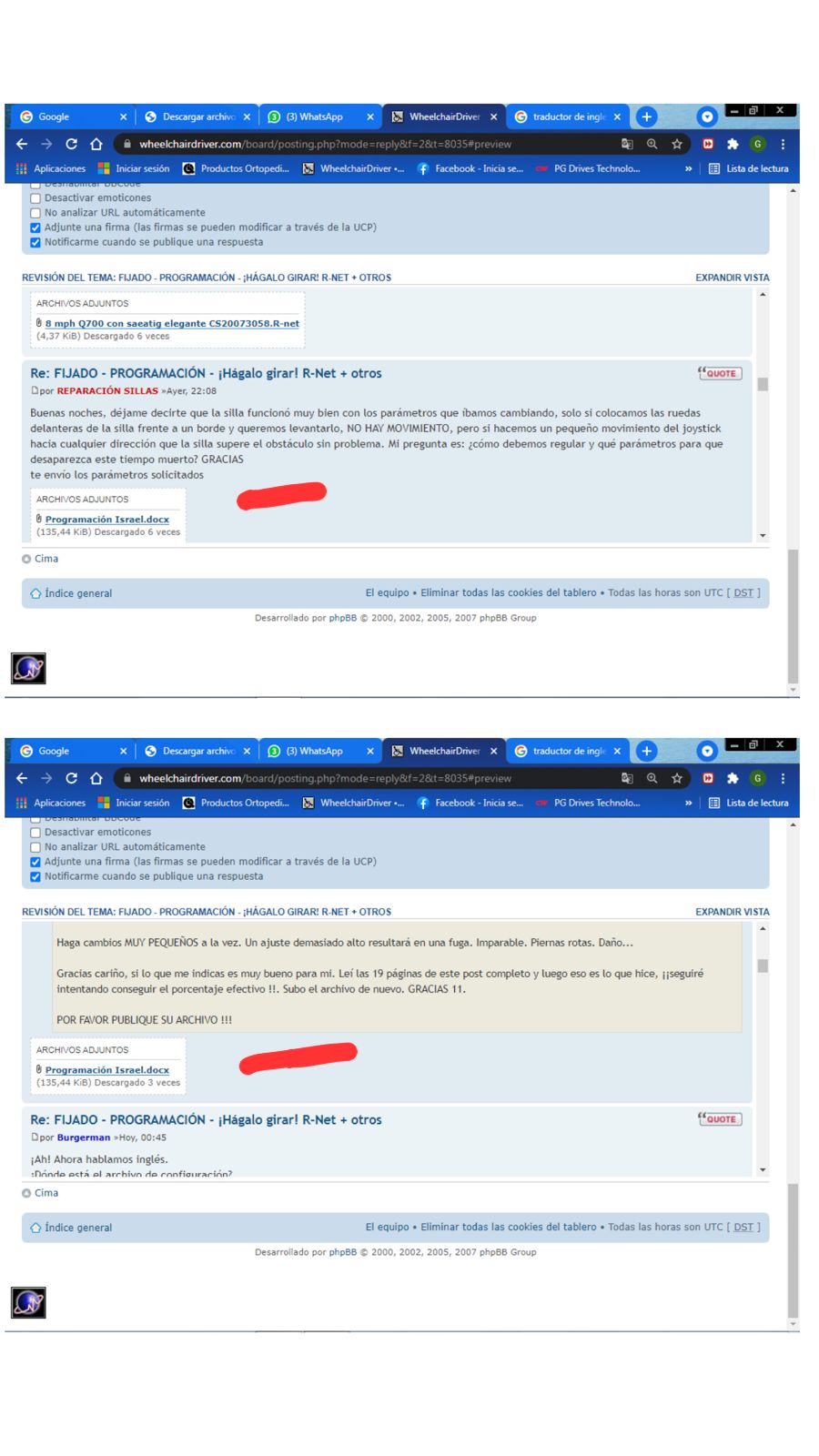

Postby REPARACIÓN SILLAS » 14 Oct 2021, 13:59
Good morning I send it for the third time.

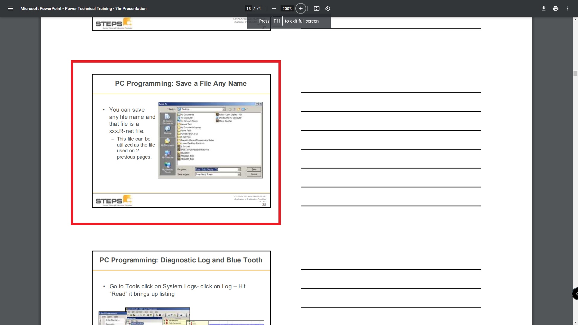

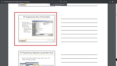

Postby woodygb » 14 Oct 2021, 15:03
NO....A PICTURE OR DOCUMENT IS NOT WHAT B.M. WANTS.
He wants the actual R-net programming file and he has already posted some EXAMPLES of the file type
So ... open the R-net software .... connect the chair ...download the settings / parameters ... SAVE them as REPARACIÓN SILLAS and post the file to the board.
We want to see a file like this REPARACIÓN SILLAS.R-net :fencing

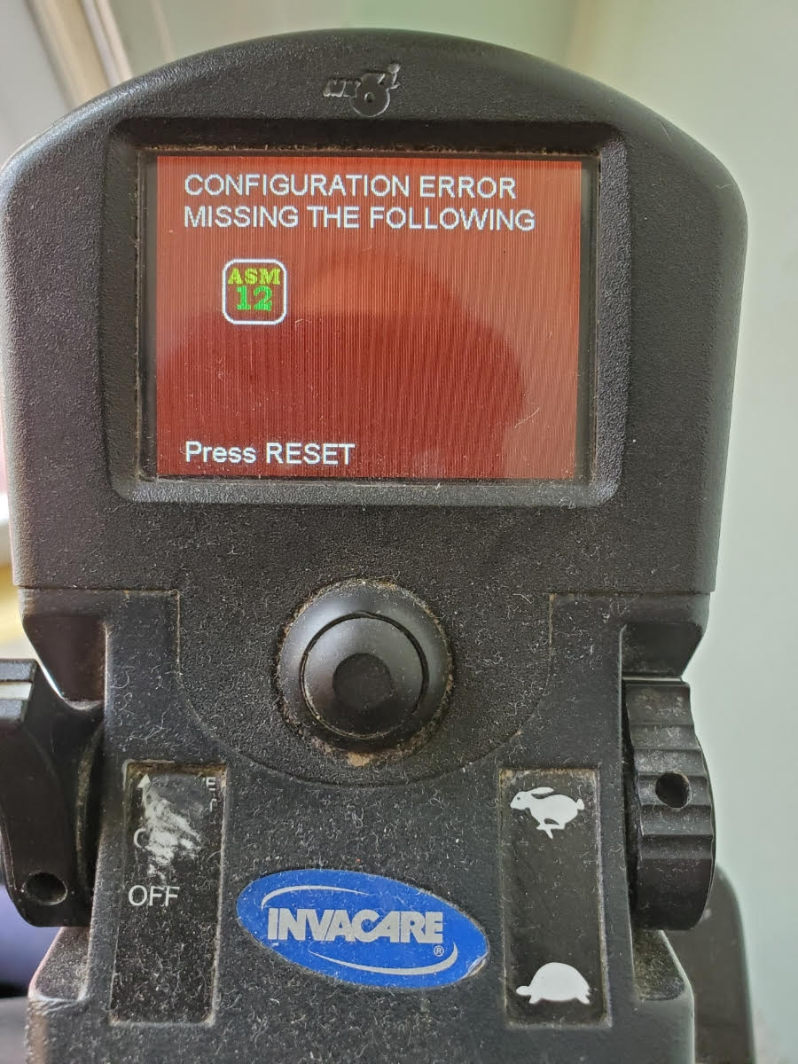

One for the programming wizards. My Torque 3g with Tilt/Recline is showing this error on turn on. I have to click twice on the mode button to get the drive, which is fine. The seat is stuck at a slight tilt. Is there any way to get the seat back to level? Thanks for help.

Postby Burgerman » 20 Nov 2021, 22:41
Seat actuator or actuator module failed or unplugged or somehing. We never had those antiques over here!
Postby Burgerman » 20 Nov 2021, 22:42
Postby chazzyr » 21 Nov 2021, 01:12
Yes it's an older chair, it’s my backup chair I got it in 2012. I'm using it because my regular chair has a problem with the right motor failure.
I'll have someone check the connections.

Postby gcebiker » 26 Jan 2022, 00:41
chazzyr wrote:One for the programming wizards. My Torque 3g with Tilt/Recline is showing this error on turn on. I have to click twice on the mode button to get the drive, which is fine. The seat is stuck at a slight tilt. Is there any way to get the seat back to level? Thanks for help.
I have a few of these, they are called a MK6i if you are doing google searches.
1. The cable running from the Joystick is a common wear / possible failure point, unlikely in this case but if your cable is worn or pinched this can cause an error.
2. There is a 'Stacked' bunch of connectors with covers that slide off and allow you to disconnect one connection at a time, very much looking and behaving like lego !
its possible its a dirty connection, unlikely but easy to check. The locking covers on the lego like stack of connectors at the end of the joystick cable are very fragile and difficult to find replacements for, if you do break one... zip ties work well as mechanical holding and a bag to stop water ingress.
3. The wires to your actuator may be pinched, check all the wires for pinching or damage.
4. Yes you can manually move the chair, connect a 12v battery to it and you will be able to move it up or down.
In the past I have attached an external bidirectional dc motor driver to these for a guy that wanted direct access to the tilt while driving.
5. Your actuator may be worn out, unlikely but possible. Replacements can be found on ebay or other such places.
You will need to find out the stroke length and torque/speed by searching the information that should be on a sticker on your current actuator.
6. I realize all of this is near impossible if you are in the chair at the time and unable to transfer. I hope a friend can help you out.
7. Your ISM module (if you have one on the back of your chair in a silver bracket, its kind of hidden) may have dirty connections.
As with all repairs, it will be a step by step process of checking each possible fault and moving on to the next one.
.... check the most obvious and easy to get ones first, its not the programming.

Postby Fusiongoat » 05 May 2022, 22:52
I have an idea for a special profile and I want to run it past you. I plan to create a profile that would serve only two purposes: 1). Getting the chair loose if it gets stuck off road, like in sand or in a hole; and 2). Curb climbing. My idea for this is to set the maximum forward speed low like 20% and the maximum forward acceleration very high, like 100. The point of this would be to cause the front caster arms to raise up as high as possible without causing the chair to run away once it gets un-stuck / over an obstacle. Does this make sense or is this going too far?
Fusiongoat
Posts: 134
Joined: 22 Jun 2019, 02:03
Postby Burgerman » 05 May 2022, 23:03
My chairs have been set to 100% forwards acel since 1990... And I only have one profile. Rear drive.
http://www.wheelchairdriver.com/gopro/control.mp4 Why set it to go slow? It is proportional. It goes as fast or as slow as you instruct it. It accelerates as hard as you tell it too. Full control. You dont have to do as in the vid. Its mm perfect.
Postby Fusiongoat » 06 May 2022, 06:15
Burgerman wrote:My chairs have been set to 100% forwards acel since 1990... And I only have one profile. Rear drive.
Is torque also proportional? I guess I assumed that it was. So if your chair is stuck and you're pushing your stick all the way forward to get the casters to lift up, then once you are unstuck the chair might briefly fly forward at max speed. Or at least that's my experience. It's true that if you let go of a joystick it will stop, but you don't always know instantly that the chair has gotten free. Anyway I can try setting max forward acceleration to 100 in this profile and if I like it I can put it in other profiles. My other chair is set to 70.
Fusiongoat
Posts: 134
Postby LROBBINS » 06 May 2022, 08:38
Doesn't rNet have a parameter that lets you get boosted torque at low speeds only? i.e. increased motor compensation when output speed is low.
Postby Burgerman » 06 May 2022, 08:59
Yes thats what the torque setting does. It either boosts compensation at super low speeds (or small joystick movements) or it adds a bit of extra pulsewidth under the same conditions, hard to tell which. Its designed to make the chair "start" against resistance such as threshold or zero turn. But what it really does is the same as adding more compensation, without it being jerky at speeds above about 2%.
Postby Fusiongoat » 06 May 2022, 19:53
Okay. I was not being clear. I have torque set to a hundred in all profiles, anyway. I was really thinking about maximum forward acceleration. The higher you set this the higher the front casters lift up when you push the joystick at full throttle. But if you want the casters to lift up very high at slow speeds you have to set the max. speed low, otherwise it will never reach maximum forward acceleration when climbing a curb -- unless for some crazy reason you want to climb a curb at 10 km / hr. Thanks, you completely answered my question.
Fusiongoat
Posts: 134
Postby Burgerman » 07 May 2022, 01:16
Then set to zero, and instead increase motor load compensation by 5. Now it should feel the same at really low just starting speeds as before. But now this level of motor compensation which is a positive feedback loop occurs at faster speeds than 0.1mph, such as while actually going up the curb. And then you could - if the chair doesent feel too jumpy when just starting moving just add more "torque" again.
Thats wrong.
ACCELERATION is unaffected by SPEED settings. And the speed if set to say 50% has EXACTLY the same affect as moving the joystick to half full throttle. If you set acceleration to 100, then it always accelerates at the same rate from 0 to say 6mph. Reducing top speed setting to say 20 percent just means it will accelerate to the new lower top speed at the same acceleration rate.That has exactly the same affect as just pushing the stick 20% of the way. The TORQUE increase needed at low pulsewidth comes from the load compensation.
You MUST have both ACCELERATION and MINIMUM ACCELERATION set to the same 100 (SAME with reverse acc and min acceleration, and deceleration/min dec) or yes obvously its acceleration rate will be less at small stick movements (and exactly the same - lower - if set to lower max speed). I set both to 100 obviously. And I do exactly the same with TURN ACCELERATION, TURN DECELERATION, MINIMUM TURN ACCELERATION, MINIMUM TURN DECELERATION. Or the chair will never steer properly.
