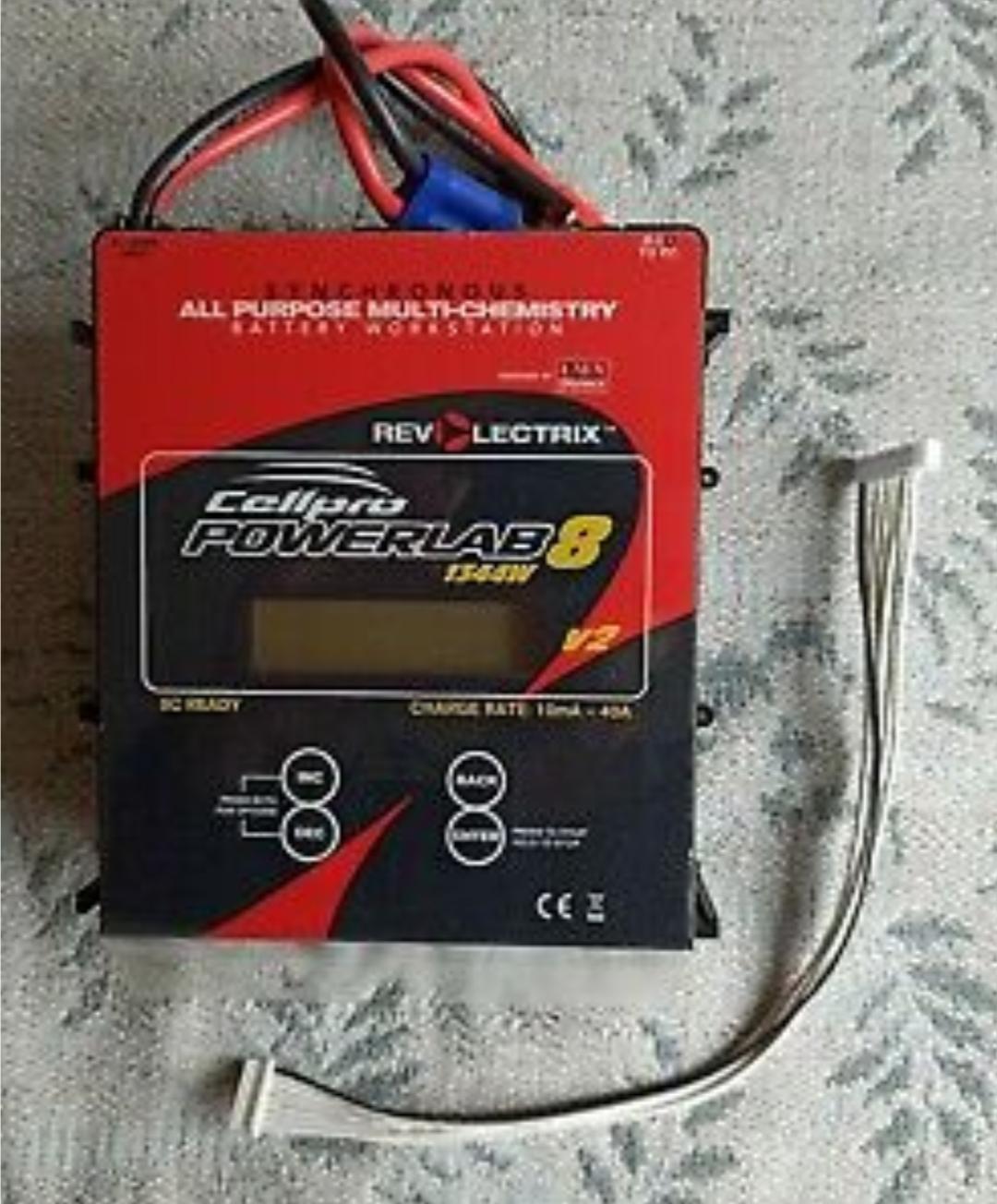

Does anyone know what PL8 V2 balance cable plug is?
What I am trying to do is buy a converter from the PL8 to this https://www.isdt.co/bg-8s.html?lang=en
which I THINK is a XH 2.54 plug.
I can't solder any more and the guy who normally helps me is not very well.
Postby steves1977uk » 24 Aug 2020, 18:51
The PL8 balance connector is the JST-PA series, 2mm pitch I think. This was posted a while back on here somewhere.
Postby terry2 » 24 Aug 2020, 19:04
steves1977uk wrote:The PL8 balance connector is the JST-PA series, 2mm pitch I think. This was posted a while back on here somewhere.
Well done Steve :clap
Off to find a converter...
Postby steves1977uk » 24 Aug 2020, 19:14
Here Terry... http://www.jst-mfg.com/product/detail_e.php?series=189 Seems my memory was correct. :mrgreen:
Postby terry2 » 24 Aug 2020, 20:29
steves1977uk wrote:Here Terry... http://www.jst-mfg.com/product/detail_e.php?series=189 Seems my memory was correct. :mrgreen:
:worship
I will try to find some one to make me a lead up.
All I want it for is to check the cells on a very long run.
Postby shirley_hkg » 25 Aug 2020, 00:41
You don't need another JST on chair side.
Need only one to feed PL8, and you have it already. drunk2 cheers
Posts: 4653
Postby ex-Gooserider » 25 Aug 2020, 01:15
JST-PA series connectors are small, fiddly and generally a pain to build (JST-PH is worse...) The pins are / should be crimped, not soldered....
Because they use small wires (AWG-24 is their max size IIRC) they tend to be on the delicate side, and they really aren't designed for a lot of mating cycles. Their primary intended use is for connecting things inside electronics boxes as part of assembly on a more or less long term basis....
IMHO it is NOT the best choice of connector for use on the PL-8, I would consider it to be one of the relatively few weak points in the charger.
Obviously you need one to get out of the PL-8 to something more robust, but I would suggest NOT using them anywhere else. I think the best approach for the chair end is to use the 'DB-x" connectors that combine the balance and power pins into a single unit - I believe they are described earlier in this thread...
