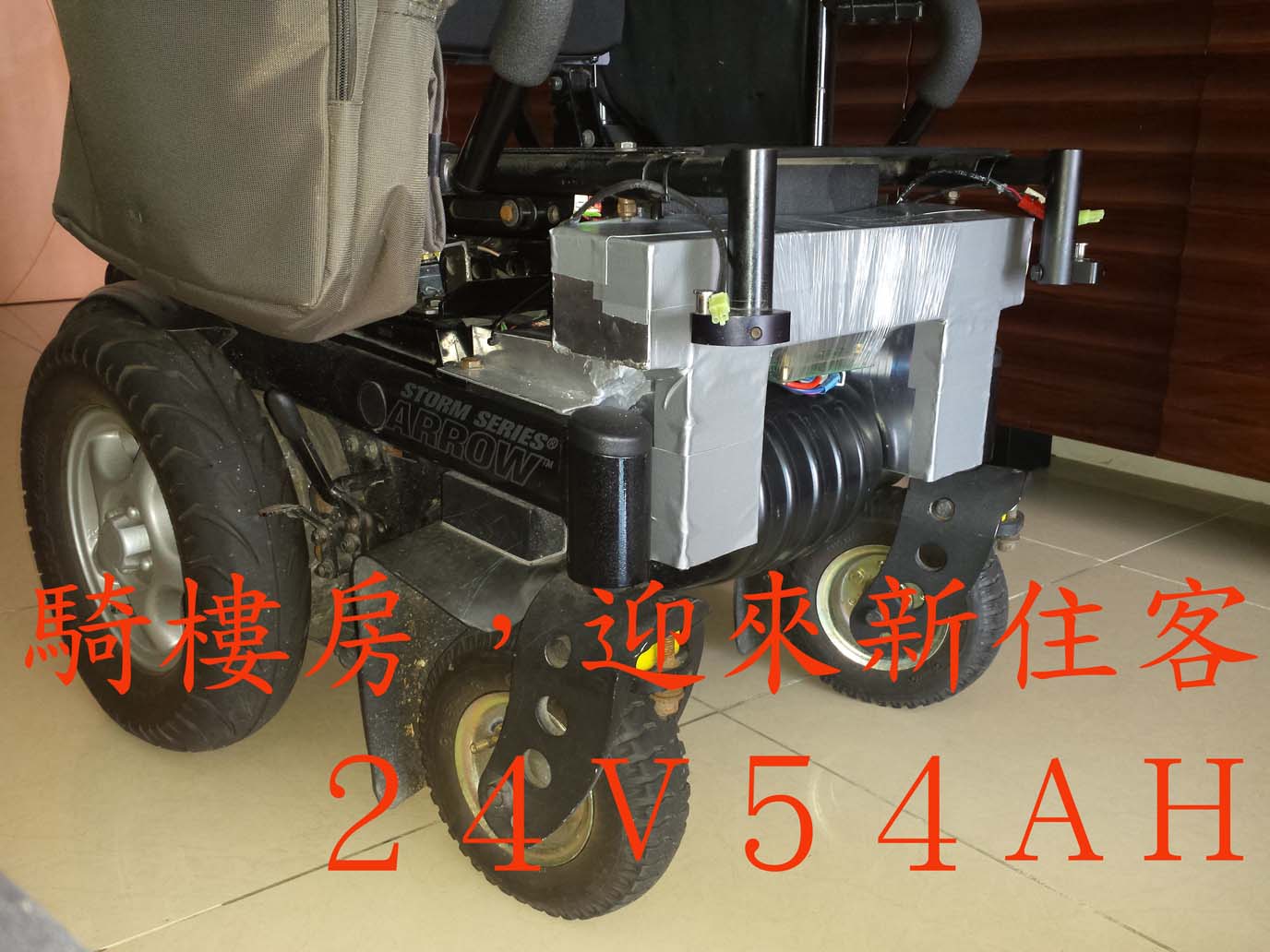

Postby Scratchy101 » 03 Sep 2020, 20:29
I'm in the process of gather info to assist in the custom build of an Invacare Arrow.
I've been slogging through several dozen pages of this thread, including pages of off-topic subjects :problem: .
I'm looking for EVE-LF105 LiFePo4 batteries to purchase, as well as the back-ordered PL8.
I am considering using these fiberglass and silicone baking sheets as battery separators:
https://www.amazon.ca/gp/product/B07FS4 ... GVIC&psc=1
Cut in half, they should fit nicely between these batteries.
Scratchy101
Posts: 2
Joined: 31 Aug 2020, 19:45
Postby Burgerman » 03 Sep 2020, 21:12
Very short wheelbase. Needs the drive wheels further back, and the seat and footrest further back too. Or it will rock over uneven footpaths etc and feel unstable I think.
Also I would keep the wood.
Posts: 71037

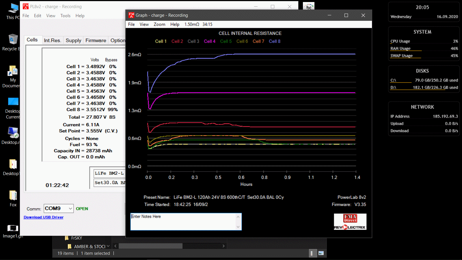

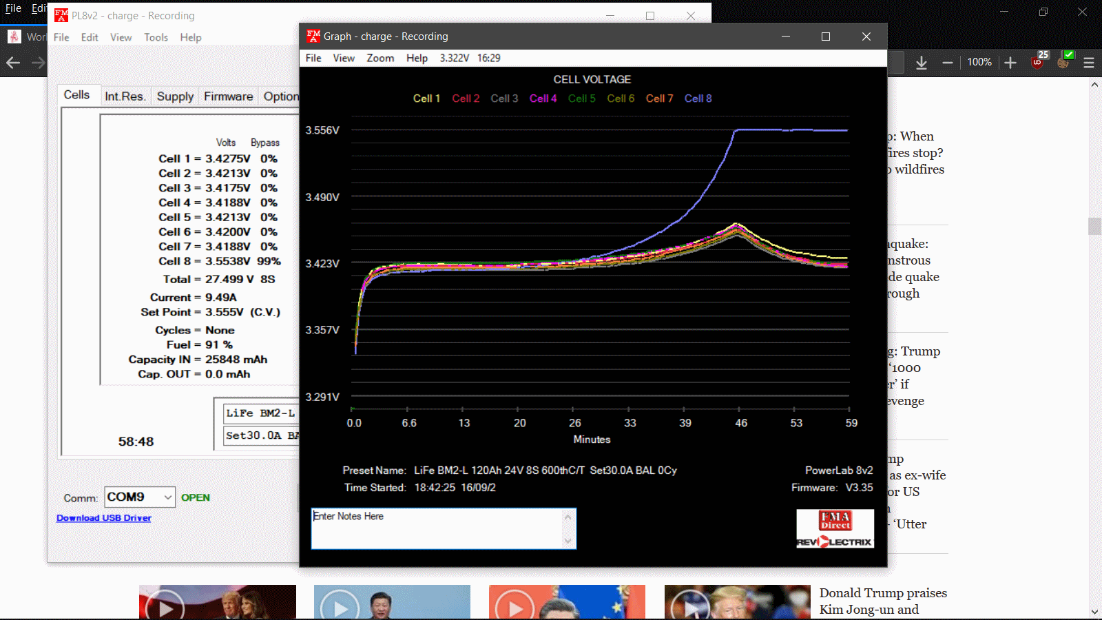

Postby Burgerman » 16 Sep 2020, 20:02
I am posting this to show why charging with a BMS or a dumb charger, with no graphics is not very wise. And exactly how much info you can get from a charge graph I have a problem.
This is my green chair. A lithium battery but its a 120Ah headway 8S pack. Its 10P or each parallel cell group has 10 cells connected together.
This was stored 8 months. At around 45 percent discharged. As you can see all the cells are very close. Except for 1 and thats cell (group) 8.
That group appears to be full long before the rest. Now theres two ways that this can happen.
1. A cell has failed, and now has less storage capacity or...
2. A cell has a loose or high impedance connection.
So how to find out which? Well if its a bad connection, stopping the charge. And waiting overnight will allow that bad connection to charge up the cells that are connected with a high resistance or loose bolt. And lo and behold they wil all be in balance like magic in the morning. (You can also run around each of the 10 cells in group 8, and measure exact voltages. All the same? Bad cell. One or more higher and lower? Bad connection.
Theres also a 3rd possibility. That all the other closer grouped cells have the same high self discharge, and only cell 8 is magically better. Well statistically thats all but impossible. So since a 5 hour rest almost levels these up, its a bad connection... And I suspect I know which bolt it is. I undid one recently and likely didnt nip it up correctly when connecting a battery lead. On an end cell. So that is group 8. Too many coincidences in logical reasoning. So an allen key will fix it.
Posts: 71037
Postby Burgerman » 16 Sep 2020, 20:08
Clue 2.
The blue cell group, no 8 here, is much higher resistance than the others. That also shows a bad connection probability.
Posts: 71037

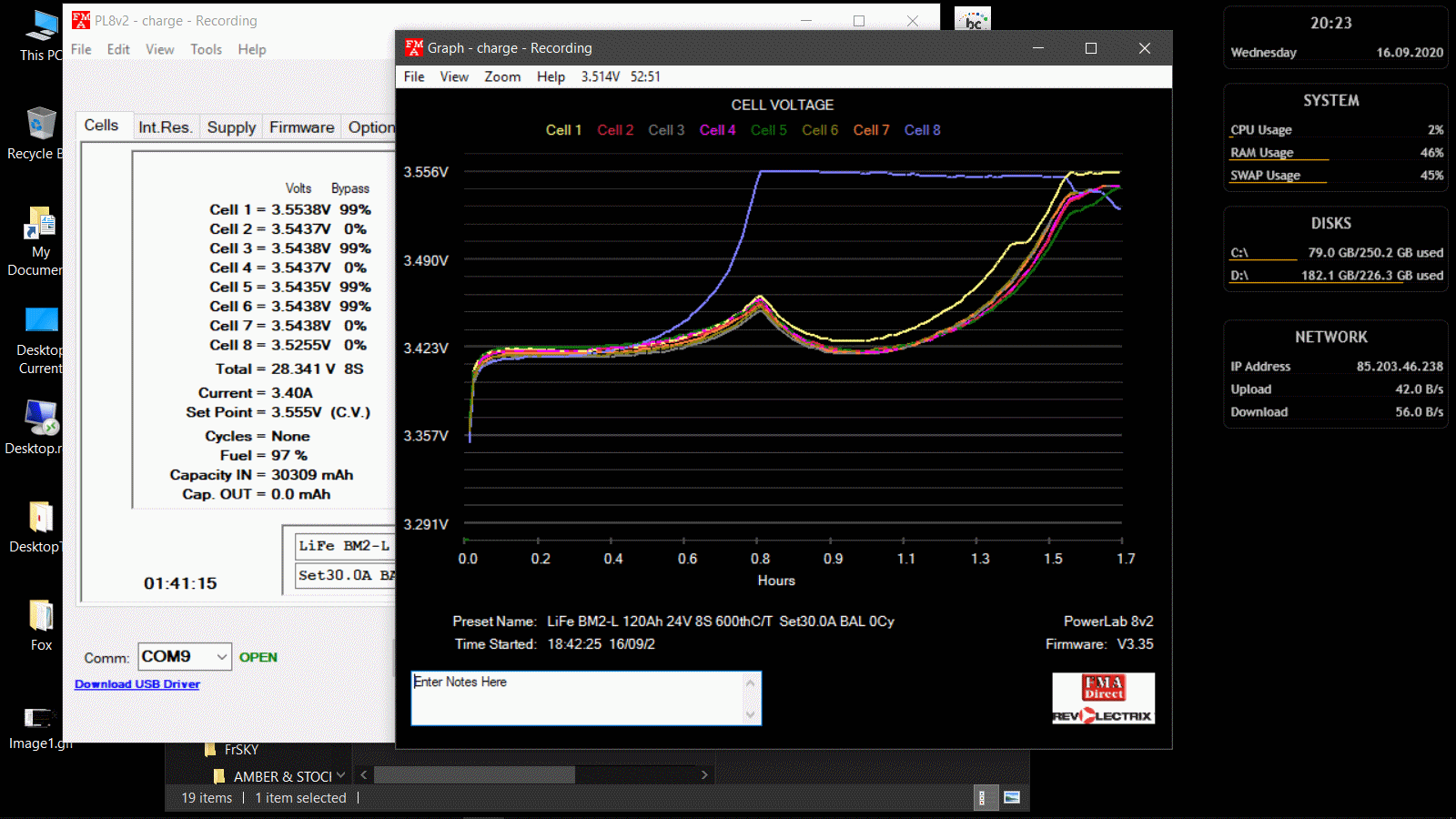

Postby Burgerman » 16 Sep 2020, 20:33
And the final evidence that its a loose bolt or bad connection
Look at the blue cell. Its been charging this pack at around 5A for the last hour. Continually. While the blue cell is supposed to be full. That isnt possible. Because the balance drain current is 1A max. So the blue cell should have gone over its 3.550V setting. And now that the other cells are reaching theis full voltage the current IS falling. So that they dont exceed the cv voltage. So something must be draining the blue cell group (8) fast. Well what can that be?
Its the other half or the other cell or whatever that is connected badly. It is not full. So now the full part of group 8 is charging the less full part up slowly. And is pulling that blue line down due to the reduced charge current. So we have 4 bits of evidence that all fit together. Eventually the blue line will reach the 3.550 point again once the badly connected cell(S) become charged.
This is why having this PC software while charging is absolutely essential. It tells me a mountain of stuff. All it needs is logic and an understanding of basic electrical stuff (ohms law and batteries). It not only shows when things are not going right. But also what the problem is. And where it is.
Posts: 71037
Postby Burgerman » 16 Sep 2020, 20:37
And 10 mins later...
The blue cell has been dragged down further by the uncharged half of group 8. And its begining to return to the top. The curve can be seen to start.
A little LOGIC and a simple charge graph goes a very long way. Without this info, and using say a BMS you would never know. And would destroy the pack. I hope this was interesting for someone!
Posts: 71037

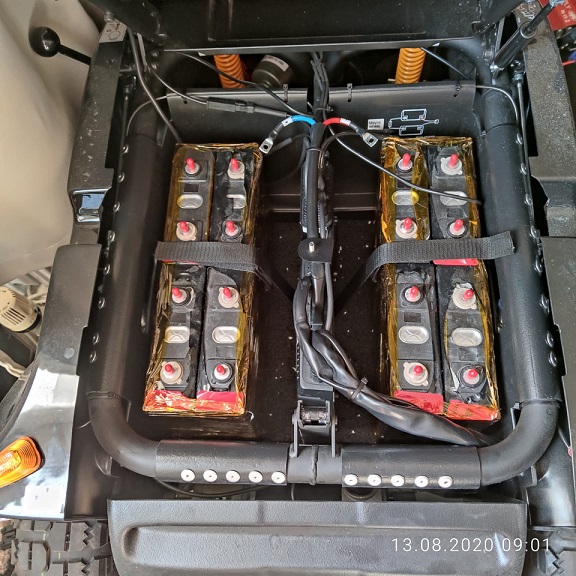

Postby terry2 » 28 Sep 2020, 15:24
Just rearranged my cells.
Now they are more secure and don't move a bit.
I also put rubber shock absolver under them.
Postby Burgerman » 28 Sep 2020, 23:09
You appear to have wasted half the space?
Posts: 71037
Postby terry2 » 29 Sep 2020, 09:27
