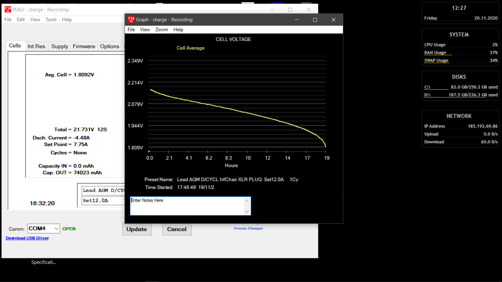

Well programming is easy. But I just tested the https://www.ukmobilitystore.co.uk/shop/ ... -12v-75ah/
Strident batteries they have fitted.
This company fit a new set of Strident AGM batteries to every chair they sell. Whish is a shame as the stock 80Ah ones that sunrise fited are actually better. As long as they were not left discharged. Since the chair isnt used. Just sold as used... Long story
So Strident AGMS...
These are better than most, but still cheap AGM batteries.
They test as per the PDF file, at (exactly!) the same as the spec sheet for capacity.
My test was over 19 hours instead of 20, at a few degrees cooler than the 25 degrees in the spec. Tested after a 24 hour charge. Down to 10.8V (1.80v PER CELL) Total capacity was 74.98Ah. (In the screenshot its not quite done!)
So whats wrong with them?
Unlike the 3.5 to 4mOhm MK gel, they are almost 6mOhm. So you get greater voltage drop under load, and you get to use less of your Ah before the chair stops.
And unlike the (correctly charged) MK gel, you get around 250 to 350 cycles at best at 80% DOD. So they will last half as long.
And since they are 2/3rds the price that makes no sense...
But they are what they are!
GP12-75 Specification Sheet.pdf
(319.26 KiB) Downloaded 531 times

If you look 2 posts higher, that is a DISCHARGE graph of the brand new (cheap) 75Ah batteries. I tested them to see what the real capacity was. I dont trust dealers to fit new... And go read!
And the whole page basically!

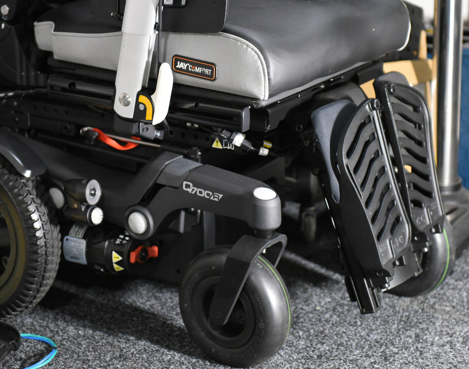

Those smooth 8"x 3.00 x 4 low profile tyres are on. They made a huge difference. Wit those fitted the mudguard/fender on the casters was then hitting the footrest first. So those are gone... The centre footplate can now go back at least 1.5 inches further than with the 9 inch caster tyres. They look good too. Function is much the same, but a little harsher. But this chair has rubber suspension damping on the front caster arms. So its not so bad as I epected. So a win!
Posts: 71086
Postby expresso » 28 Nov 2020, 17:18
Pic of the ithose tires ? Like to try them but on forks made for 9 inch. Have to see how they look.
Postby Burgerman » 28 Nov 2020, 18:16
On bed. Cant get to camera... They look great. Very solid. Fit perfectly. Used the 280/250 tubes.

Postby Burgerman » 28 Nov 2020, 20:00
Unfortunately lit by a torch (flashlight?) badly from the front. My carers pocket one.
The footrest needs a few minor adjustments, such as lowereing and leveling the swing down plates, to the end of that metal bar. And the rear rims, and tyres need a huge upgrade! :roll:
And that terrible cushion needs swapping for my proper Jay2 or Jay fusion gel ones. And the seat needs to be set to a 6 degree dump angle when at its lowest tilt position.

Postby Burgerman » 28 Nov 2020, 21:08
Every small thing helps. Remember the footrest is not fixed angle. I choose the angle. These tyres with mudguard/feder removed allow that footplate to move back around 1.5 inches more. That doesent sound much. But it makes a huge difference. It means that you can sit comfortably, with any tilt you want, and always have a 1/2 inch minmum gap from the footrest. I will fit a mechanical "stop" at the point where it can go back further so tyres can never hit it. The mechanical stop will trigger the end of travel signal and the power will stop to the footrest motor automatically.
The tyres are slightly rounded slightly but still fairly flat. The photo is decieving. Look at the forward facing one on the far side. Steers good, no shake, just a bit more harsh as they have less sidewall and higher pressure. Way better than all those skinny 8 inch tyres fitted to mid drive chairs. And because its 3 inches wide it has a much higher load carrying capacity too. Stronger built. Rated for 60PSI too. Currently at 45PSI. The guard, fender, or whatever you call that thing will be shortened by 2 inches, so it no longer hits and replaced one day soon!
