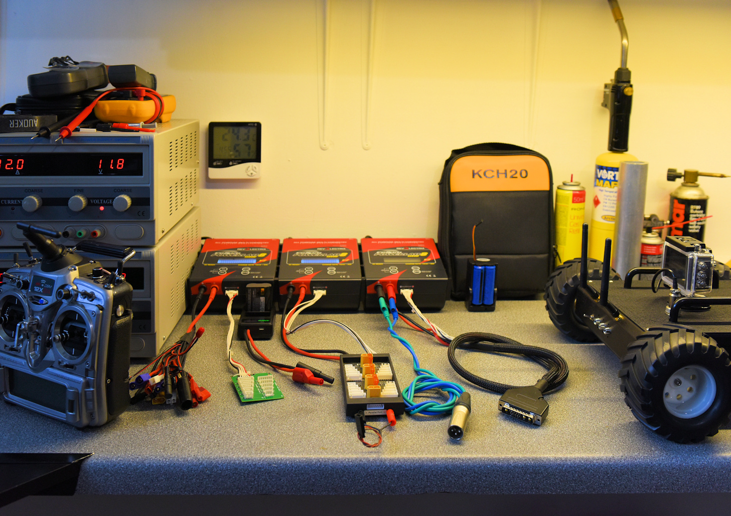

Postby Burgerman » 18 Jan 2022, 15:20
Hyperions. Unreliable. Had 5 only got 2 left working...

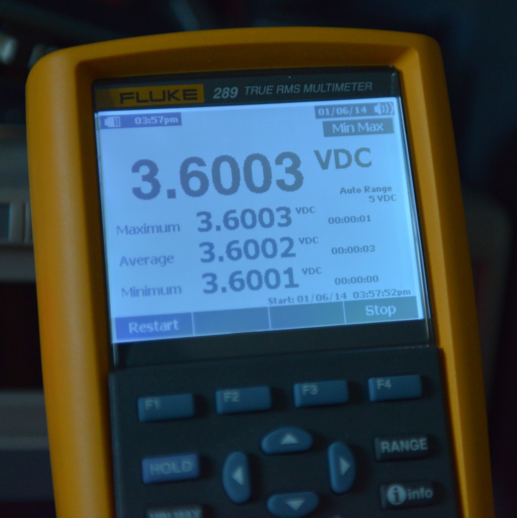

To test accuracy and balance node accuracy... Recently calibrated fluke hi end meter

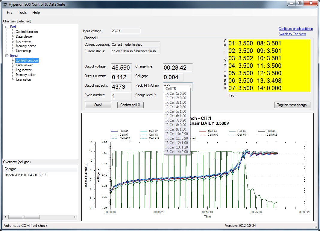

Hyperion control software. Not as good as pl8. But my chair is 13S so useful! These chargers are 14S.
Only 4 here! The 5th is in my van. ALL are converted to BT for PC control.

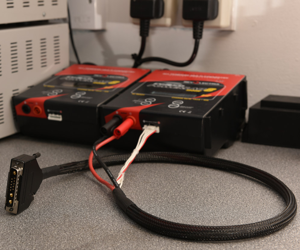

Postby Burgerman » 18 Jan 2022, 15:28
Hyperions were OK but only after talking to the developer and the boss for 3 years and about 16 updated test firmwares. Then they stopped making them for years so the only othr decent chargers with PC software was the PL8. And so another couple of years getting many firmware changes so that these too would work well for our purposes inc lead. As they were they were hopeless. Now great!
With chair charge cable. 8S.
This can charge 24S
And everything from my 10 and 12S Helicopters, to my 13S powerchair. And my camera etc. Quadcopters, rc transmitters, and my mower.

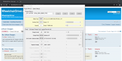

Postby Wavedy2 » 18 Jan 2022, 18:08
yea im a bit jealous. I didnt know you could control he pl8 in real time with the pc software. I dont know why i was thinking the settings could be adjusted via pc software but needed to be loaded into the pl8 then start an stop charge on the pl8 controls.
That would be HUGELY beneficial i would love to have that option. But sadly doesnt look like any of the companies making the chargers currently on the market are developing any pc software like with the pl8. And if they did wouldnt it take years for them to get everything well developed in the software?
Quite. That is why most of us want PL8S! So everything is controlled and monitored by laptop! And because after me fighting them for a few years we got all the options and settings and relaxed safety nazi settings, as well as special access to the settings that normal mortals dont have. And the electrical build quality is far less fragile than all the other makes. So that things like the order of connection or disconnection dont blow msfets or worse. It was designed to be intrinsically well input/output connection protected. Unlike the ichargers etc. But its dead jim. So we no longer have the choice! Fortunately I have 4 of those. Some hyperion 14S chargers, etc. All with PC control / monitor software.
that is very strange. i thought i'll find here experts ...
why do you saying that ?
for sure it's possible to manage 4010 via PC. to manage/setup/start up/stop
why do you say only the PL8 could do that ? i really don't understand your mind
