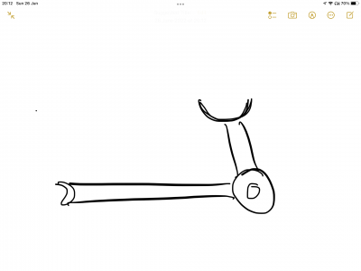

Postby Scooterman » 26 Jun 2022, 20:11
I wonder if I could make something like this as fast jack? But I’d need to get me angles right so jack would stay up when handle is flat on ground. :problem:
Re: Punctures!!! Grrrrrrrr
Postby Scooterman » 26 Jun 2022, 20:13
Like this

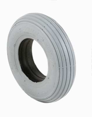

This one is the Razor, it's for the Razor E300 stand up electric scooter. https://www.monsterscooterparts.com/cat ... rsions-40/
Did you notice a difference in handling between the rounded Razor profile and the squarer later profile of the Durotrap? I was wondering whether with a rounded profile front wheel the chair would more naturally want to run in straight line. AKA the motors have to work less hard to keep it inline. Hence saving battery power. I'm sure BM might have something to say on this. I think that's the reason they recommend grooved front wheel treads. Like these
But then I might be being a bit anal. I'm just thinking back to the days when I used a lightweight rigid frame manual wheelchair, and having the chair set up so it naturally wanted to run in a straight line with minimal effort made a world of difference in arm fatigue when wheeling.
Postby expresso » 27 Jun 2022, 18:42
try the rounded one first - i dont like that that grey one you posted - those are originals on sunrise here - i am sure they may be fine working wise - but the color grey - dont like

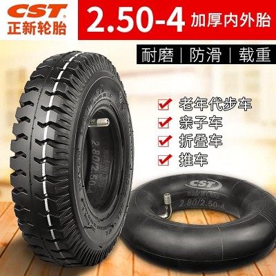

Postby Scooterman » 01 Jul 2022, 13:19
Cheng Shin Brochure!!!
A handy reference guide. I'm not saying they're good tyres or anything... It's just that they're a really common brand of mob device tyres in the UK and probably elsewhere in the world.
And the code numbers might come in handy when ordering online from mob equip sellers. I don't know if your experience is the same as mine, but often when ordering tyres the tread pattern bears no resemblance to the online listing photo. I always try and order a tyre with tread pattern that looks more suitable for tarmac, but often end up with an egg box like block pattern which is more suited to off-road.
https://portalimages.blob.core.windows. ... re.pdf.pdf

Postby martin007 » 01 Jul 2022, 21:19
Scooterman wrote:
martin007 wrote:I'll give you a tip.
Look for a industrial purpose black cover; they are better and cheaper.
Have you got a link? :ebay
What measures?
Posts: 4096
Postby Scooterman » 03 Jul 2022, 10:45
As good as KENDA
They look good Shirley, nice and meaty (thick rubber, tough).
Aw! it's a shame I've already bought some tyres :(
But I will save the two images to my mobility folder for next time. :thumbup:
