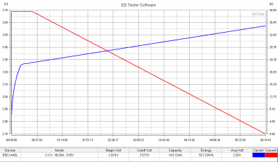

I asked for details about the 160Ah cells.
"Just to confirm, these are A grade EV cells, correct? And is the capacity and performance guaranteed?"
Docan Power replied:
"The EVE 160Ah is solar grade A cells, not EV grade A. The capacity tested out over 160Ah for sure:"
and this graph was included. Does solar grade mean 1C vs something higher?

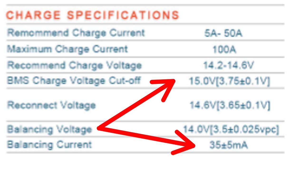

Re: Group 24 cells
Postby shirley_hkg » 25 May 2024, 03:36
These 2 figures, one too high the other too low, worried me most.
Posts: 4505
Re: Group 24 cells
Postby Burgerman » 25 May 2024, 11:47
35mA balance?? It will spend forever trying to balance. 1ah out? That means balancing for 29 hours... Actually that 35mA is when its a lot out of balance. It drops off when it gets closer. So who knows how long that would really take. Takes 1 hour on a PL8 hobby charger at 1000mA continuous without exceeding the 3.550v I choose. By proportionally reducing charger power output to maintain correct voltage without repeatedly cutting on/off the charger.
And that high charge cut off voltage means it will repeatedly do that over voltage over and over while its charging. And its charging untill it ends up balanced. So it will be bouncing off that limit for who knows how long...
Will it work? Yes eventually after its cooked the battery every charge. These are just a few more reasons to avoid BMS equiped drop in replacements.
Reconnect voltage also too high. The charger will instantly push it above that 3.75v again. And again.
The reason so many of these BMS systems do this at a too high voltage is because the microscopic balance current isnt adequate. And they rely on overcharge to drag up low cells like a lead battery. Which does a lithium battery no good at all. But otherwise they would likely never get properly balanced at all. Now this is OK for a while when cells are all well matched and new. But at this rate thats not for long. So they soon become harder to balance. And then the excrement hits to rotating air mover.

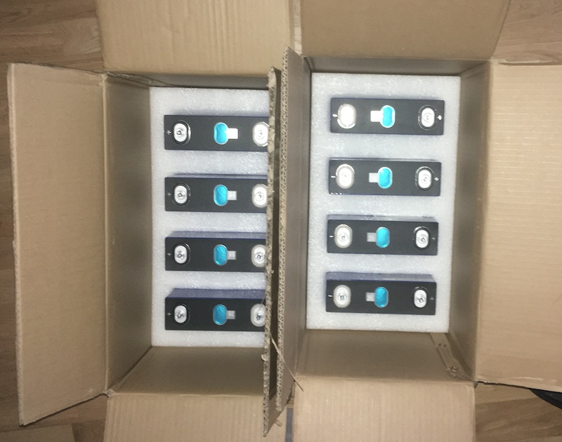

The 160Ah cells have arrived. I have yet to open the boxes. Is it worth testing each individually? or try to connect everything and do a full charge if all the voltages match?

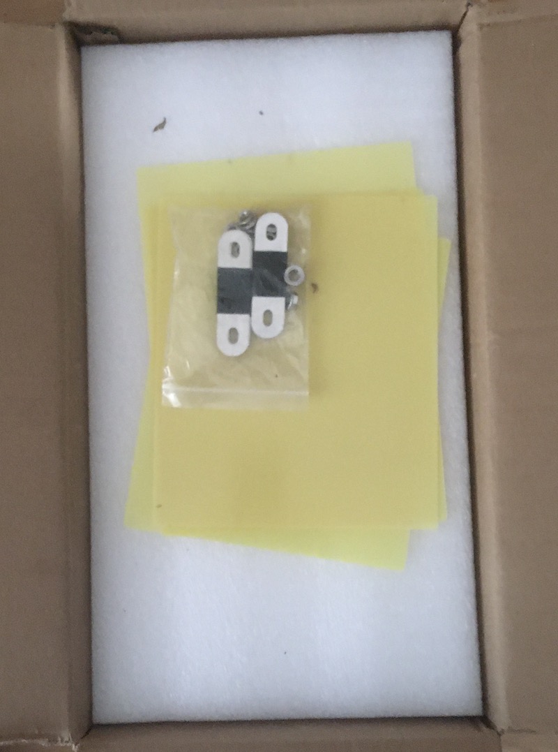

Postby jefferso » 18 Jun 2024, 12:53
The cell came in two boxes. Securely packed with large foam inserts. Opened and checked the cells. They all read 3.299v.
I had an older multimeter and checked with it and they all read 3.288v on the old meter.
So now I can use the bus bars they supplied to connect all the negative terminals together and all the positive terminals together, and leave it for 24 hours to ensure they're all exactly equal, correct?
