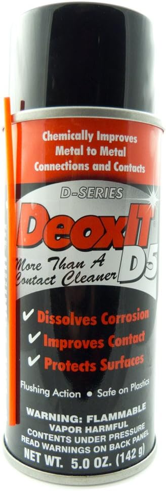

Postby emilevirus » 30 Jan 2025, 02:58
I opened it up, cleaned everything with alcohol. Boom started working!
emilevirus
Posts: 459
Joined: 12 Aug 2020, 22:02
Re: PINNED - R-Net for dummies
Postby Burgerman » 30 Jan 2025, 10:08
Invest in a tin of switch cleaner, contact cleaner or whatever it may be called were you live.
I use it on all connectors and looms or computers etc all the time. I fixed my non working mouse buttons on my laptop this week. Deoxit.
It deoxidises, cleans metals, and leaves a film on the surface that "wets" the contact areas so that it makes better contact. Seems to fix a million intermittent electrical connectivity issues. And prevents it happening.
