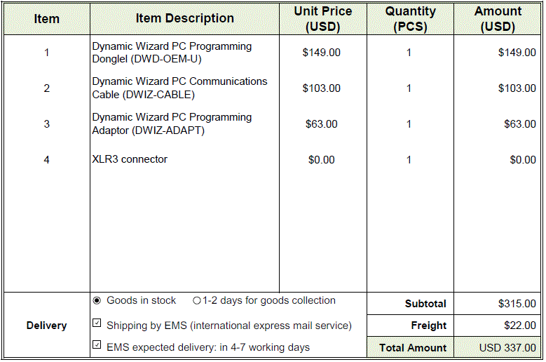

Postby woodygb » 08 Mar 2014, 13:01
Price August last year.Image

Postby carlo67 » 09 Mar 2014, 00:50
so I need this?
Dynamic wizard pc programming DWD-OEM-U dongle
Dynamic wizard pc communication[DWIZ-CABLE]
Dynamic wizard pc programming[DWIZ-ADAPT]
XLR3 connector
is that all I needed?

Postby woodygb » 09 Mar 2014, 01:20
carlo67 wrote:so I need this?
XLR3 connector
To the best of my knowledge ...( I only obtained a quote )......Yes.

Postby carlo67 » 10 Mar 2014, 05:23
I received a quotefrom TAIWAN YO-LIN LTD.. It will be about $850

Postby carlo67 » 14 Mar 2014, 07:38
hi
is this correct products ?
I would like to order it
carlo67
Posts: 251
Joined: 18 Mar 2010, 04:58
Re: which chair is best or better.
Postby woodygb » 14 Mar 2014, 08:58
Not entirely sure as the DWIZ-KIT shown on Dynamic... http://www.dynamiccontrols.com/en/deale ... rogramming ... does not show the OEM Dongle.
•DWD-OEM-U OEM
Ask them to list exactly what the DWIZ-KIT contains.
Postby LROBBINS » 14 Mar 2014, 10:11
Yes, you will find any dongle less than OEM level to be a total frustration - make sure you have it in writing that this is what they will send before sending your money. I suggest writing to Rosstron and asking them for a quote too - shipping from the U.S. can be expensive, but you might be surprised by the reasonableness of their offer. Ciao, Lenny
