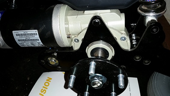

Hi BM. I did look on those sites you listed but I couldn't see them.
This is a break down of the Fusion chair in PDF format http://www.activemobilitymaintenance.co ... rchair.pdf
On the label it says " watts continuous 359W watts Peak 600 W" If I google the part number and serial number I get the pdf I've posted.
I will have to get someone in to take the wheel off for pictures.
Thank you.

Burgerman wrote:http://www.amt-schmid.com/en/products/right_angled_drives/seg_01/seg_01.php
I must admit I saw that one but then I saw "up to 300W" and mine is 350 W so I never gave it a second look.
Got some one coming round the weekend to take the wheel off so I can get a picture.

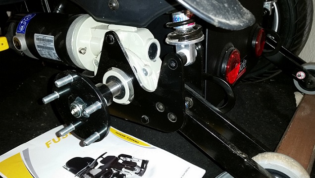

Re: Pride Fusion Power Chair Info
Postby terry2 » 07 Mar 2015, 10:58
Another pic. Hope it helps.
Postby Burgerman » 07 Mar 2015, 11:17
I am very practical, understand a lot of physics and engineering and can see how things work. And a previous life of hobbies and building drag bikes, custom cars and 101 other things lets me know what "stuff" is out there and a lot about batteries etc. But there are others that are far more technical on here like Woodygb or Lenny etc.
That motor just bolts to a flat plate. Drilling a few holes, or making a flat adapter plate, or using spacers will allow other motors to be fitted.
But gear ratio determines speed. RPM per Volt is almost completely linear. So you need to connect a 12v battery, power the brake off, and count revolutions for 60 seconds. Then double it for 24V. Then remove about 10 percent for load and because these chairs run on about 22v.
This x wheel diameter determines speed. If it is faster it will need a more powerful motor too and likely it will be a 4 pole motor instead of two as shown.
