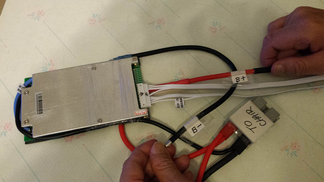

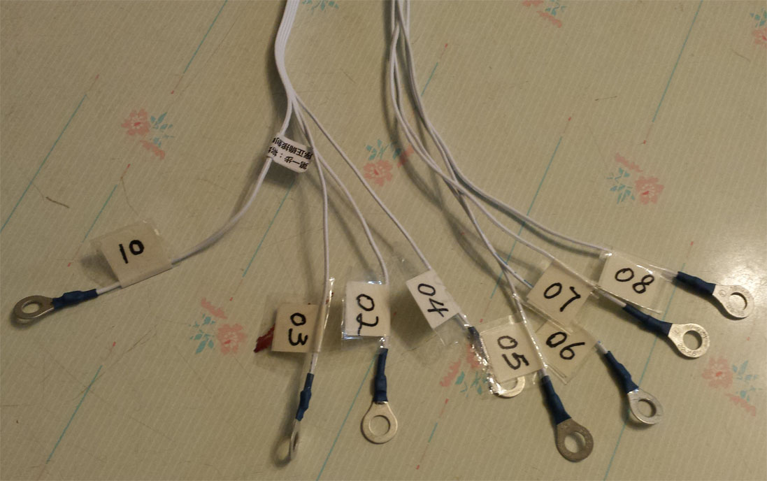

Postby shirley_hkg » 30 Dec 2015, 12:09
It's all marked up. ;)
Balance leads are screwed on as numbered ; 01 ---- 08 . :idea:
BMS has only =/- for battery terminals. :idea:

Postby expresso » 30 Dec 2015, 15:26
Ok - thanks - looks nice - simple enough once i know where to put those balance leads :)

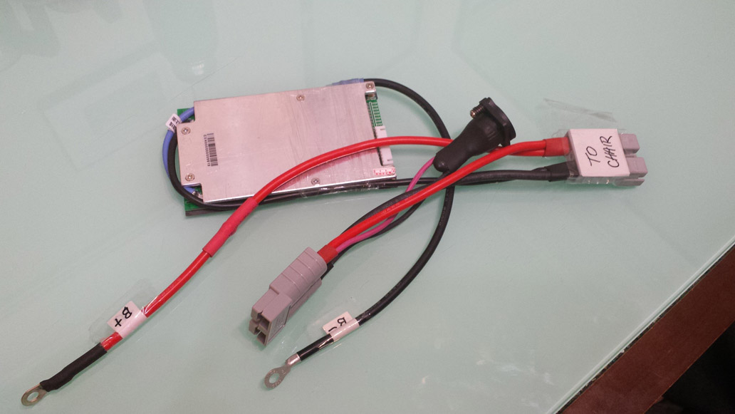

Shirley - you added an XLR also to charge with slower charger ? also the Pos and Neg. cables - those have ring terminals also ? i am still waiting on my other 8 Cells - not sure what happened but they are still in HK :shock:

Postby shirley_hkg » 31 Dec 2015, 12:10
expresso wrote:Ok - thanks - looks nice - simple enough once i know where to put those balance leads :)
All the other connections are completed already. :lol:

Postby expresso » 31 Dec 2015, 16:47
Nice - All i need to do is make a Cable to go from this BMS to my chair - Besides connecting all the balance cables and leads etc, - will be needing HELP to do that - to be sure i put them in the correct locations -

Postby expresso » 02 Jan 2016, 17:29
Terry - Yes you can do it also - and it will just connect to my chair - simple plug in - this is my first time doing this and i am learning alot here - 25 miles i think can be achieved - but it will all depend on your chair - the road you ride on - the condition of the batteries to begin with etc, - i can say for me - my chairs are power hungry and suck them up fast - and i can get a good 15 to 17 miles out of them - you want to be very close to home towards the end though - so keep that in mind -
now with the ADD ON - i cant say yet how it will be - but if all goes well - i think i can do 25 or close to it - i wont know till i do it - it will also depend how big a ADD ON pack you make - mines is actually a small pack - i just wanted to test it and see how it feels etc, - but even with this small pack i am going to do - i may be able to get an extra 8 or maybe maybe 10 out of it - which brings me to about 25 miles -
again i dont know just yet - hopefully by the summer i have this done and i can give real info on how it works for me - for me the whole point of enjoying the summer time is riding - not taking buses etc, - unless i have no choice or just tired that day -
i have a Pos and Neg. cable connected to my batteries which stick out of my chair - and thats how i charge my chair with a faster charger - i dont use the joystick chair charging port for that - you can still do so - and use the charger you get with your chair -
once the cables are made - this ADD ON - can just connect to that cable you made sticking out of your chair somewhere - and thats it - if you are like me - pretty much new to alot of this stuff - i would read this forum and get as much info as you can from reading so you have a better understanding of everything -
i started at first with just adding the cable and a faster charger - which is good also - but i realized if your outside with the charger - still not easy to find a place to charge and then even though its faster to charge - you still have to sit still for a good hour at least or two to be safe - so i decided the ADD ON may be better and replace the charger instead
MK GEL 24 batteries should be used at least - since they will give you the best range and are a quality battery - any other brand type etc, wont hold up as much - -
