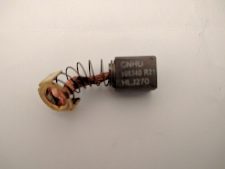

Fix it is the only way. Thanks again. Sorry about the crap pictures. The writing says
CNHU
108340 R21
HI J270
The I in HI could be a L. Off to search for them :

https://www.amazon.co.uk/dp/B00JNWD0B2/ ... 010919BRDX
That is very close to the size of mine.
Re: Puma 40 pulling to the right.
Postby Burgerman » 07 Aug 2016, 09:36
If the spring/top part is correct, and length OK, then you can very carefully, use a medium fine alum oxide paper (stuck to a flat surface like a bench or glass sheet), reduce the cross section if needed. From say 8mm to 7 or whatever you need. Reduce by enough to allow free sliding movement, no excessive free play, by trial and error.
Posts: 69775
Postby terry2 » 07 Aug 2016, 10:06
Burgerman wrote:If the spring/top part is correct, and length OK, then you can very carefully, use a medium fine alum oxide paper (stuck to a flat surface like a bench or glass sheet), reduce the cross section if needed. From say 8mm to 7 or whatever you need. Reduce by enough to allow free sliding movement, no excessive free play, by trial and error.
Thanks for that tip :)
Now this site that has the brushes http://www.nithsdale-wheelchairs.com/pr ... nits-.html
They have the same number. The ones on amazon are 7mm not 8mm and 11mm not 12mm hmmmm thoughts?

I'm going by the site before I guy. But is 1mm smaller in width and depth going to make any difference? I.E 7 x 11mm instead of 8 x 12mm
Postby rover220 » 07 Aug 2016, 12:29
Means it could move around and wear prematurely.

A friend who buys stuff from china got me 4 brushes the same size as the amazon link.
They was fitted and worked but still the right motor is weaker. So it looks to me I will need two motors soon.Will use them till they die.
