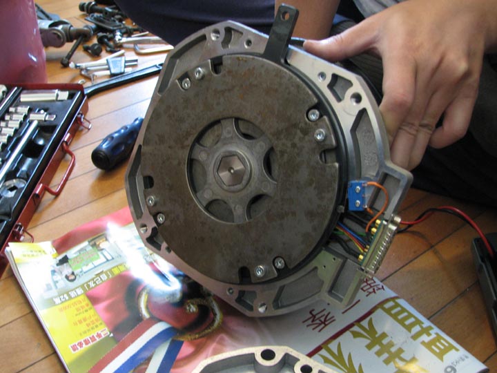

In order to fit the 120/70 or 110/80 x8 tyres, you need to add 5 spacers to the wheel.
Either 50mm for 110 tyre or 60mm for 120 tyre long, 8mm bore. Those can be bought on ebay.
Then add 1mm thick alloy sheet bent into a ring. You need 2 per wheel.
One goes inside the external rim.
One around the outside of the rotor drum, on the reduced diameter part. One slides inside the other as a tight fit. Then use those alloy solder/braze rods to join ends and fit together as a 'stepped ring'. Now you have a rim, that was 1.75 wide, at 3.75 (or 4.20 inch).
These are for the Duro tubeless tyres, and can be used with a 4.00 x 8 heavy duty (90 degree valve) tube as fitted to trailer wheels. Those are heavy and good solid quality compared to what we are used to. As soon as I get off this bed I will do pictures as I do it!
You put them together by welding ?
These are cast aluminum . Not good for welding .
Damage to the rare magnets too ..
Re: Brushless eBay!!! Bought.
Postby Burgerman » 10 Feb 2017, 02:58
No. Assemble with bolts, as before, but with 50mm spacers. And with a 50mm deep 'stepped' ring made from 1mm aluminium sheet, to locate the rim and to take the load and to fill the gap. THAT ring will be brazed at low temperature. On its own. Not to the wheel or motor.

Alternatively , the complete outer rim can be machined .
Still don't get how you seal the motor half air tight .
Postby Burgerman » 10 Feb 2017, 10:29
Tube... I could machine a rim from your image, but would need to end p with a 3.75 or 4.25 width. And not sure that the bolts alone offer enough strength. So must use the same spigot as the original rim.
Also I think that you can use tubeless on the original rim if you seal it with O ring. Its tapered and will seal the feather edge on a tubeless tyre..
