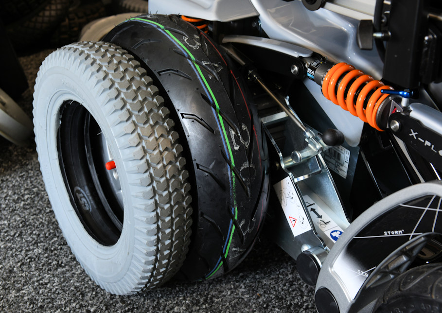

Otherwise , go for 10” rims with short sidewall tyres .
Theres no way to do that. Unless skinny. And I hate skinny tyres, they sink on soft stuff and look like bicycles.
You don't need a drawing. Just as stock, plus 40mm extra width for 110, 50mmextra width for 120 tyres. Seal with O ring between the bolt holes and the edge. Cut a groove that is 3mm wide, 2mm deep. Fit 3mm O ring. Smear with silicone and bolt it on! The rim edges themselves are OK for tubeless tyres.

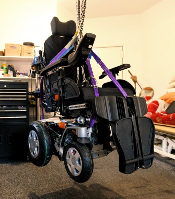

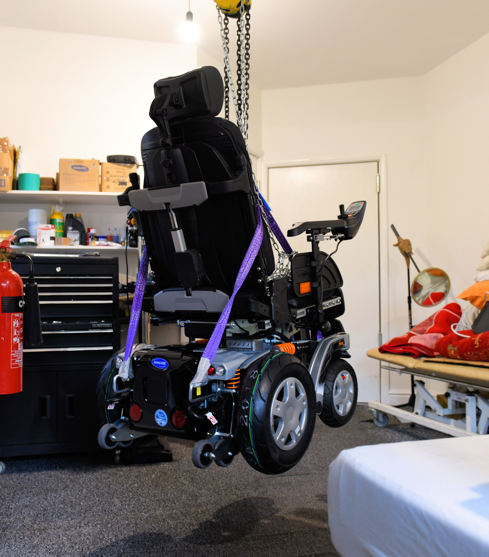

Postby Burgerman » 07 Mar 2017, 17:26
Almost done...
Tyres, seat, footplates, programming, wider rims on rear, etc.

Re: New chair!
Postby Burgerman » 07 Mar 2017, 17:37

Re: New chair!
Postby salam321 » 08 Mar 2017, 11:31
i like it, nice job with the tyres, congrats !!

I had it with skinny grey tyres and punctures 20 years ago. They are just fragile, and you can squash them with fingers when removed. No strength or substance to them. And they sink on grass in winter too easily. 200kg plus myself! These are much tougher, designed for 70mph highway use. But it adds some width to the chair. Like about 3 extra inches. Making it 28 wide.

Postby CPguy » 08 Mar 2017, 13:38
May I ask:
1.) The backrest looks heavy. Why no sling back?
2.) Why do you suddenly have a headrest?
3.) The footplates seem extremely long. Will you shorten them, to end up with something similar like your custom footplate?
4.) Why no mudguards?

Postby Burgerman » 08 Mar 2017, 14:31
Back? Its plastic. So not heavy. But I did consider it. I don't need a fancy back. But, while the sling back allows a deeper seat by 1 inch, that doesn't help if the limiting factor in moving the seat (you) rearwards is the point where the centre footplate motor hits the lift mechanism. So why not go with the shaped one and a cushion. Don't know what's in the cushion but its very light and the middle is 1 inch thick. Hence the difference.
Headrest? Its actually a neck-rest. Because if you try tilting back, and recline, to use for pressure relief (main reason for the chair after suffering another 7 months on my bed) you need something there or your head wants to fall off! You suddenly discover that its very heavy. But it has to be low enough for the van entry.
Footrests. Yes too long. Will eventually fit a different plate. But for now they are the same as my size 11s...
Mudguards fit pretty close to stock rear tyres. And are narrower already. These tyres are big enough additional diameter extra, to hit the stock mudguards. And they will only cover half the tyre anyway so wouldn't have fitted. So rather than waste (200 pounds!) I didn't order them. And since the tie down in my van is raised off the deck, (to allow a shorter bolt) I needed this extra ride height too.

Postby Burgerman » 08 Mar 2017, 14:35
Stock tyres/mudguards...
My wheels are about an inch bigger diameter and 2 inches wider.
Posts: 70478
Re: New chair!
Postby Burgerman » 08 Mar 2017, 14:47
Slightly bigger diameter, would hit...

Postby Williamclark77 » 08 Mar 2017, 16:52
That looks good. I prefer feetrest that are longer, at least almost as long as my feet to avoid mashing my toes when I hit something or push open a door.
I'd like to know what this one weighs. Not book weight but actually rolled on scales. I know you have scales. I bought a decent crane scale to hang mine from my engine hoist to weigh them.
Do the front casters hit the feetrest since you moved the COG back? Most I've seen with elevating legrests hit anyway when all the way back. That's the issue with my builds. Either make the swingarms really wide, feet way out, casters small, or seat way farward. Have to do one or they'll hit. Compromise. Cutting your feet off would be easiest.

Postby Burgerman » 08 Mar 2017, 17:03
I will weigh it when I get chance. Footplates dont hit.

Postby salam321 » 09 Mar 2017, 00:55
what i'm worried about is that these tyres would get slipery on slopes, especially on raining days, i was intending to ask you before you put them to work, do you need innerspace for them, Slightly bigger width , would it hit too ? // limited margin for tyres width same as diameter //how much is the max limit for both

Postby shirley_hkg » 09 Mar 2017, 08:33
salam321 wrote:what i'm worried about is that these tyres would get slipery on slopes, especially on raining days, i was intending to ask you before you put them to work, do you need innerspace for them, Slightly bigger width , would it hit too ? // limited margin for tyres width same as diameter //how much is the max limit for both
about footrests, i always admired this type although never tried one, they look a bit longer than usual, but this is a man's choice.
These tyres are for REAL vehicles ; motorbikes , instead of low end mobility wheelchair .
They have much better grip than your foam filled knnoby grey tyres .
