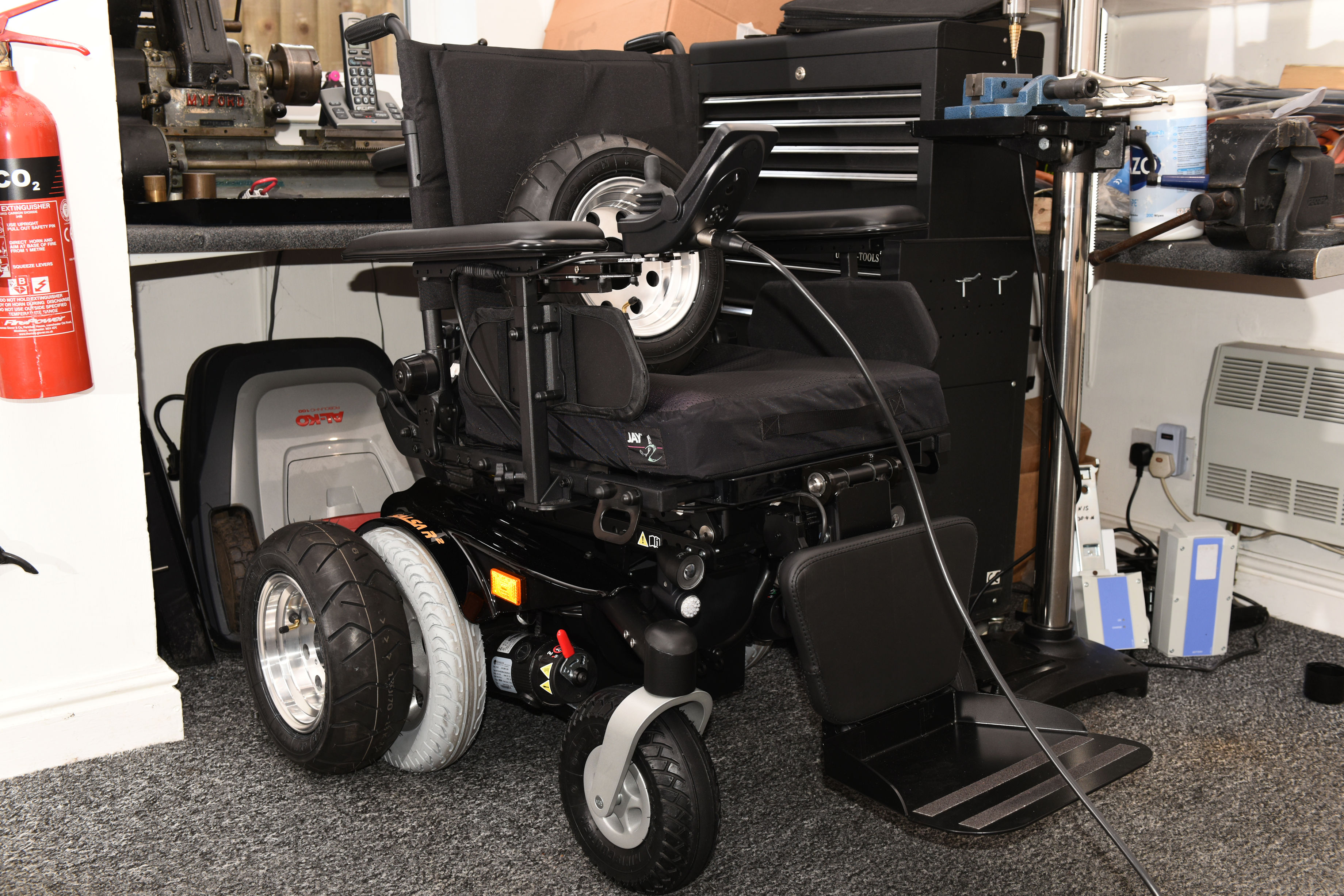

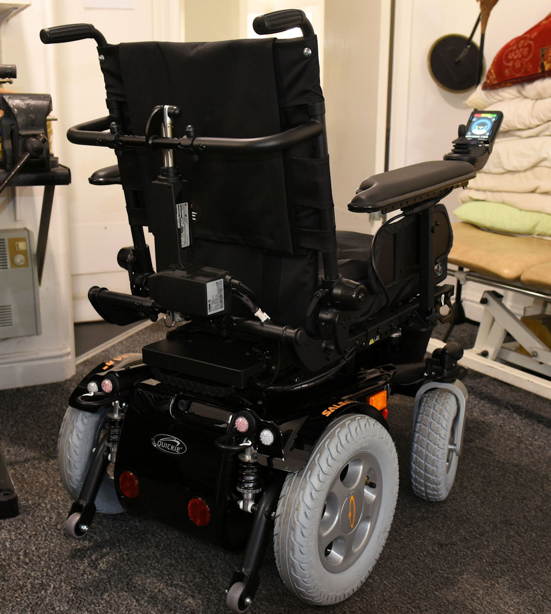

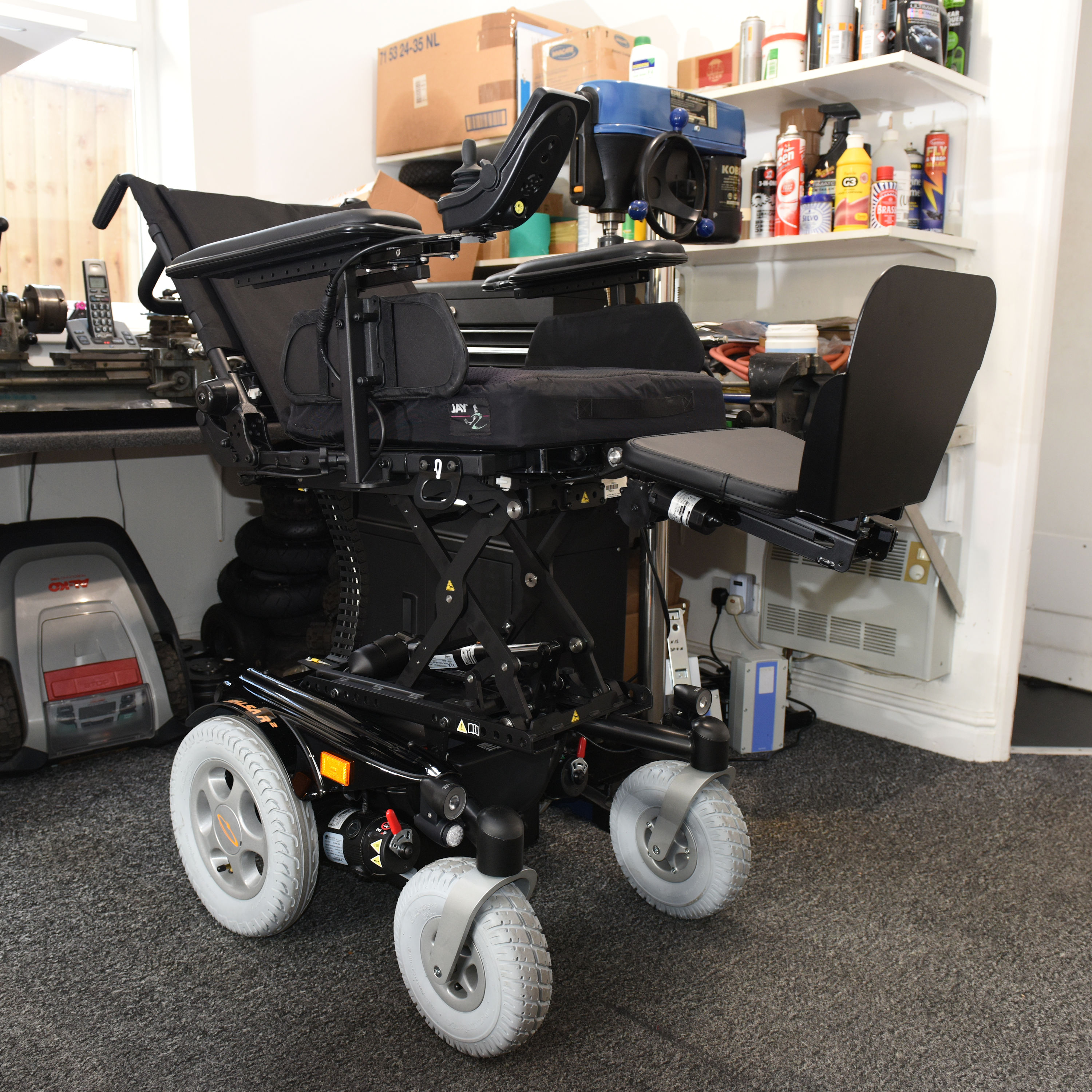

Postby Burgerman » 24 Jan 2018, 20:40
Bad pics by my carer... Grey tyres. Old 5 inch thick home made foam cushion thats all distorted... And too dark to see much.

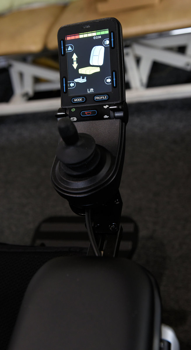

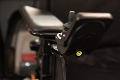

Postby Burgerman » 25 Jan 2018, 19:22
Quickie and permobil have a new one. Its also useless.
Note the wobbly ARM that its attached to. In what world do they think that this is acceptable? That wobble alone means no proper control. Then the swingaway... It wobbles around loosely too!
Its imprecise and its worse, it has detents at 45 180 and -45 which are all in the Wrong places. And it is way too low! When retracted inwards, it STILL sticks out on the outside while they demonstrate a doorway! Idiots. Completely clueless.
It needs to be MUCH more solid, not wobble, be 2 inches higher, and have a detent at 15 degrees inboard where your hand falls naturally. And be shorter.
Seems that I have to make one myself, after 24 hours searching every manufactuterers useless efforts!

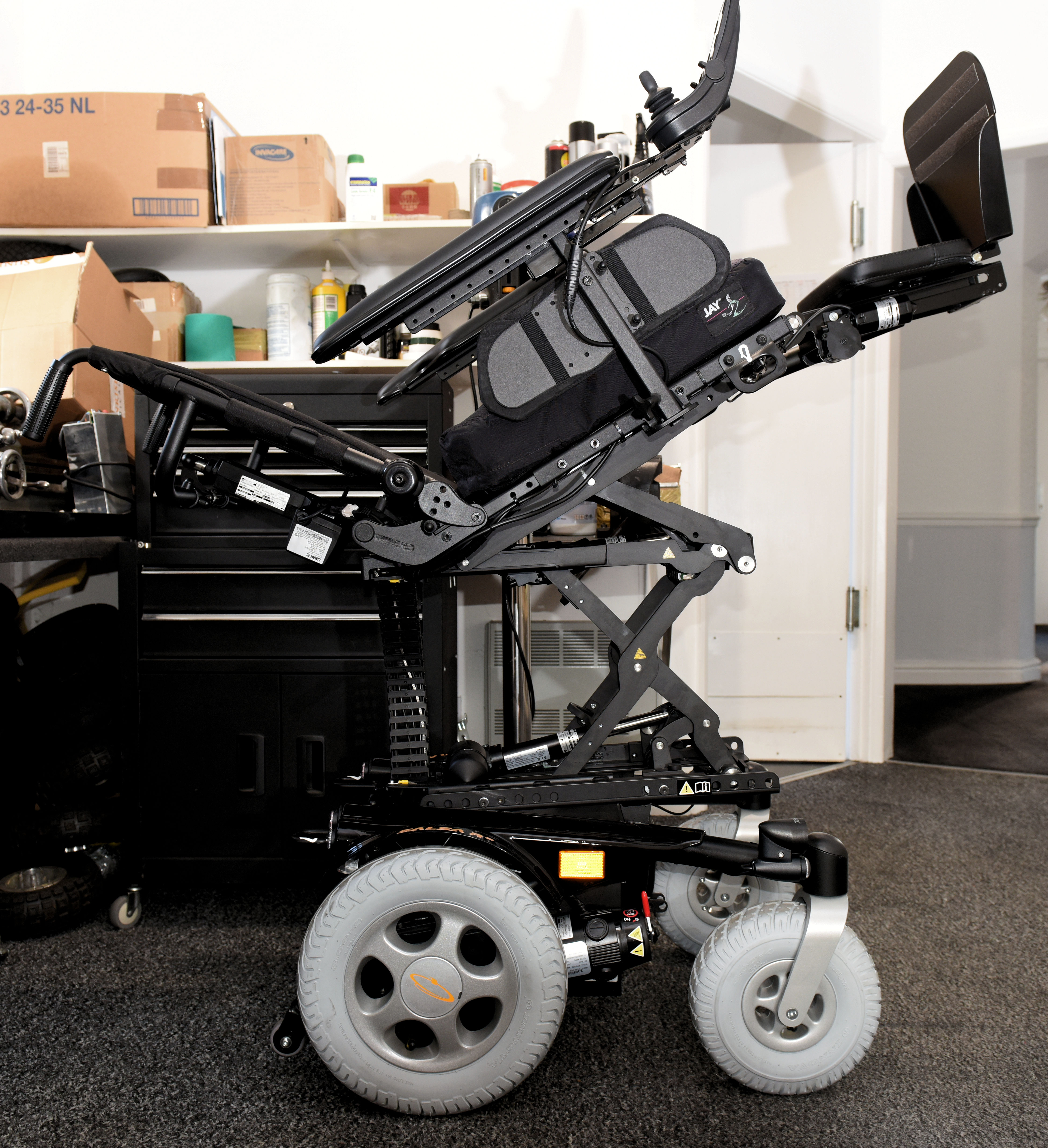

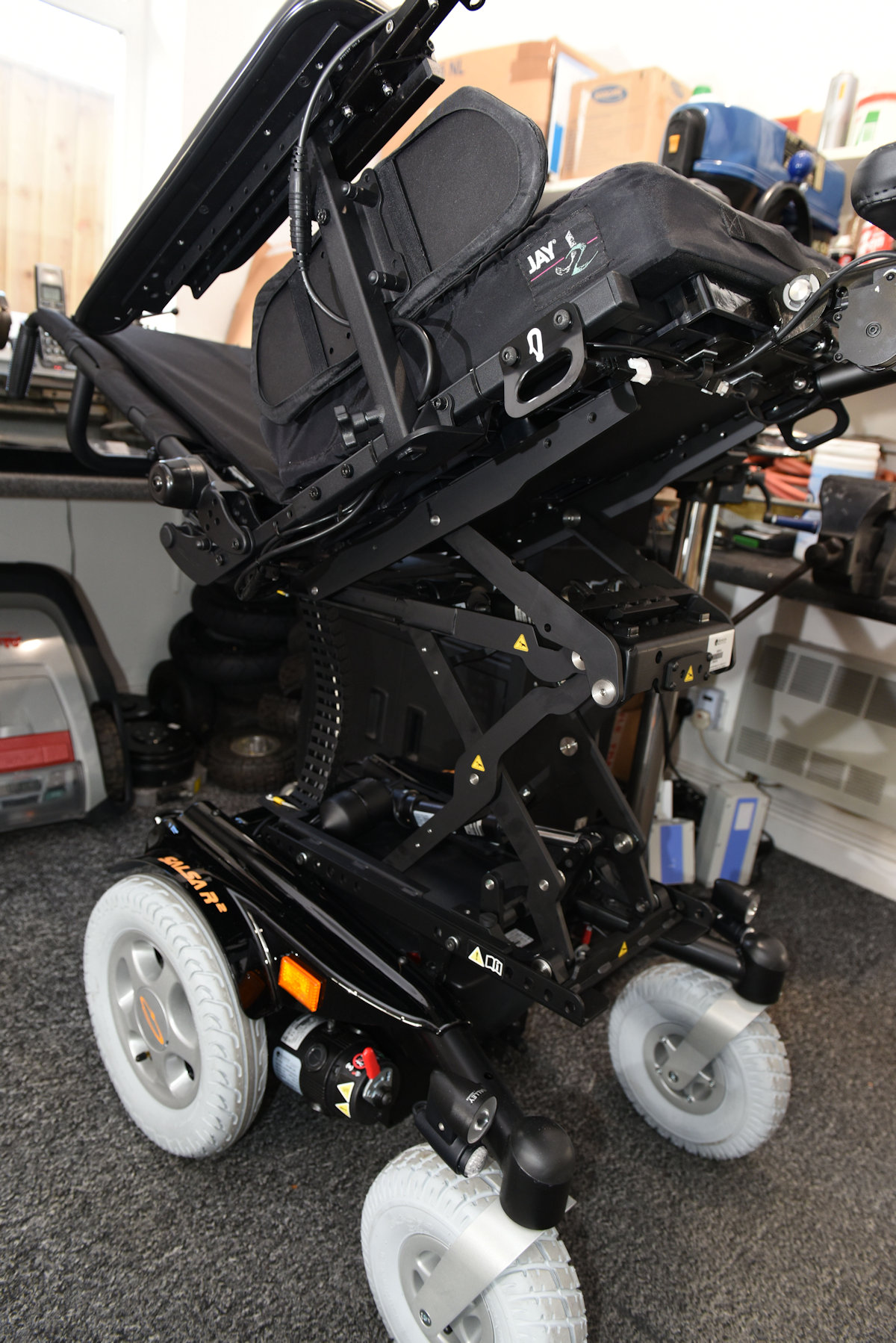

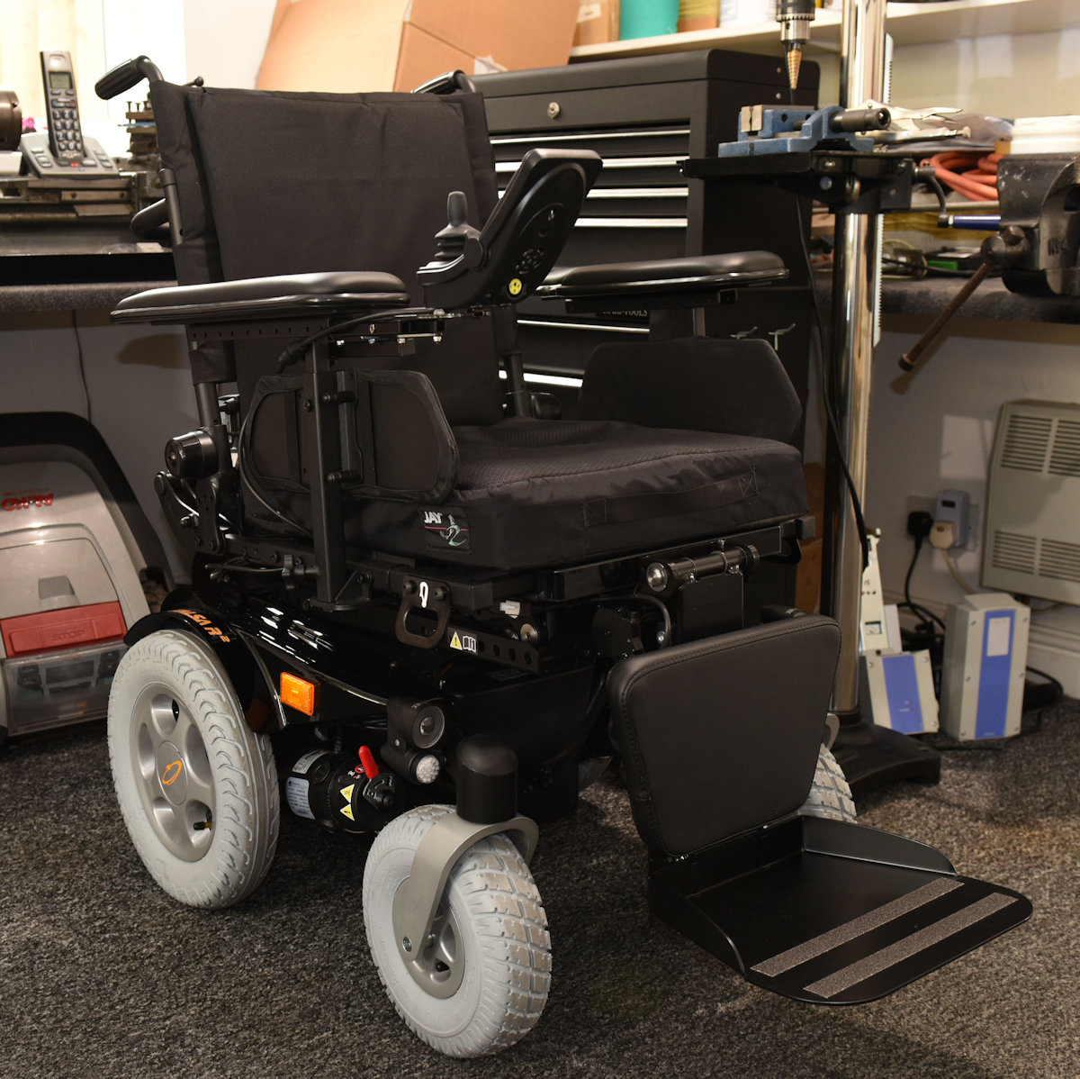

Postby Burgerman » 29 Jan 2018, 16:38
Some partly reconfigured pics!

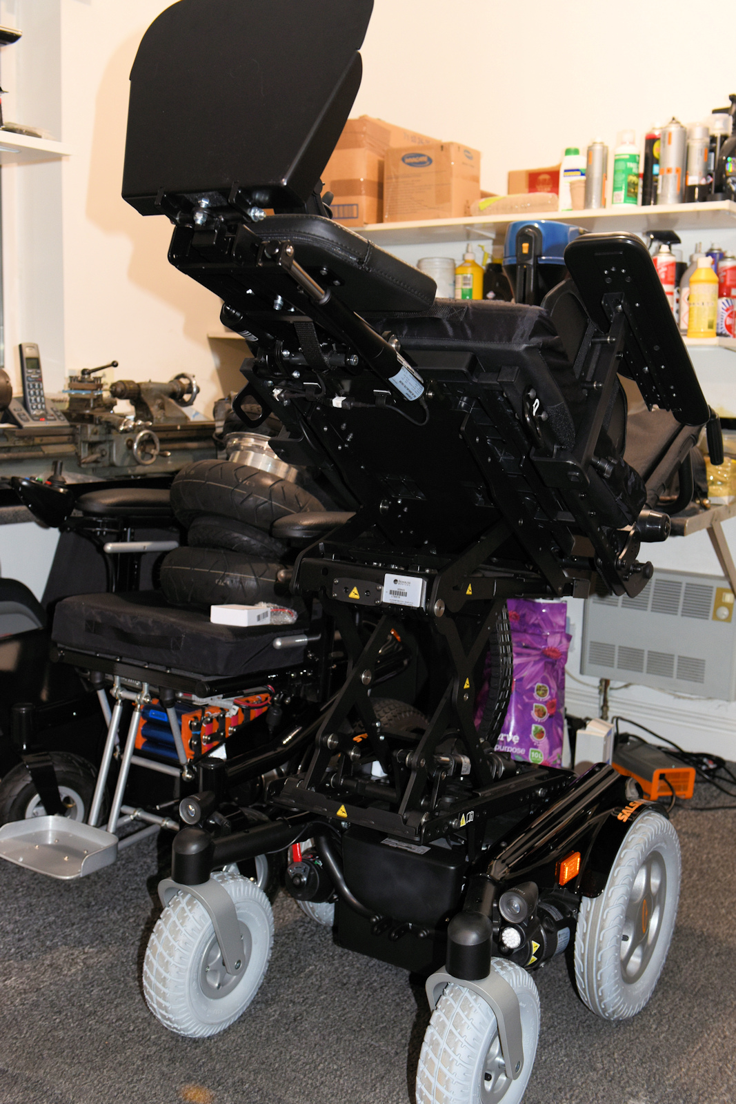

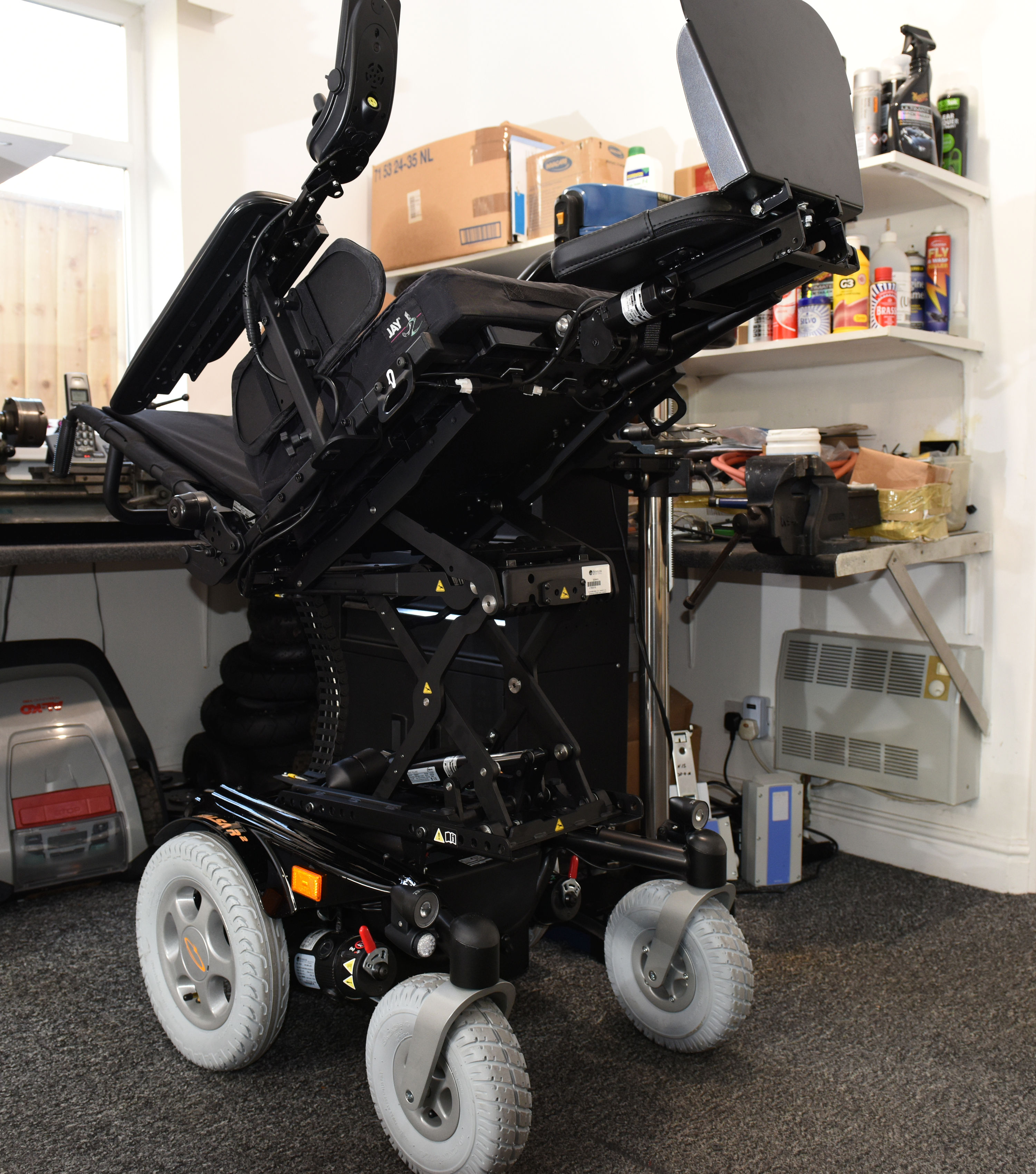

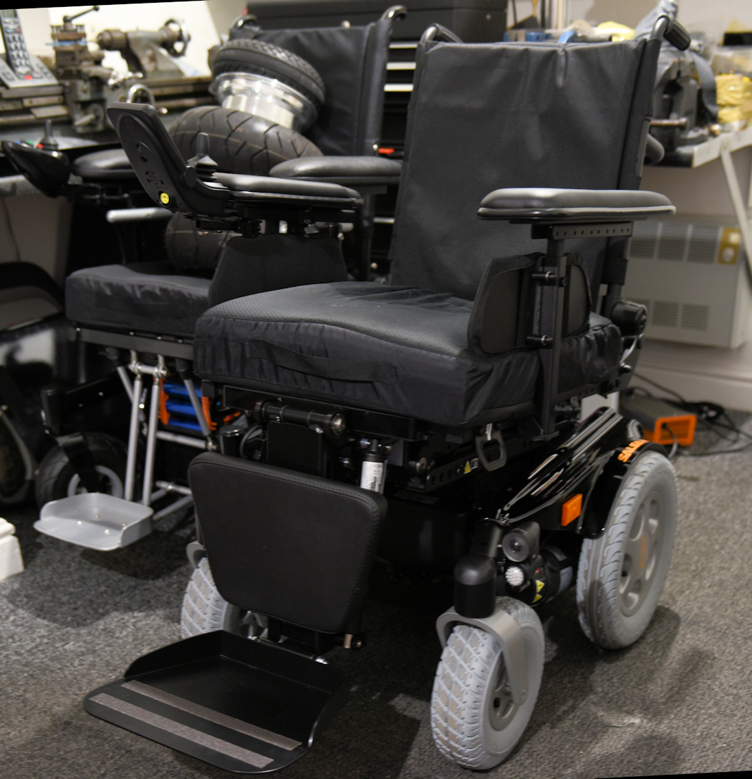

Posts: 70441

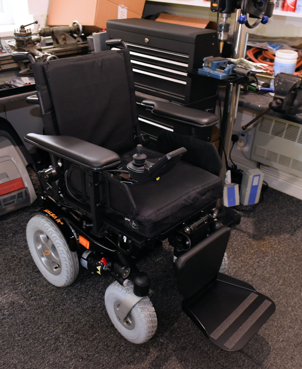

Postby Burgerman » 29 Jan 2018, 16:49
More...
Posts: 70441
Postby Burgerman » 29 Jan 2018, 16:51
Posts: 70441
Postby Burgerman » 29 Jan 2018, 16:52
Posts: 70441
Postby Burgerman » 29 Jan 2018, 16:54
Still Needs wiring tidying up,cable ties etc.
And a jay3 tall, back, and headrest, (on its way)
And the tubeless rims and black tyres fitting...
And a lithium pack...
And a careful programming session.
Posts: 70441

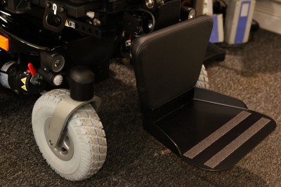

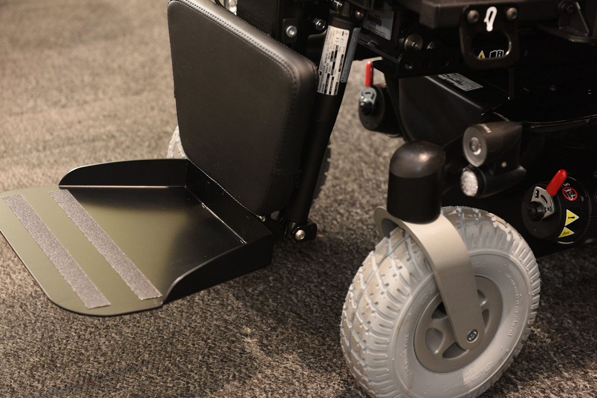

Postby Burgerman » 30 Jan 2018, 13:44
Everyone will tell you that rear drive chairs are worse indoors. And thats true of every powerchair where the seat must be mounted too far forwards. So that the normal swing away footrests are able to clear the casters. They must be stuck ahead of the chair and in front of the caster wheels.
Note actuator/bolt. download/file.php?id=7609&mode=view
The other side is no problem. download/file.php?id=7610&mode=view
This pic shows (rather badly) that the footplate actuator end attaches to the side of the footplate, just behind the plate itself. Because it was designed by an idiot. So if/when you move the seat back, this bolt is the first thing that is in the way and it hits the caster tyre preventing you from doing so. This bolt/actuator is the reason you dont see centre footplates normally fitted or mentioned on sunrise's rear drive chairs. But I am going to move the bolt, the mounting, along with the actuator itself slightly. By just half an inch and make it shorter by a further half inch by moving it slightly inboard... As the manufacturer should have done! And that allows the clearance needed for the 10 inch casters. If I fit 9, or 8 inch casters I can move the seat back another inch or so. Which will also happen eventually. I may also cut off the rear corners from the over-wide footplate too. Allowing another inch...

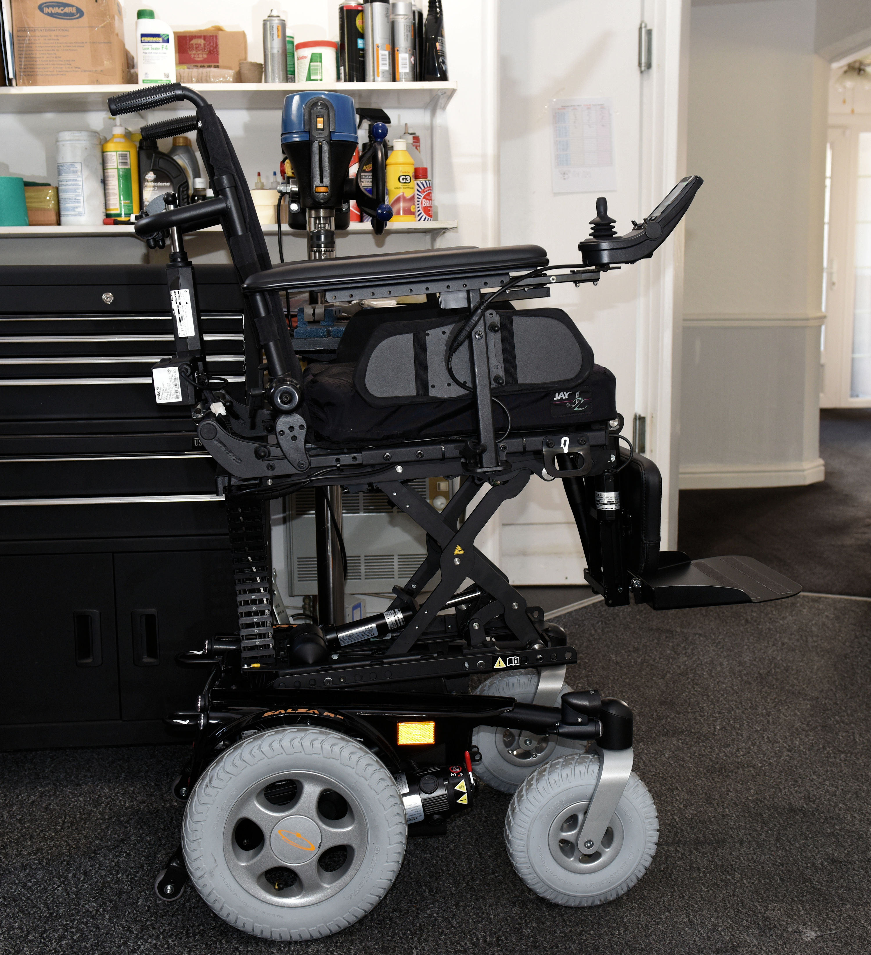

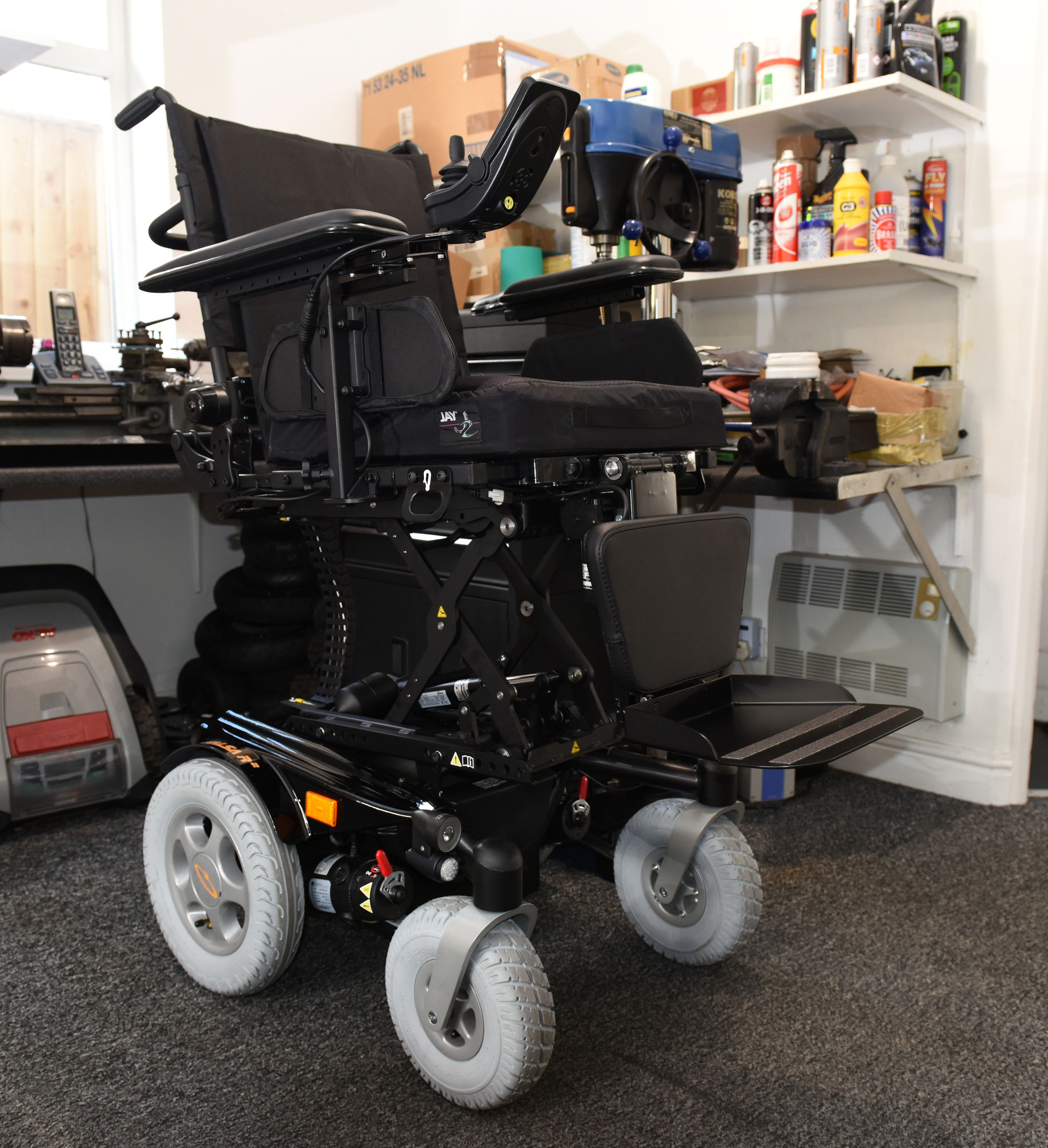

Postby Burgerman » 02 Feb 2018, 10:10
- Offending footplate actuator bottom mount now modified and no longer an issue. Gained a full inch of tyre/footplate space. Neeeded a hacksaw and rose joint!
- Black and slightly smaller front tyres fitted also improving footplate clearance by another half inch.
- Cables all titied up.
- Frint lights relocated to a position where they wont be destroyed.
- removed dozens of bone dry shafts on footplate, bolts etc and front wheel axles/bolts that were never greased on assembly. Greased and reassembled.
Previously
- Seat dump angle changed by drilling 2 x 8mm holes and adjusting angle.
- Seat moved back 2 inches on rails.
- Arms, swing away redesigned/reconfigured to put controller in the right place, and width adjusted.
- Seat depth djusted and seat recline increased 5 degrees.
- reprogrammed. And disabled many speed restrictions and inhibits in programming. Increased many speed limits for turtle mode. Renamed many functions on the lift, tilt, recline, foot functions etc.
And this chair is looking good. All fixes essential but pretty minor. Probably the best or only candidate as an over the counter decent rear drive powerchair on the market. Other than tom kilmore? Albeit with a few minor fixes and maybe 4 hours fine tuning work. 9 out of 10!
Just the rear wheels and adapters to go.
Posts: 70441

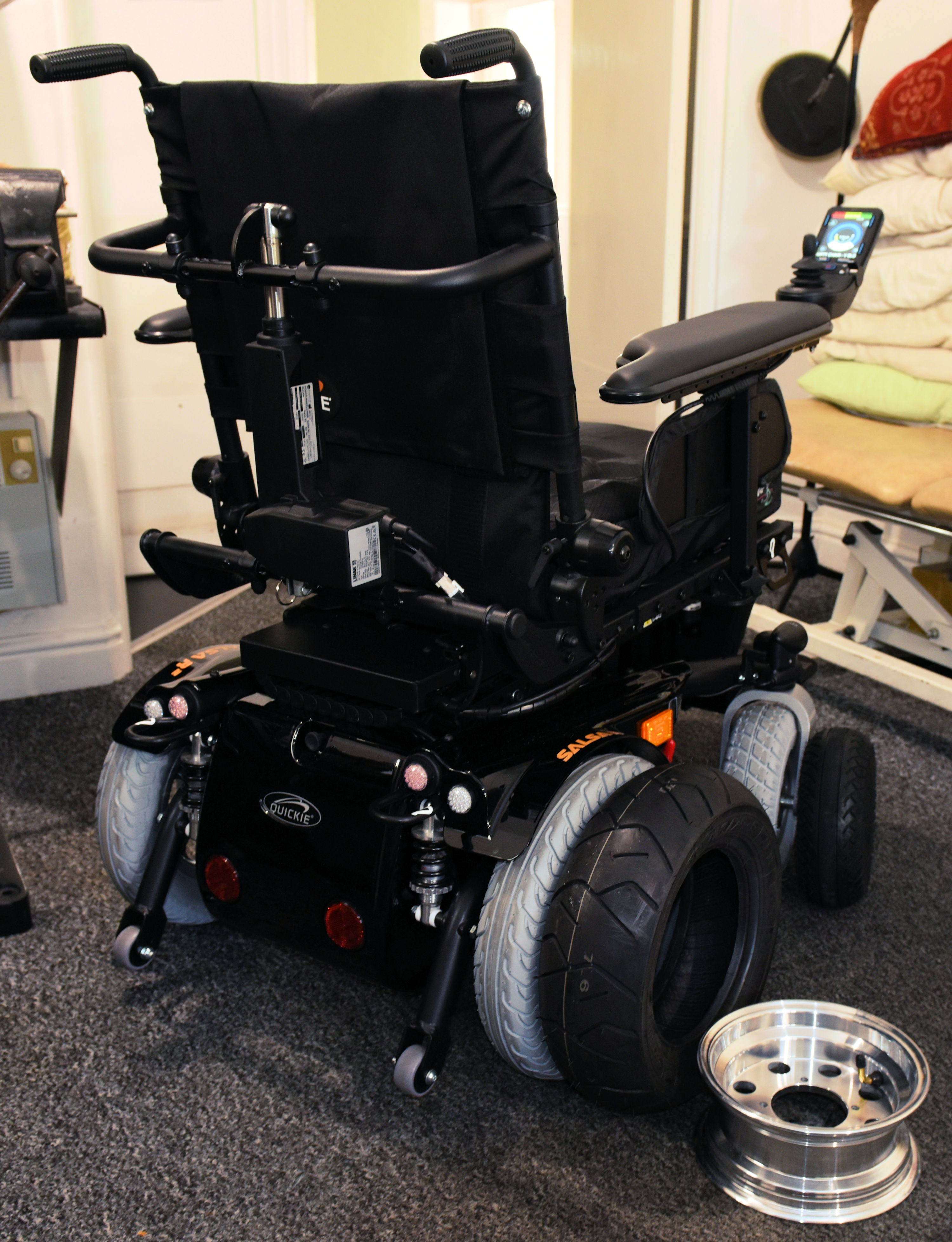

Postby Burgerman » 02 Feb 2018, 14:25
Tyre son caster wheels.
Rear tyres fitted to rims
Lights moved...
Just need to make adaptersto fit the tubeless rear wheels to the chair. The stock tyres are about 10mm from the motors. So as far as I know I can use up some of that! So the 120mm wide new rears will not stick out as far as I thought.
