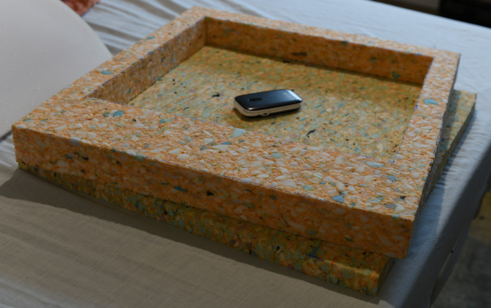

Postby Burgerman » 30 Jul 2018, 15:15
My foam is ordered.
3 parts.
1 hard reconstituted foam base, (made from lots of bits glued together) 500L x 480W x 50mm deep with a large rectangular hole for the air parts. see download/file.php?id=8797&mode=view
1 hard reconstituted foam, 500L x 480W x 50mm deep with a large rectangular hole for the air parts at the rear as per drawing.
1 soft foam part 1/2 inch (12mm) that goes on the top, covers the air cells, and wraps over the front. It is 480W X 585L.
All will be glued together with simple spray carpet glue. And a 20 x 18 Jay2 cover.

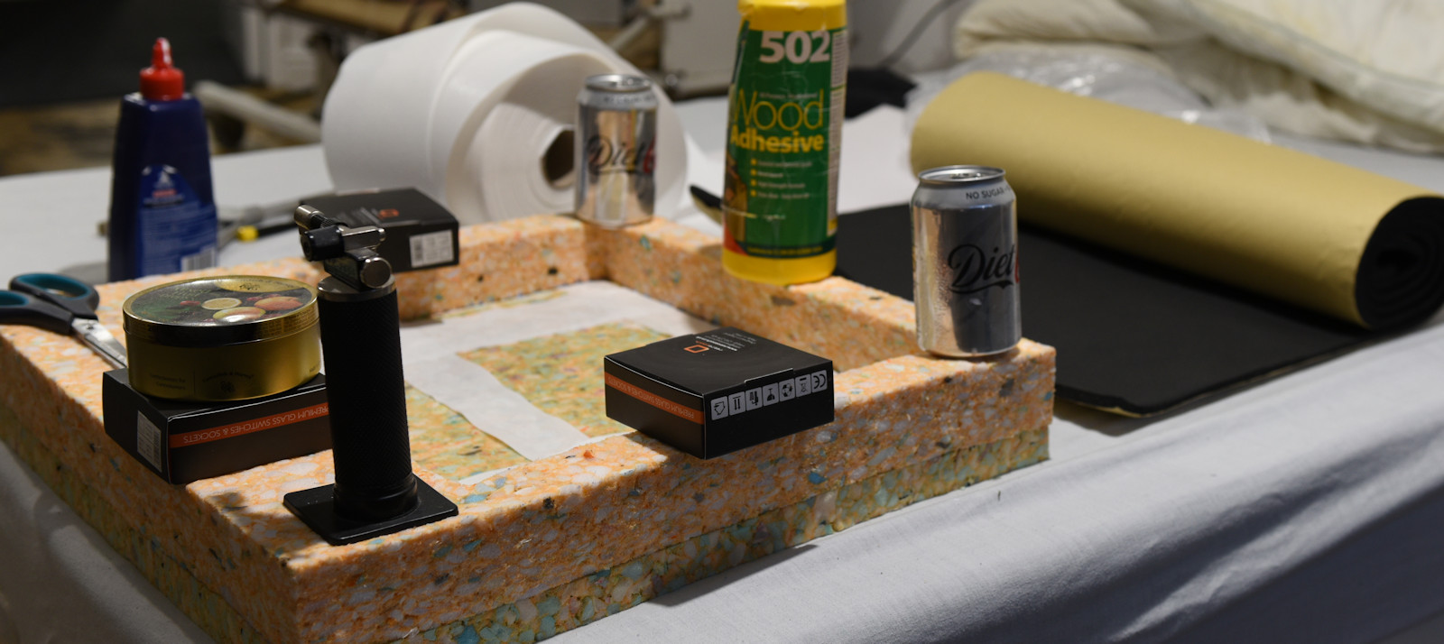

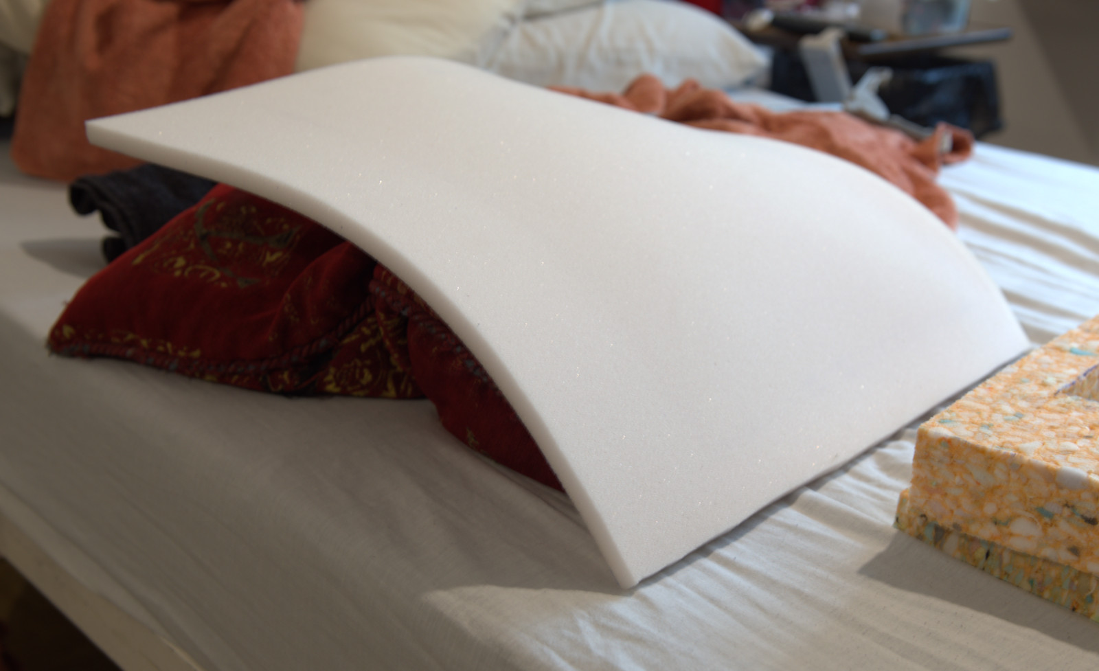

Postby Burgerman » 02 Aug 2018, 19:44
OK.
To make a custom air cushion that is your own size, with firm sides and edges, and firm front, you just need some carpet glue spray. And order 3 bits of foam cut to your size. No skill required.
3 parts.
Two here, these are 1 inch thich bottom, and 2 inch thick with the hole already cut in the top. You just glue these together to foirm a 3 inch thick hard cushion, and then drop the 6 air cell part from the cushion I bought into the hole! The hole is the exact right size.
And a soft foam top. This sits above the cushion, and is glued on. But its wrapped into the edges of the hole to give a smooth rounded edge on the sides and the front and back. Total cushion is 3.5 deep. With a hard supportinve foam base and a thin soft foam top. No cutting required.
Top, to be glued on, and glued into the hole. Then put into your favorite cover. I will use my Jay2 cover.

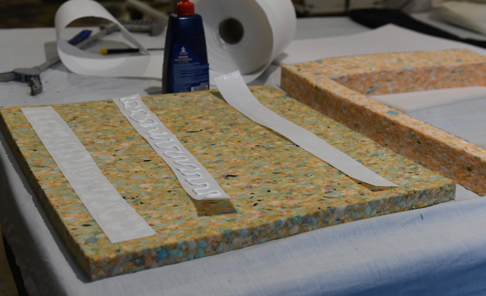

One small thing. Its important to add a layer of fabric. Between the two heavy foam layers. Because otherwise the susion "spreads" and hains about half an inch in use ofer a few months. Cut two bits from an old sheet, the same size as your cushion. One on the bottom. One between the two heavy layers. This can be glued with any contact adhesive or PVA diluted etc..
Posts: 69646
Re: Active alternating air cushions???
Postby Burgerman » 03 Aug 2018, 21:25
Scrap the white top.
This black foam on the right is softer, and allows better airflow, and its self adhesive saving me a job! Its a bit like memory foam. It will form a little shape, where I double it up. And the top layer.
The orange foam is hard. The yellow bottom layer is very hard as foam goes.
Assembled here with PVA and I am using a professional jig/rig to hold it together firmly while glue dries. The white bits are white scrim, as it does not stretch. So the cusion cant spread with a lot of use. Keeps it 19 wide, 20 deep.
Frankly any idiot can make a wheelchair cushion. You can build one that suits you. or is shaped to suit you. With the firmness where you need it, or with a place for a gel, or air, or in my case the cyclic air cells.
All the foams are available cut to your dimensions cheap on eBay.
