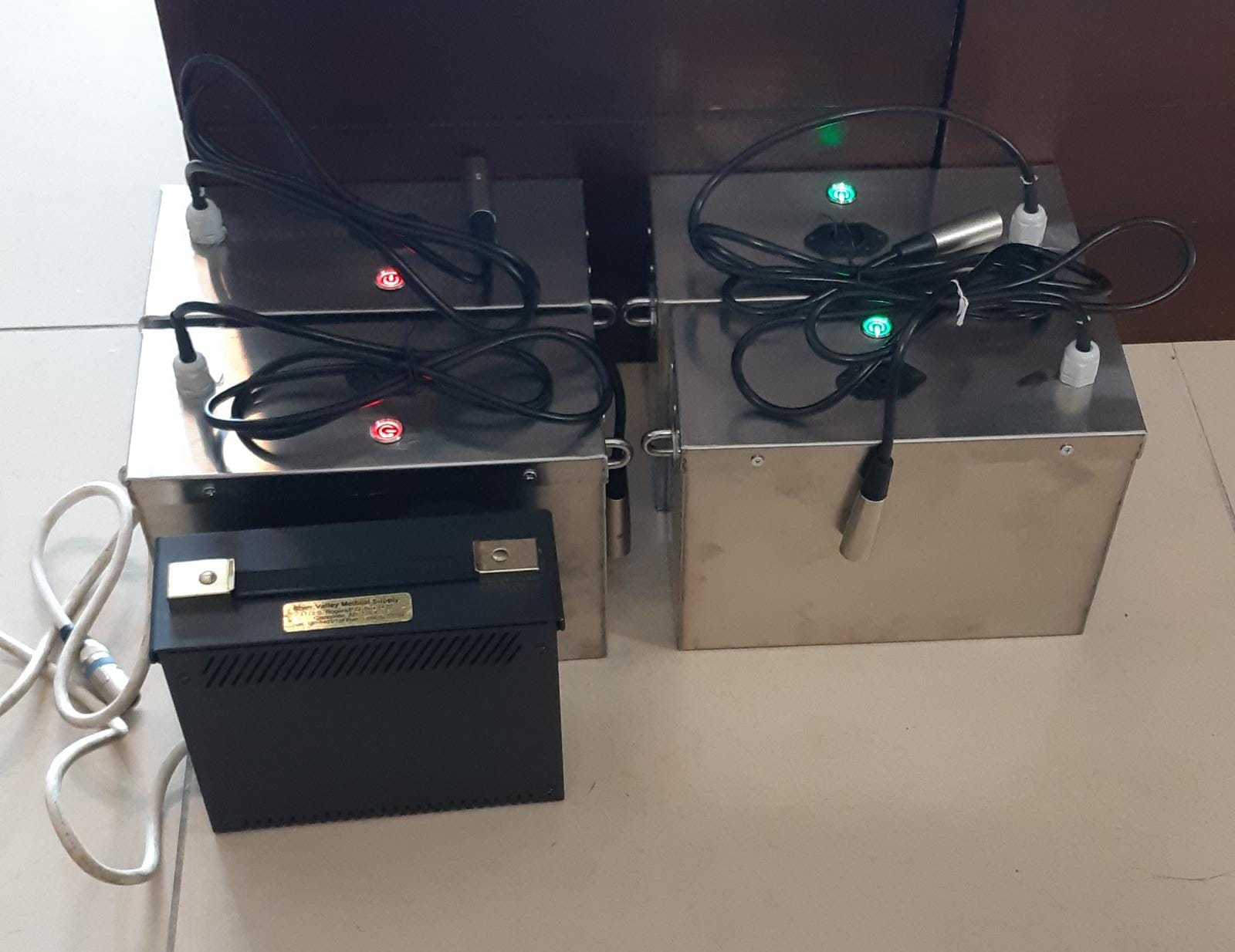

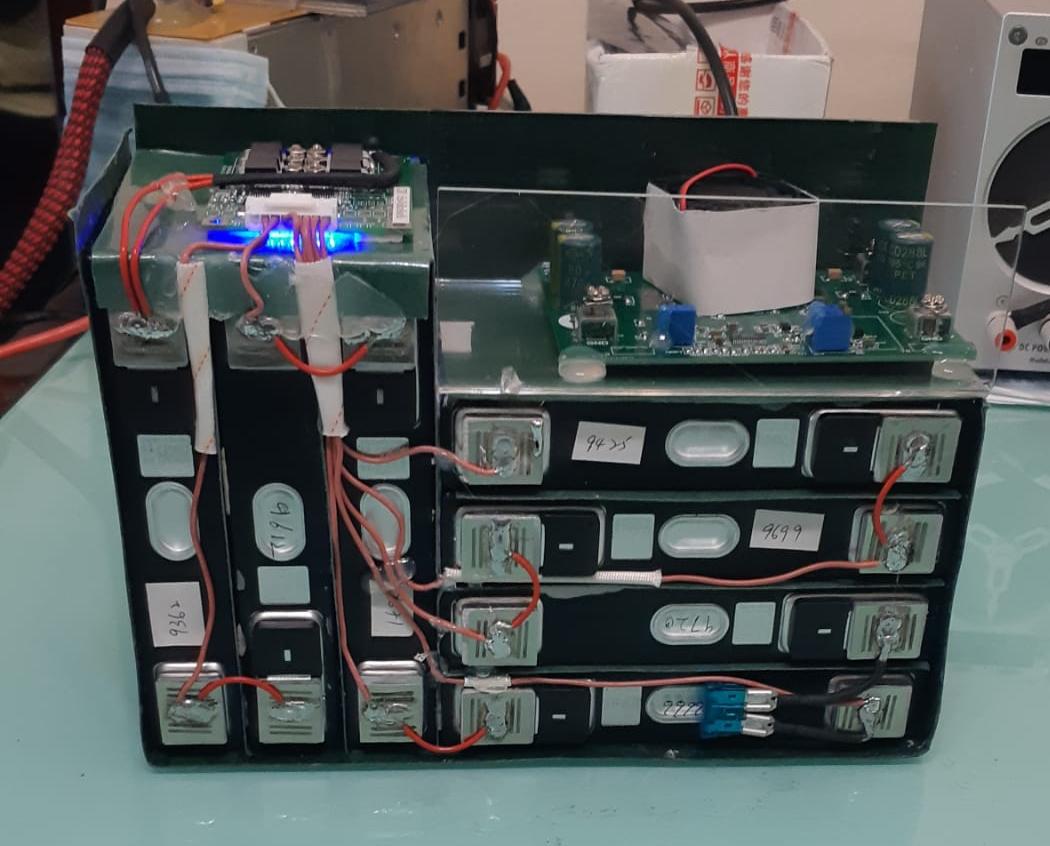

Postby shirley_hkg » 25 Dec 2021, 04:25
I've made 10 of these compact powerbanks for wheelchairs.
24V50A, hup on hop off anytime , any chair .
Posts: 4656

Postby shirley_hkg » 01 Feb 2024, 04:57
They are popular and need more units to meet the demand. I want to make 5 sets this time, with 21700 cells(6P7S), going after slim outfit.
Gonna pick a cutoff voltage.What will be the difference in DOD with 3.3V and 3.6V respectively ?
Burgerman wrote:Discharge to lowest 3.6V (3.7V for safety which will be about a weeks use earlier)
Posts: 4656
Postby Burgerman » 01 Feb 2024, 09:38
Lifespan (unknown but very significant) and around 10% range.
Posts: 71096
Postby shirley_hkg » 09 May 2024, 11:09
Burgerman wrote:Or you can use say 8S and 4p 21700 cells and build a physically small firework 20Ah 35V battery in a small bag carried on the chair push handles. And use this, to give say constant 27V and 3 to 5A limited CC/CV charge via XLR all day long. So adding 50% or 60% to the range. https://www.ebay.co.uk/itm/226087828265
Been planning to build one to lend out myself for years. Never get around to it!
It would extend the lifespan of lead by a long time, maybe double or better if set as suggested above.
4 or 5 Amps isnt enough for continuous rolling. But it would still more or less keep up as it catches up when you stop for a few mins or eat etc.
Remember that 4A charge is 20Ah restored every 5 hours. About the rate most people use up the battery. So low DoD average.
Thank your advice.
Sticking to 24V is to cater for recharging with stock charger of one's own.
A buck-boost inverter is used. It has small footprint of 80*55*20(mm), 5-48V/0-20A
Posts: 4656

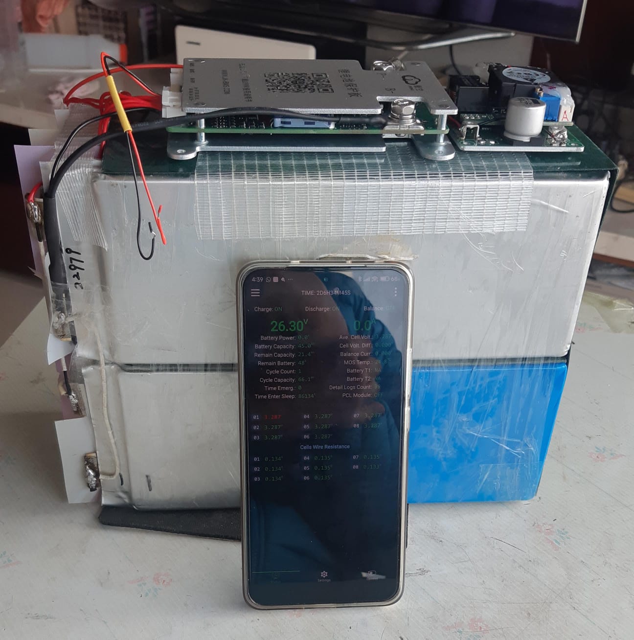

Postby shirley_hkg » 23 Jan 2025, 09:53
Found some obsolete LFE pouch cells in garage. Converting it to another 45Ah power bank for wheelchair. cheers
