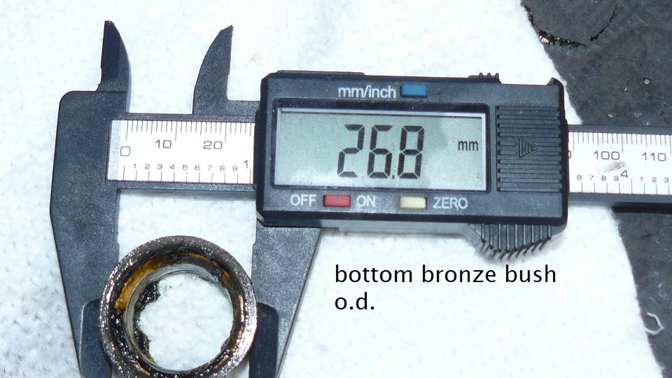

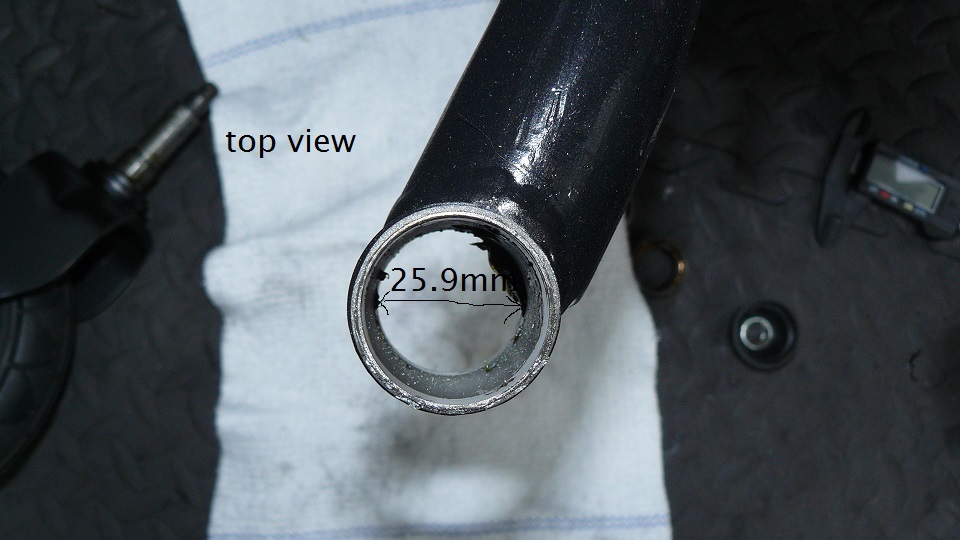

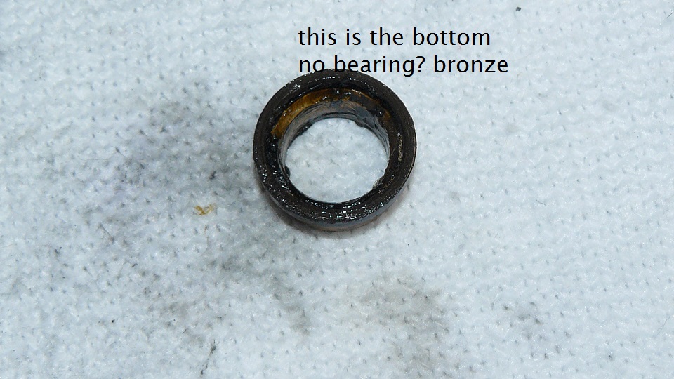

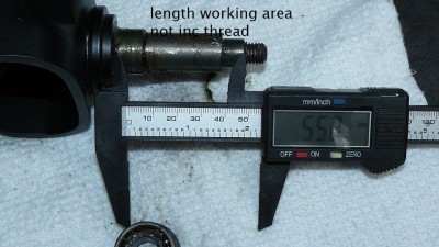

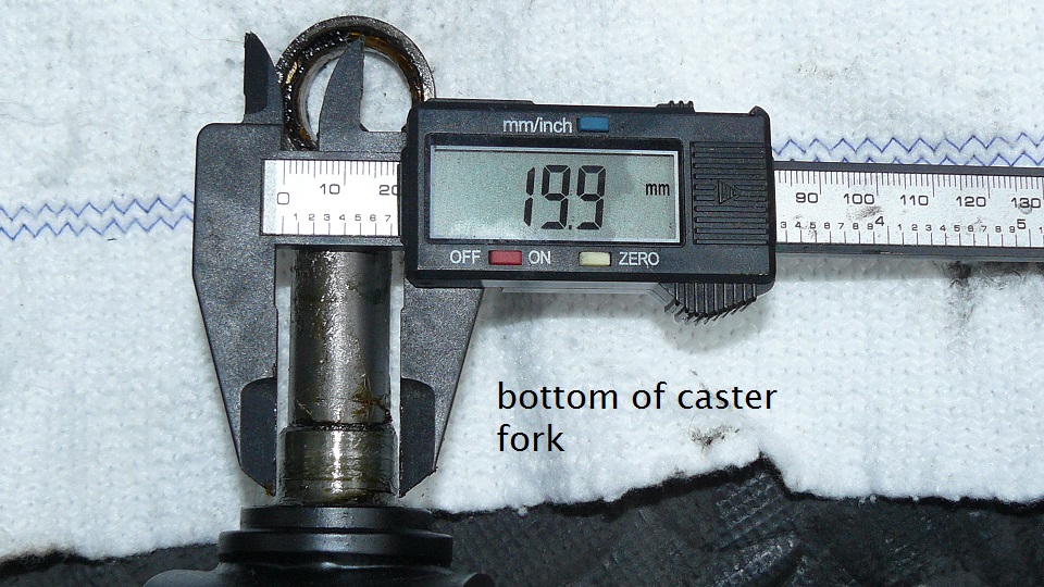

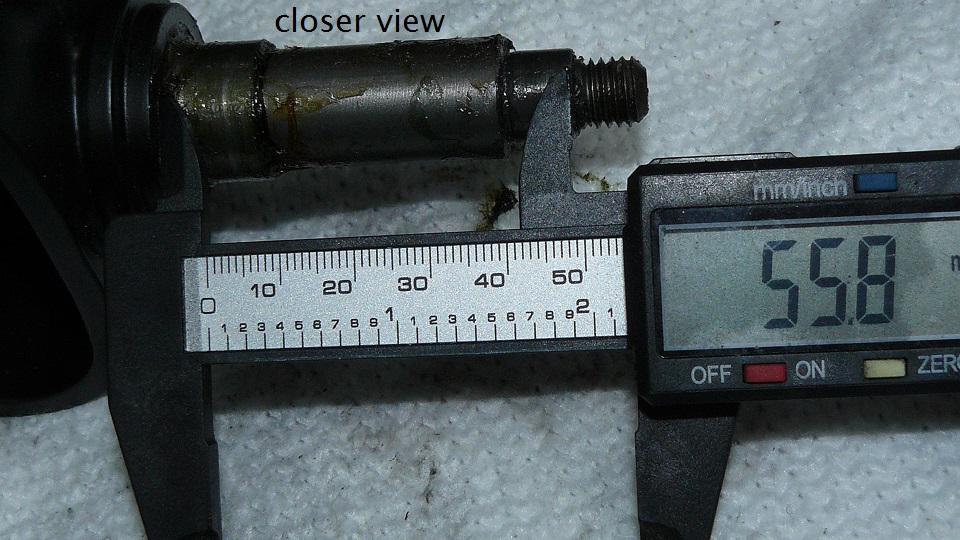

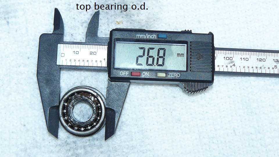

hi right i took them apart and this is what i found i have measured as careful as can be the verniers are not the best but close as i can muster,
more to follow,

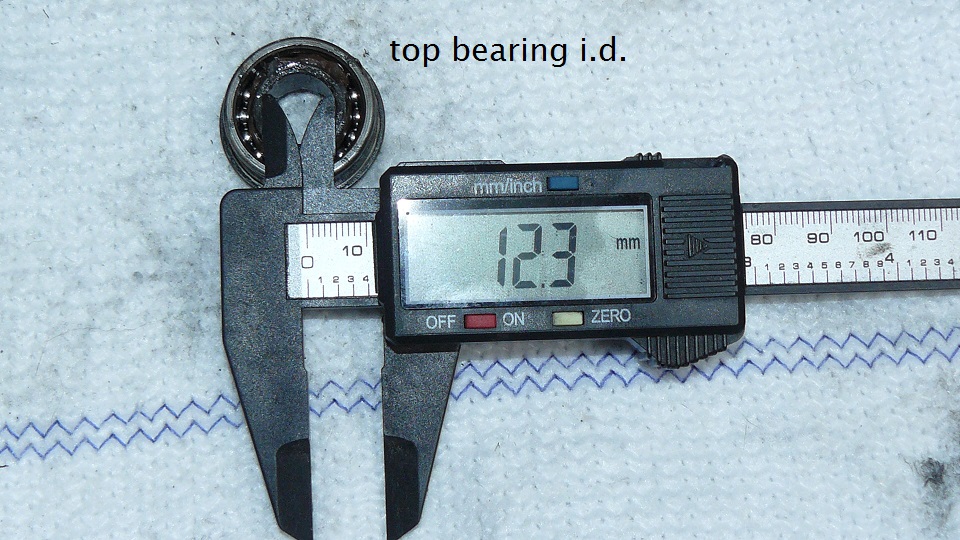

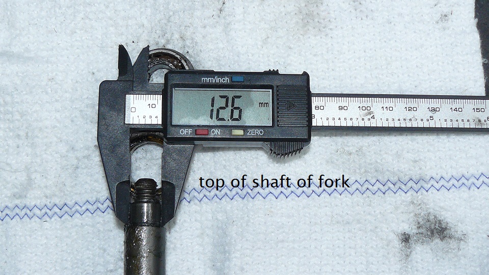

Postby duke1 » 30 Sep 2019, 13:56
rest
idk whats going on the pics are now not upload says your end is not working wtf!!!!!!
anyhow i keep trying banghead
like i said there is only a bearing in the top and a bronze bush in bottom end is that normal?seems a bit mickey to me if it is though this is no surprise having seen the laughable build quality of the donor meyra chair,yuck!!!!!right try again upload rest,thanks for your help again,i love your little site. :clap:
cheers more to follow,this 3 pic limit is a bind! banghead

Postby woodygb » 30 Sep 2019, 13:57
Wipe the grease off and look at the numbers etched into the edge of the outer race.
E.G. 27 16 14 = O.D. I.D. Width

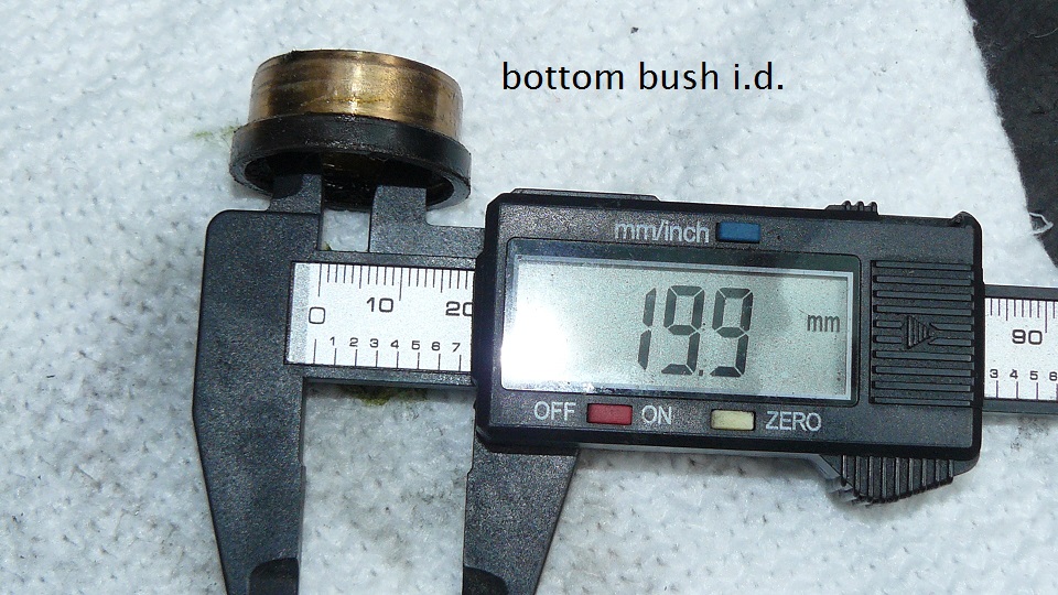

Postby duke1 » 30 Sep 2019, 13:58
more,ends soon honest!

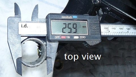

Postby duke1 » 30 Sep 2019, 14:08
wont let me post this is last try
feck me i think i done it!thanks for any help :worship

Re: polishing the turd!
Postby woodygb » 30 Sep 2019, 18:49
Your bearing appears to be 26mm o.d. 12mm bore ...width ?
https://www.google.com/search?q=26+mm+o ... e&ie=UTF-8
Next time you use the caliper make it touch the metal.
